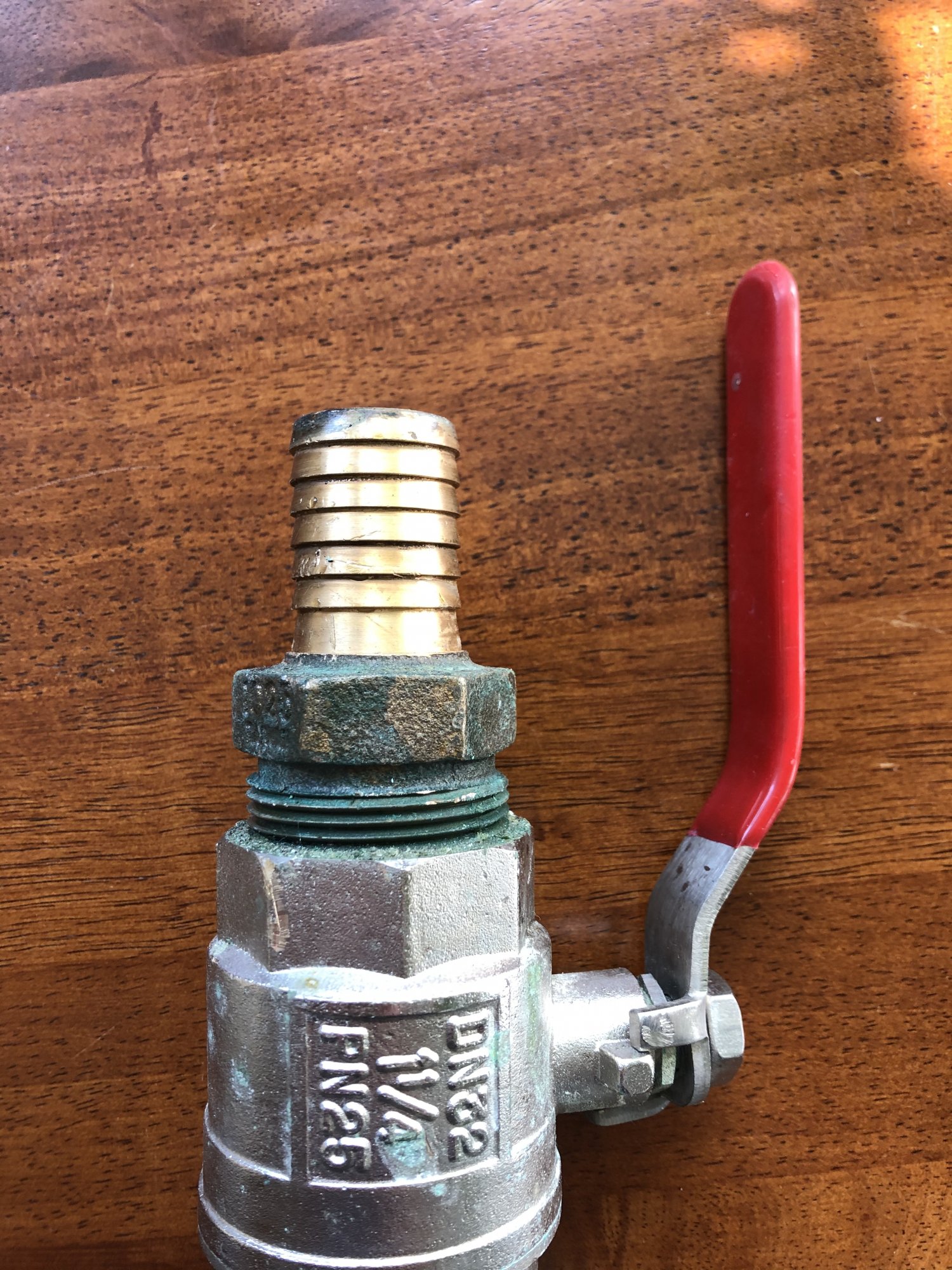

Hello all.....
So starting projects and have a need to consult experts. Have a thru hull valve with a male screw-in and barbed othe end. Currently straight. Would love to remove straight fitting and put a 90 degree fitting in its place. 15 years....... best way to remove without harming valve. most times I would just cut it out and replace new (and I still may). A bit of soaking? Heat? What works best for you.....
Thanks
Greg

If it won't budge with some PB Blaster or WD 40, then heat.
It may be easier to put it in a vise than trying to use 2 wrenches.

Use two wrenches of the correct size instead of adjustable wrenches. Stand on one and use your foot on the other. With the bronze and SS, it shouldn't be too hard to get them apart. Do not heat, that valve may have plastic inside. I can't tell from pic, but that is not a proper seacock, just a valve, possibly from a hardware store. If that was mine, and below the waterline, I'd change it out for a marine thruhull and seacock.

Ball valves, properly designed for boats are OK. If I recall correctly, valve issues are common with Beneteau.

It’s a beneteau ball value..... they are a bronze alloy. Europe stuff. Skin fittings are bronze but they cheaped-out.
figure I’ll soak a bit and yes two wrenches and a foot!

The one that I want to remove is still on a valve in place on boat..... the picture is one that I removed and am glassing over the hole.

Ouch ! ! ! ! The body appears to be SS and the hose/MIP thread adapter is cast bronze (sand casting marks showing). No obvious signs of any type of sealant/release on the outlet side. That is NOT going to be fun to remove given the 1-1/4" diameter.
If it's still in the water, try penetrant first. No go, try very quickly heating the valve skin to about 200 deg. and then go at it. The teflon ball will. be fine as soldered ball valves go much hotter that that. Whatever you do, ensure your first wrench and backup wrenches and are balanced when you do this. Use a couple of snipes.
No feet and no fooling around if you are still in the water and the going gets tough. Arm strength only. One slip and an 1-1/4" hole where the inlet pipe was, would be a sight you'd never forget :yikes:.

Boat is on the hard..... want no torque to valve and below to skin fitting. Valve is not stainless..... it’s a duplex brass used by beneteau for years.
Things are looking up. No galvanic corrosion there. It's gong to be a bugger due to its size so soak with penetrant for a week or so and then hit the torch and wrenches.
Use a fine tip torch oxy/acet. if available. You want to heat the valve (only the part over the thread) as fast as possible so it expands thermally but the internal pipe doesn't have a chance to get hot, stays cool and doesn't expand. Give it hell as fast as you can. Good to have a torch man (not the arsonist type :yikes:) and a wrench man on this together. Speed is of the utmost.
