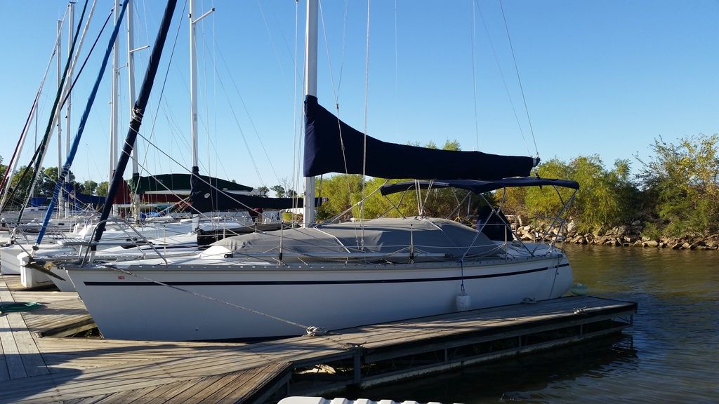

We have this great (big) bimini that the POs made. It's 9' long! I'd like to preserve it from the elements but the way the supports are constructed, it is always in a fixed open position. I think with the help of some quick release pins on the fore and aft stanchions I could collapse the bimini fore and aft to the split backstay. My concern is the strataglass window behind the backstays to the rear bow. If I collapse the bimini the 'glass would be folded in half. Will this damage the window? I've been told to keep it flat.
Worse case I guess, I could have a cover made that would cover the major collapsed area in front of the backstays and also cover the 'open' section aft with the window. It would look funky but would spare the canvas.
It would be a huge drag to sail this way so we'd open it every time we sailed. Not ideal but do-able. ANyone familiar with the care and feeding of strataglass?

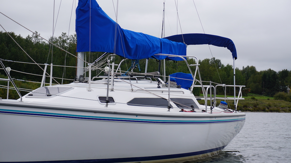

I used the Gemini collapsible struts on the dodger and the thumbscrews to attach the retainers on the dodger and the bimini, so they could be folded up easily. There will be no more webbing straps. :) Here it is folded up.
(and the newly installed frame for the dodger, clearly indicating how the sailcover needs shortened, as Sunbrella has no abrasion resistance, this isn't gonna work :) )
