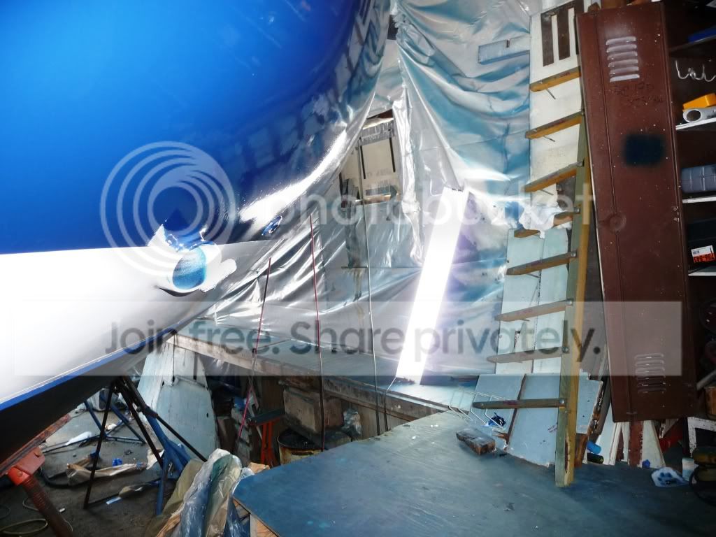

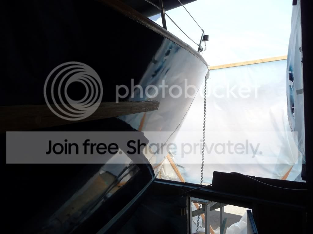

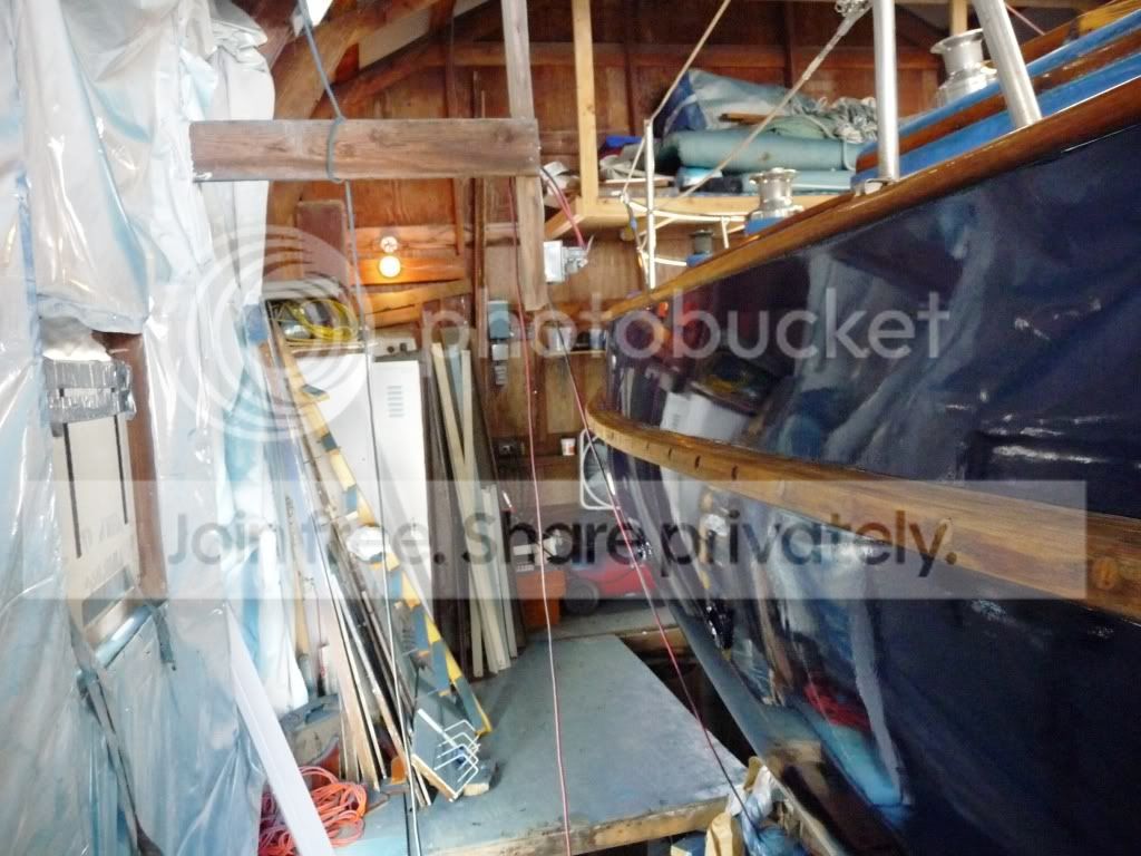

Some side shots

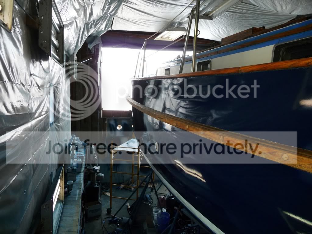

The bow looking out the door.
