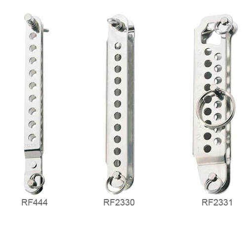

Is this what you have on your stays?
It is not uncommon for smaller sailboats to use these types of connectors .... and it leave a little play in the tension.

Hi, thanks for response.
There is currently nothing at the lower end of the shrouds or stays, just a thimble/Eyelet spliced into the wire rope.
I was looking at those "Adjusters", especially maybe for the stern so it could be adjusted once mast is raised.
West marine is pretty damn proud of them and I can't find them anywhere else ?.?
Anybody ever DIY them (Shrouds only) with pre-drilled stainless flat stock 3 or 4" long, clevis pinned top and bottom?
I can get that at hardware store for a few bucks to continue moving forward a few outings until I know what I really want.
Or, if I could also just get by with something like this on the Port/Starboard shrouds?
I would use turnbuckles but then I would need to shorten or replace shrouds and stays, as it would introduce too much slack currently.
I'm willing to do that once I have splashed her a few times and everything else has been proven workable to me. Just bought it last month and am anxious to get her in the water once. (Hull painted was first step).
Then I will improve on her once she graduates from Project to Work-In-Progress...
(I do know THAT stage Never-Ends! lol)
