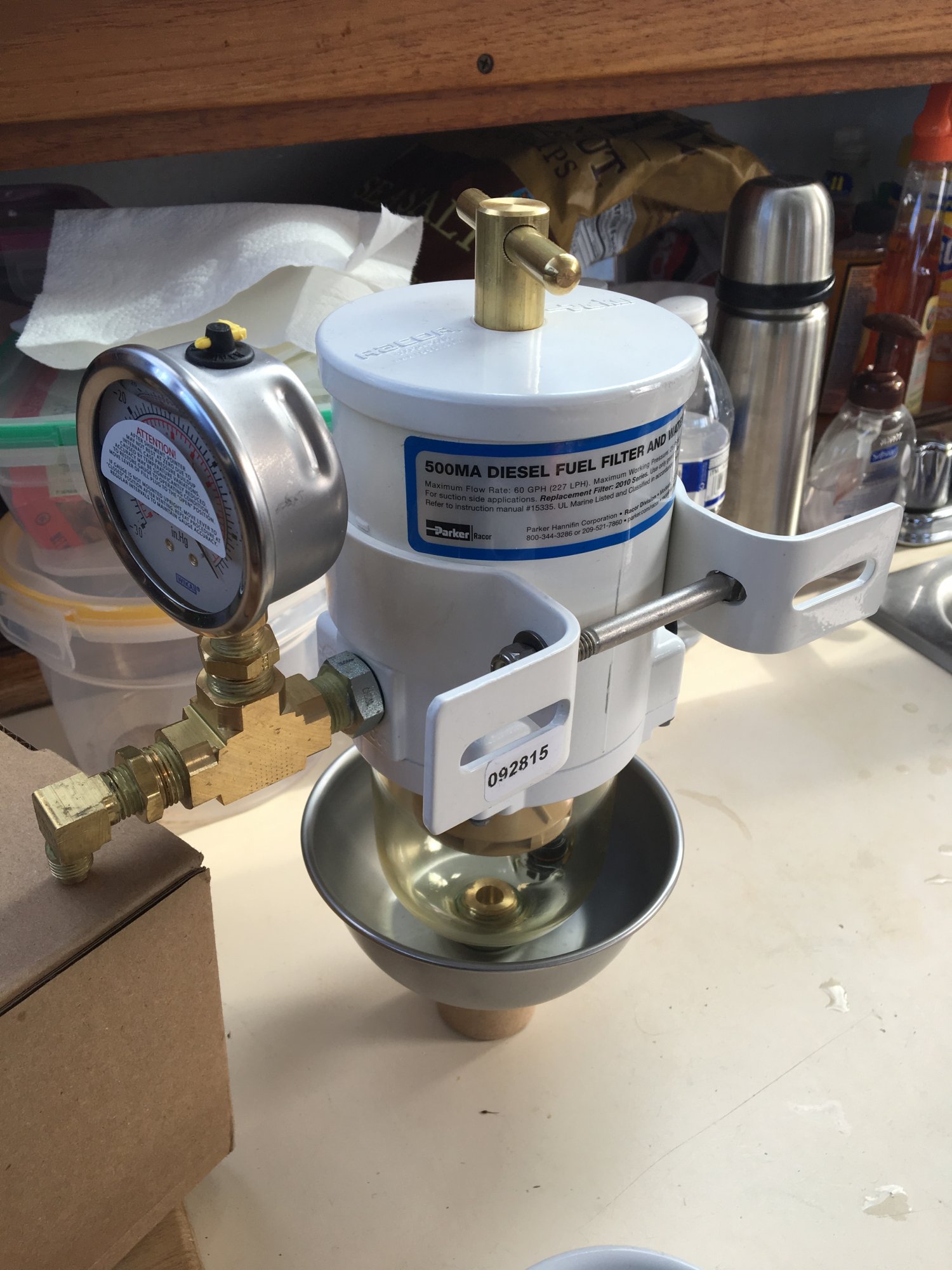

Try this Parker p/n. A kit (RK19671) with the RK19669 and a T-handle which I didn’t need but was $23 cheaper than the gauge alone. Sweet talk to Jeremy (Imel) he may give you free shipping.
Likes: jviss
23,143
Here you go. I bought it at a Hydraulics shop. Fluid dampened two indicators. One for current, other for maximum experienced. A fraction of the cost of the Parker unit. Fittings put the gauge in line from the filter to the engine (key point after the filter but before the engine fuel pump). This worked in my set up. It really does not need to be on the filter. Just somewhere in the line depending on your available space.

Thank you, thank you, thank you, guys! Great options. Now i just have to figure out the hose size so I can buy/make the T-fitting I need.
