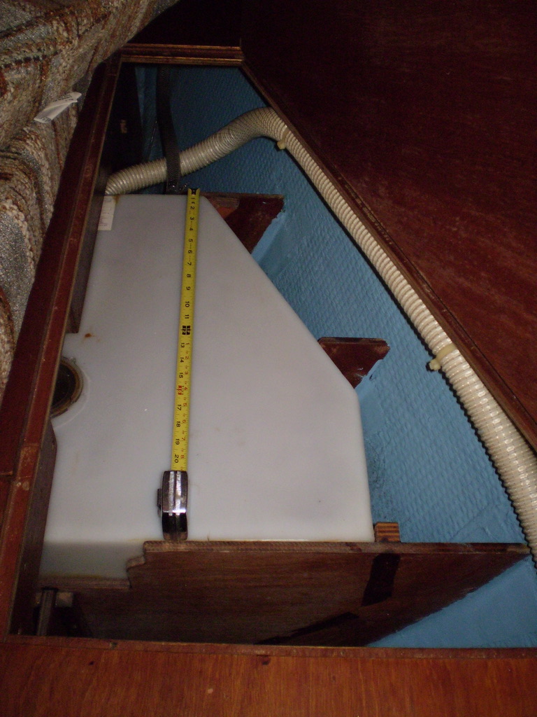

14,278
Oh, you have a big project. The speed and depth sensors will have to move to have a tank of any size. Sooner or later the sensors will need replacing and removing the tank to access them will be a major PITA, especially if one begins to leak.
There will need to be a ledge around the perimeter of the tank to support the platform. Then added a partial bulkhead on the fore and aft sides of the holding tank that extends up to the platform level. A center support running across the top of the tank will support the middle of the platform. Doubled up ply to support access panels will further stiffen the platform.
All this support will be necessary to prevent the platform from bowing under the weight of you and your significant other unless both of you are particularly dainty. Even ¾" ply will likely bend and or put a lot of tension on the edges which is why the center supports are necessary.

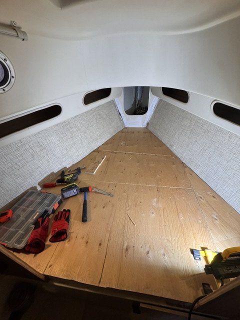

Ok, so we are finally starting the project, we ended up with ¾” just because of the price, it was given to us
We are still working on the actual tank dimensions, but I think with the platform partially in place it will be easier to see exactly how high I can go.
we will start the install by the end of the week.

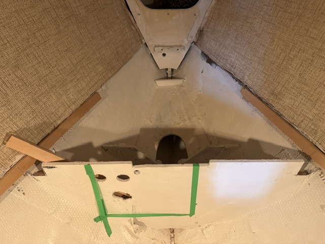

Here is a quick update, nothing has been secured yet!
I will install blocks on the underside to support the sides before installing the platform
In place.
When I receive my tanks (water and waste) I will be able to see the size of the openings needed.

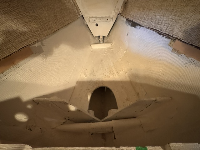

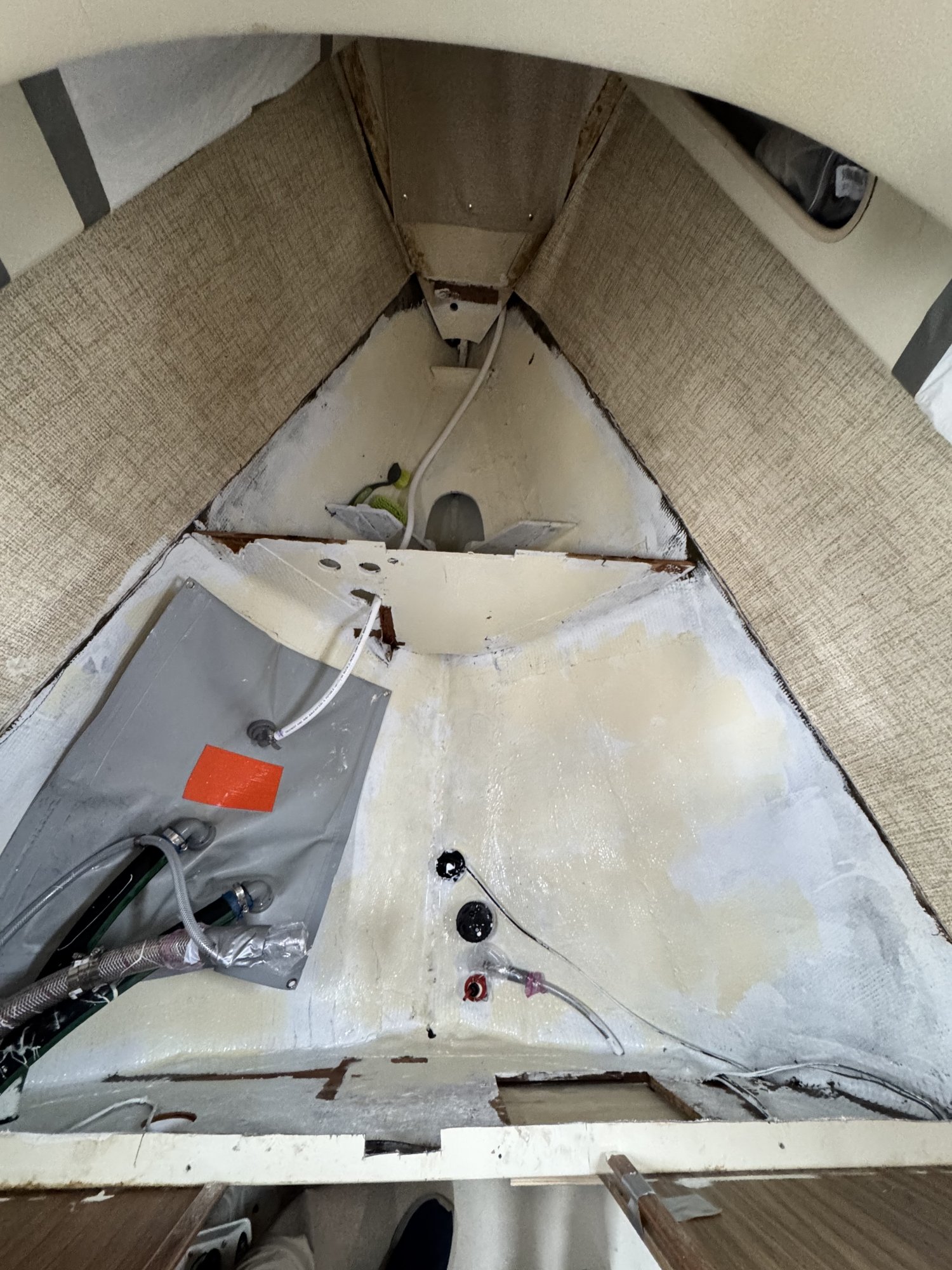

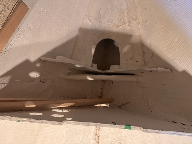

Hello again everyone
We are getting ready to buy the tanks, we are just wondering if some plywood can be removed, one of them is structural, it is easy to see it is structural, but the rest? I am not sure, if I do remove them it gives me more space for tanks, I would reinforce, add more panels in different Location to strengthen after the tanks are installed.
so my question is, do you think it is safe to remove the front V-panel and its shelf? And the big panel that separated the water/poop tank from storage?
Thank you in advance
24,925
In for a penny, in for a pound.
The structure is not for the berth; it is to maintain the hull shape, so if you hit something in the water, the hull does not collapse inward.
Additionally, you want to limit the weight you put onto the bow. Already, you could have a chain and an anchor rode. It is wise to have limited bow weight so that as you enter into an oncoming wave, the bow flotation causes it to rise up and over the wave rather than bury itself into the wave and have these seas wash up and over the deck.
Water weighs in at about 8 lbs per gallon. Putting that gallonage near the center of the boat improves the ride of the boat in unsettled seas.
