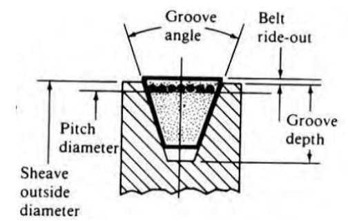

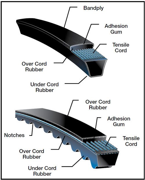

Return the 20" belt and get a 19" belt. Very rarely does the sheave or pulley wear out. That said checking the width of the groove(s) may not be a bad idea. The width at the top of the groove should be just a little over 1/2". This allows the over cord and the tensile cord to ride just inside the groove. If the over cord and tensile cord are outside the groove it will allow the softer under cord to wear more rapidly.

Also consider using a belt with notches on the underside. Often the pump pulley has a very small diameter and the notched belts will conform better and slip less. Belts that also turn the alternator are more likely to wear from slip as alternators are harder to turn as current demand increases. Go with the smaller length.

Maine Sail has also recommended the Dayco TopCog belt, which has the notches on the top of the belt. I believe for the same reasons Roys mentioned a notched belt, more flexible for better contact.
