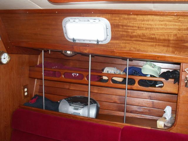

Starboard is basically a decorative product, and a great one, but should be reserved for applications where it is not under load or stress. You can bend a sheet of 3/4" Starboard very, very easily while a sheet of multi-ply high quality plywood is very, very stiff by comparison.
I had to add those stainless struts to my pedestal guard table as even the weight of my instruments, on that short span, was bending it.. Imagine a span 6+ feet!!!
