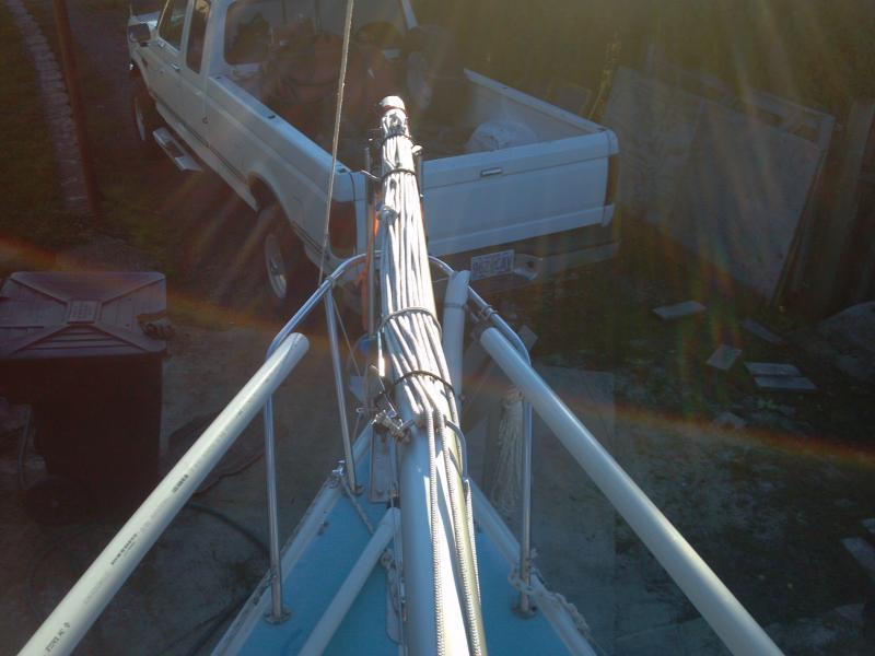

a sailboat with lifelines is hard to tarp.
but with a frame made from pvc pipe, it is a lot easier to do..

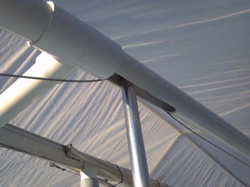

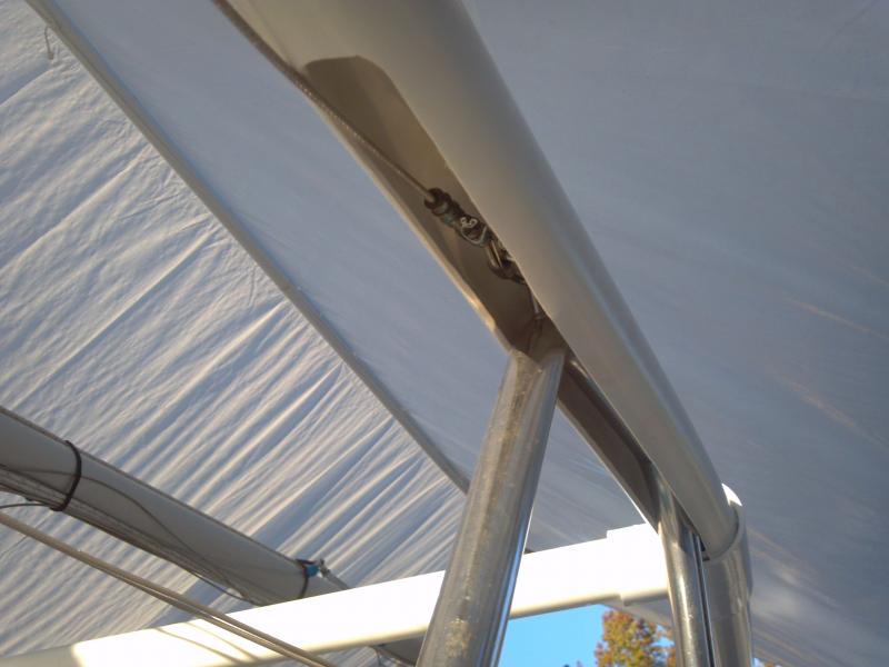

I cut slots in the pipe to fit the stanchions and then put spreaders in so when the tarp is snugged down it doesnt cause the stanchions to have inward pressure on them.... as the wind pressure against the tarp can be quite severe at times.
i used 2" and 1.5" pvc to construct it... and it tarps well with 2 smaller tarps, rather than one big one.
I should be able to get many years out of it and makes the tarping go fast and easy
