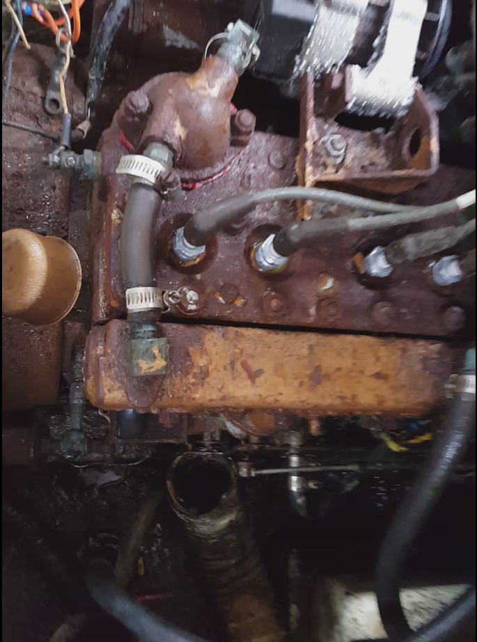

Thank you for the tips! I did visit the boat and fall in love with her :) Unfortunately had only 1 day and spent it all cleaning. Did take some pictures. Below is the engine. Is it possible to determine based on the picture if it is FWC or RWC? I would assume that FWC is better, correct? Another reason I did not attempt starting it, because I was told the engine was winterized (anti-freeze?) and it is still cold in CT. Will have to come back later in the spring.

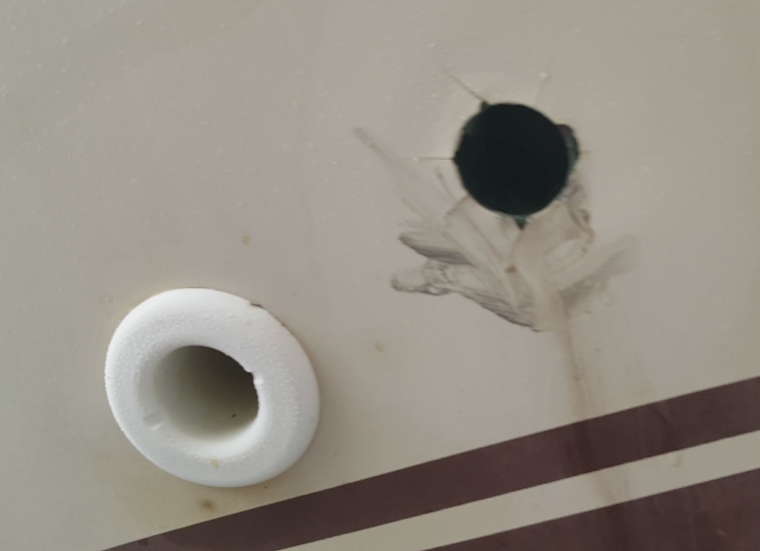

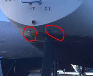

And one more question (not related to the engine): what are the two circled holes for? The black ones are for the cockpit drain most probably. What about the white ones just next to them? Nothing in the manual.

You are correct in that the flush ones are scuppers, the 2 fittings may be manual bilge and auto bilge pumps. You will not know for sure unless you trace out the hoses or verify by pumping water thru. That compartment is the hardest spot to work on in but I would go back there and look at the hoses. The access is via a hatch at the aft end of the quarter berth, on our 78' the old exhaust hose split at the transom fitting filling the boat Carbon Monoxide, lucky for us I had installed an alarm. I would check on things back there before splashing the boat.
My guess is the motor is RW cooled, you have to trace the hoses and look for the heat exchanger. If you do have one check the zincs. You would have waterpumps if it was FWC and with an A4 the 2nd pump can be electric or run off a pulley added to the fly wheel. Moyer Marine is the forum and place for all things A4.

That motor is RWC. The thermostat housing goes right into the exhaust manifold. (Unless the exhaust manifold doesn't flow into the exhaust elbow.) If you have a pic of where the hose coming out of the exhaust manifold goes, it would be conclusive. But 99.9% of A4s were RWC. No biggie either, just maintain them and they lasted 30+ years.
Those thruhulls are likely bilge pump and manual bilge pump. The port locker (sail locker) is pretty easy to get into if you empty it and follow the hoses. There is a panel that's held by 4-6 screws in the back of the quarterberth that gives you access into the cavity below the rear lazerette. Most C-30s have a removable panel in the bottom of the rear lazerette to access the steering and cockpit drains. Nice thing about Catalinas, most stuff is pretty easily accessible (by boat standards).

Did not see the picture. Fresh water cooled engines have a heat exchanger and a fresh water pump similar to your car. Most, if not all, Atomic 4 engines are only raw water cooled. Mine was raw water cooled and I lived in Marblehead, MA at the time. I would close the seacock, open the strainer, start the engine and pour enviromental antifreeze until it came out of the exhaust.
