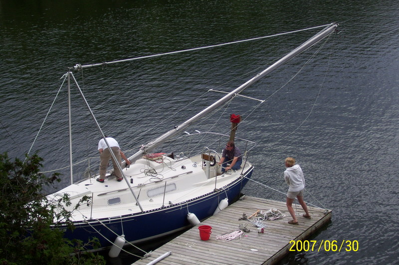

Picture attached shows one person using it but that doesn't mean it is a good idea I know.

First you're going to have to tell me how you get the furler attached to the apex of A-frame.
I can see a couple of ways but it makes it more complex, not less.

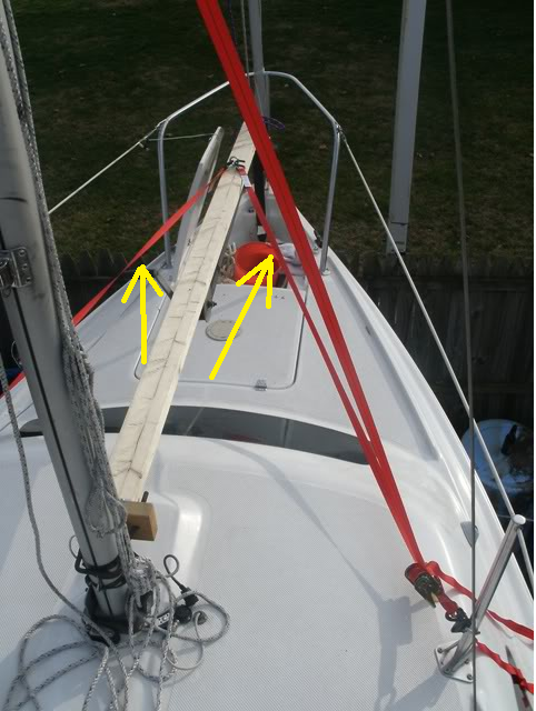

12,926
Do you have your A-frame yet? Another way I've done it (on two different boats) is to use a gin-pole. Then keep the gin pole from tipping side to side with some nylon tow straps or ss wire rope. It is about the same idea but maybe a bit less difficult to build and store.
Just curious where do you hook the nylon tow straps to?
There are a set of padeyes port and starboard of where you set the gin-pole. The straps just keep the gin-pole from falling left to right.

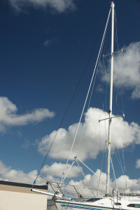

3,972
Using the furler line, or using any of the halyards (or all, for that matter) is quite a common way to tie the mast to the gin pole. The mast needs to be supported side to side, either with baby stays or some mechanical attachment. In the attached picture you see the forward A frame used as the classic gin pole, but there's a secondary pair of poles on the same pivot that support a strap that goes around the mast, preventing side to side deviation.
The forward line is run through a 6:1 block setup that is routed back to a primary winch. While 6:1 is probably a little overkill, and not very fast, the loads on the winch are significantly reduced.
(This picture is a test of the top down furler installation, disregard that, it has nothing to do with the mast raising)
