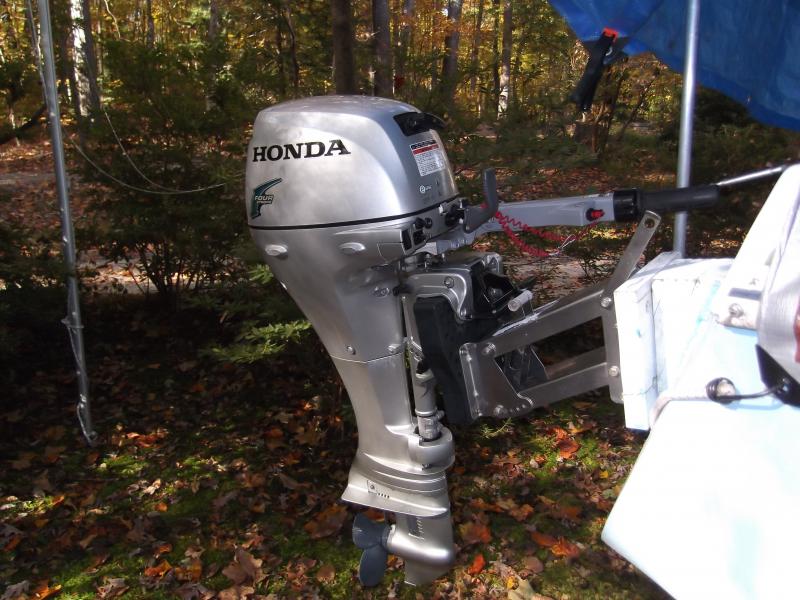

Well I took all your advice to heart and did not buy the Mercury. I went to Gloucester Point last night and bought an 8hp Honda 4 stroke instead. Now I'm a little concerned about the motor mount. It seems like a very substantial Garelick SS mount but the labels are gone from it and I can't tell which model it is. Garelick suggests a heavier mount for the 4 stroke motor but this one might be rated for a fairly large 2 stroke so it may be fine. Any suggestions? Thanks.

Can you identify it by comparing to pictures on the Garelick site?
Looking at the picture, it looks like the spacer between the wedge and bracket is an adapter to allow the wider bracket to be bolted to that and that adapter is bolted to the wedge. While the bracket most probably would handle the weight and torque, the narrower wedge would probably be the weak point since the wedge's footprint to the transom is much smaller. Building a wider wedge might be a worthwhile winter project.
Nov 9, 2012
2,500
Oday 192 Lake Nockamixon
Meh. I see Ward's comments, and they are valid. And I see what he's saying. It looks like there is definitely a homegrown wood adaptor between the motor mount, and the original fiberglass wedge which would have accommodated the narrower 2 stroke mount that the boat shipped with.
From what I can see, it looks like the homegrown wood spacer is beefy, with a 2x8 blocked out on a 4x4. I don't know that I would worry much about it, other than it looks kinda ugly. I'd be inclined to make a new wedge to replace the adaptor and the fiberglass wedge, but, as Ward says, is wide enough to mount the motor. Proper backing inside the transom would be key here as well. That is, if the PO's adaptor looked wobbly or was particularly annoyingly ugly to me… :D:D:D
That SS Garelick motor mount, with it's wider spacing, should be plenty strong to resist the dreaded 4 stroke torque. Personally, I think the lifting handle on the Garelick is woefully poorly engineered. Garhauer makes a far nicer mount, with a much nicer lifting handle. Sage Marine uses them on the Sage 17. I haven't found it in the Garhauer on-line catalog, but I hear Garhauer is a very easy company to deal with, so I'd contact them directly next time I need a new bracket.
For the record, I have a 5hp 4 stroke on my boat, using the original aluminum 2 stroke bracket. I see no evidence I should worry about the torque from my motor, and I also put a high thrust prop on it. In my experience with my setup, that whole 4 stroke vs. 2 stroke torque thing is a myth. On the other hand, 4 stroke engines are heavier than 2 stroke, so I tend to believe that's a factor more than anything. Considering most of us are using smaller motors than the max the boats are rated for, most of us are well within force parameters.
That being said, I don't drive down the road with the motor on my bracket, and yes, the bracket does seem to have more side to side play in the system than I'd like to see. I'll have to suck it up and replace it at some point….

Thanks again for sharing your knowledge with me. I also think the wedge is pretty ugly and just doesn't look right somehow. It does have a lot of side to side movement but most of that is in the motor mount itself. There's a lot going on in that mount and I can see where there has to be some movement because of all the joints and pivot points. I took the old wedge off today and I'm going to completely rebuild it. I think I will laminate it up with exterior plywood and then fiberglass over that. I will make it much wider where the wedge meets the transom and double up on the stainless steel bolts and backing plate. I think the Garelick mount is strong enough but I'm not happy with the wonky wedge. I'll post a picture when it's done. Thanks again for all your help.

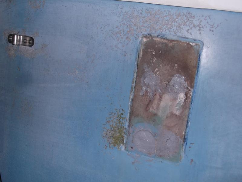

There are some areas on the transom that look like the gel coat has been beat up over the years. Some spots around the rudder brackets and near where the motor mount wedge was. These are not cracks but rather pitting and they look to be cosmetic only. I want to paint the transom since I am replacing the wedge and I am looking for some advice on what to use to smooth the surface before I paint it. The pitting does not extend down into the fiberglass matt. For lack of a better description I would say they are about as deep as a match book cover. I could almost sand them out but they seem to be a little too deep to do that. If it was a car I would use Bondo or something like that applied with a putty knife and then sanded smooth. I'm not sure if that would hold up to the elements however. I've got a box of something called marine-tex but I've never used it. Does anyone have any experience with this? The sales blurb on the box says "Handles like putty, hardens like steel, sands like wood". If I believe all that it might work okay.
Nov 26, 2012
2,315
Catalina 250 Bodega Bay CA
I have used Bondo but that Marine-tex sounds like it is epoxy designed for marine use. Go for it! I would just spray the affected area with epoxy paint but I am sure others will suggest more painting approaches. Chief

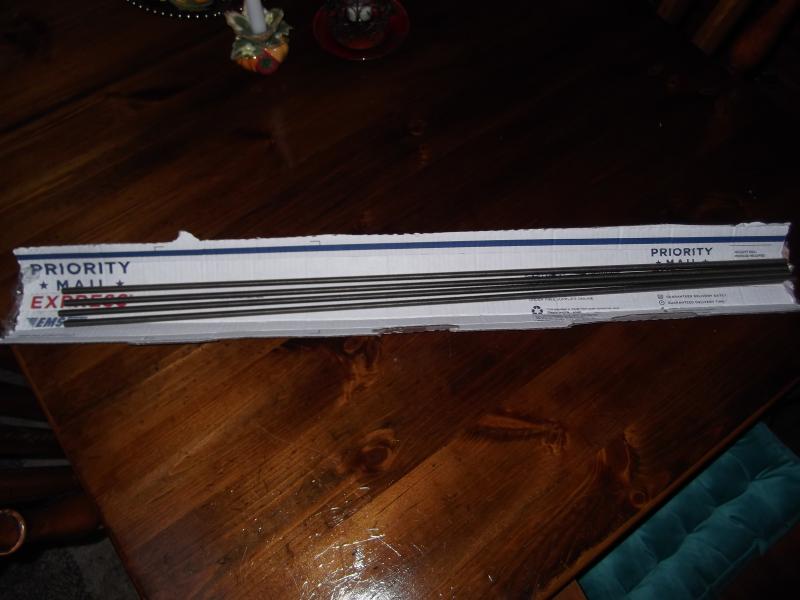

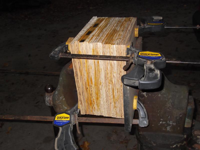

Good morning guys. Well I'll let you know how things work out. Might take some pictures of my new wedge today if you are interested at all. It's still in the process of being glued up. After looking at the price of marine paints I decided to put function before form on this one and bought two rattle cans of "sail boat blue" (no kidding) Rustoleum. Thanks for all your help.
Oct 21, 2014
190
Oday 22 Richmond
I took a few pictures this morning to show the progress of my new wedge. As I stated before the original (well not really original because the original was a pipe) wedge was in my opinion not nearly strong enough for that 8 hp 4 stroke Honda. As you can see I pulled off the old wedge and filled the holes with epoxy. I glued up a 12" X 12" block of exterior plywood which is still in the vise. I will band saw out the wedge tonight. I bought that stainless steel all thread from McMaster because I didn't want to have to concern myself with buying the perfect length bolts. I'll just bolt it all up and saw off what I don't need. I think (8) 3/8" bolts will be plenty especially since the mount is going to go from 4" wide to 12" wide with a 12" by 12" backing plate. You may be able to see the rough gelcoat I am dealing with. I'm going to putty it up with the marine-tex, sand it down and shoot it with the rattle cans. If I have to repaint it I'll just buy a couple more cans, light sand it and shoot it again. It's just the transom so no big deal since it's only about a square yard of area.
