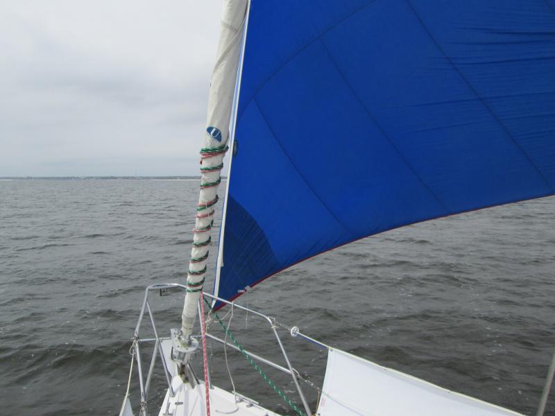

Ok. Flew it today but only as a loose Asym Spin. Didn't have time to take off the Genoa and run this new Gennaker up inside the foil. Next time.
May be a little bit large but not by much. Flew from about 150 degrees off the wind up to maybe 80 degrees off the wind. Big power in 12-14 knots of wind. Was doing 6.7 knots.
Need to rig a better tack line attachment and run the tack line back to the cockpit. Probably mount a bail on my anchor roller as mentioned above and then mount a block to the bail for tack line led back to the cockpit. The clew is way back behind the mast...maybe 165% is my guess. Red, white and blue so it looks nice.
In light winds I could probably pole this Gennaker out with my whisker pole. I think it will be a little bit easier to manage in winds under 10 knots.
And I did not notice much "edge chatter" so that is a good thing I guess.

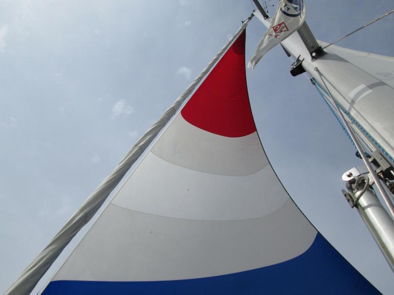

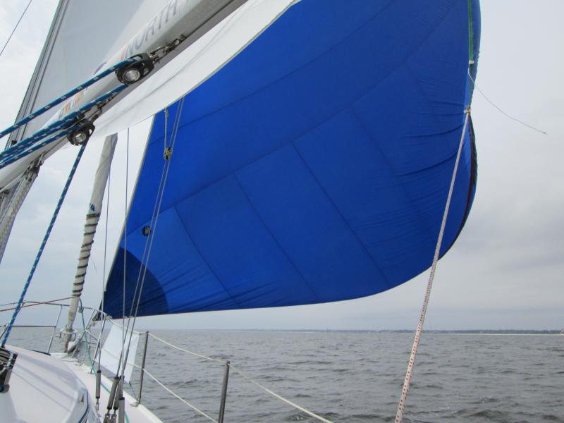

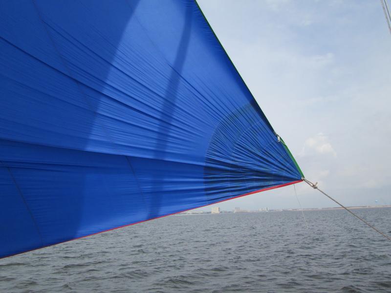

It is difficult to get good pics of a spinnaker/gennaker flying on my own boat...too close. But here is what I got that day.

How do you jibe...the tack is outside the pulpit?

OK, this is one of those times I should just keep quiet. I may be off-base, but as always - everyone's entitled to MY opinion!
I think what you have is indeed a GENNAKER. Not truly an asymmetrical or "cruising spinnaker." Yours has, from what I can see, cross-cut construction and no radial design. This is basically a big, 180%, full-cut, 3/4 oz. nylon genoa designed for relatively light wind and off-the-wind work.
The bolt-rope is actually a luff-tape designed for a Head-Foil, not a furler. The purpose of the twin groove head-foil is to allow the deployment of a 2nd sail before dousing the 1st sail. Obviously, you were able to fly this sail without a forestay attachment, but probably need firm halyard tension to do so.
Again, I may be way off-base, but think this is what you have. It is going to be more valuable to you as a free-flying sail, but probably not going to be able to sail as high as it was designed for.

I think you are spot on. But it seems to kinda/sorta work as a free flying spinnaker...and it kinda/sorta looks cool.
And I am kinda/sorta weirdin' myself out with this "kinda/sorta" thing...
And besides I just spent about $100 on a new tack line plus a block and shackle for the tack line and a snap shackle to attach it to the sail...
