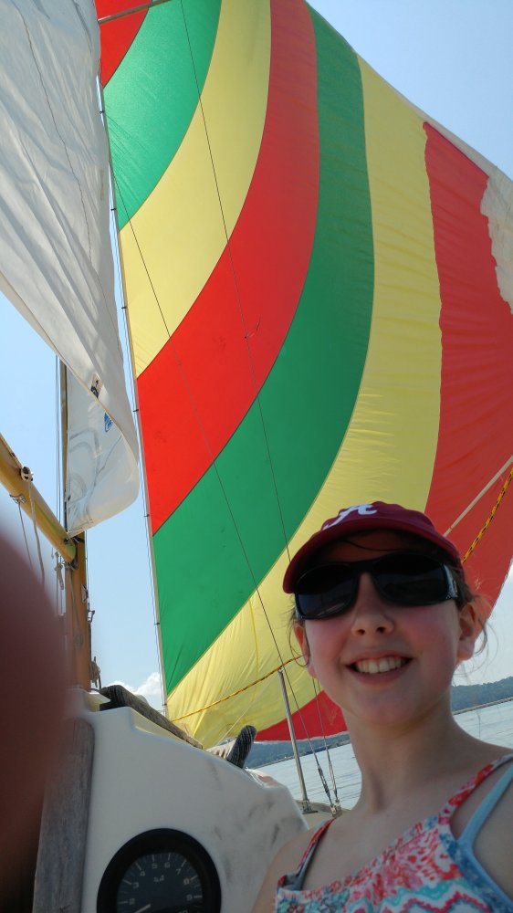

Flew our drifter sail this weekend, worked great in the less then ideal wind conditions. Only issue is we got a rip in it, what is the repair for that short of sending it in? I saw sail tape, not sure this is ok for this light weight spinnaker material.

Only reason I suggested the tape. If John is looking for a better solution then there are sail lofts in Port Townsend, Ballard, Everett, and Seattle that can (for a price and a wait) properly repair the sail.
One can also add stitches to the tape to enhance the repair. But will need to be careful as to the thread used.

Would it be better to sew it? My wife has a machine she thinks she can do it, material is very light and given the probable age of the sail (30+ years) and unknown condition or quality. It was fun to have it up and drift along this weekend. We got a lot of other boaters attention so I think we will get more use out of it till it fails or falls apart.

Oh, that tape will hold forever, and the sail will rip somewhere else before it rips on the tape again. Its that strong.
Professional repair is the great option, but on an older sail that will be even more obvious as the UV fades the colors of the nylon and it will never match.

Depends on the nature of the tear, but probably not. You need to have good, overlapping cloth to effect a solid repair, and you don't have that unless you cut off all the torn fabric and pinch in the panel, which looks terrible and creates stress elsewhere. There is a good reason people either use tape, or send them in to have a panel or partial panel replaced.

Ok, thanks, I'll order the red tape and go that route. Old sail so just having fun and learning with it. It did work well in the 1-5 knots we had this weekend, we sailed both Saturday and Sunday with it.
