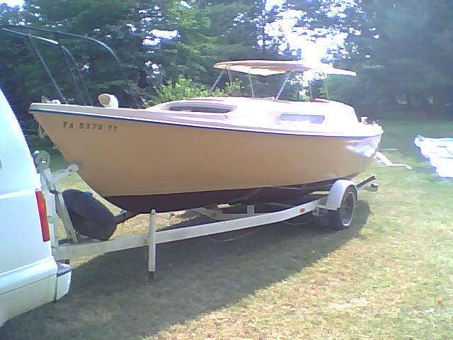

Whew! That is a bit more hard corp that I want to be. I don't think I'd want to try spraying. The polyurethanes I've used came from this place...
http://supermarinepaint.com/?gclid=CM6xgYGA8rICFZSd4Aod_3YARA
The stuff was one part single application (just like regular paint) and it had excellent self leveling properties. Took about a week to get fully "cured". After a day it felt dry but if you walked around out it, you would leave heal marks (ask how I know).
This is the paint I used on my MacGregor. I can also say it had excellent coverage. I purchased two gallons, one for the hull sides and one color for the top sides. I had more than half of each gallon left over.... which as been nice when I bang up my paint job on the pier... :eek:
... and the bottom is just Rustoleum (good stuff too).
