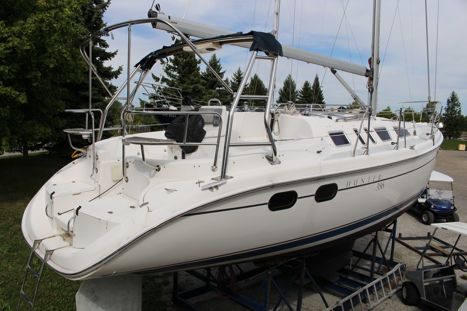

I am the newish owner of a 386, still learning all the optimization steps. The boom came with an empty Rodkicker into which I have installed an air-spring (to allow for easier "vang" and topping lift (TL) work from the cockpit). The topping lift, with an air-spring in the rodkicker is really there only for either a) bosun's chair lift; b) extra halyard in emergency; c) topping lift if the rodkicker blows out.
The boom has three (3!!) boom sliders along the bottom of the boom, aft of the rodkicker attachment (see attached picture - you may have to zoom in). I cannot figure out what the previous owners installed these for - given it is a furling main and there is no time when one uses vertical reefing.
Thoughts please?

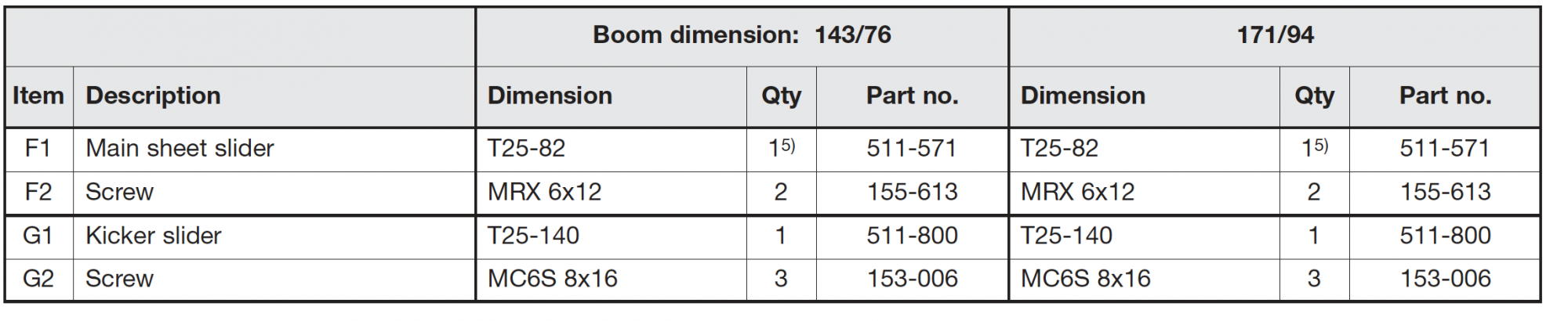

The Seldén parts manual refers to these as mainsheet sliders presumably for midboom sheeting. Since Hunter gave you a nice arch mounted traveller with boom-end sheeting, these aren't needed on your boom. The dealer left them for you to invent new uses for them. I like hanging a light from one at anchor just as additional eye level illumination for boats that may be passing by in the dark.
23,392
Yes. :plus:
They are original hard points on the boom.
With the forces on the mid boom when you use a mid boom main sheet rig to the cabin top, the boom would snap into two halves without the engineered hard points. There are three to spread the load across the boom.
For light wind connections, I have seen preventer’s attached to stop the boom from swinging. In gale force winds, a single preventer line attached to a single mid point on any boom could damage the boom.
