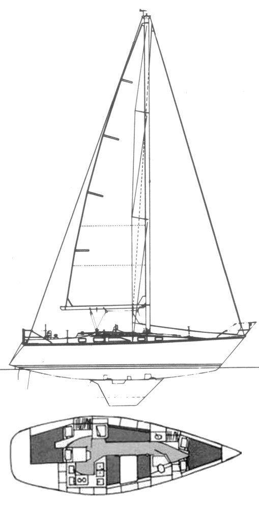

The drawings are to scale. Including the waterline. The full scale specs are on sailboatdata, etc.
Print the drawing. If it is 1 foot tall on paper, and (example) 50 feet tall in spec, then you have your scale: 1/50.
Then use the drawing to measure freeboard, v-berth etc.
If it must be a very precise measurement then of course do in person.

Tried the measurements from sailboatdata, thanks, using the reported lengths for J and I, etc., and came out with an approximate scale showing the freeboard alongside the cockpit as about 41 inches. It is probably close and sufficient for current needs, but I will be interested to measure the actual distance. Meanwhile, I still think it would be useful to have these numbers (which I see from searching are commonly asked about-particularly cockpit length) in the boat info sections or a separate database.

using my rough scale, 21 inch stanchions, but I would not take it to the bank. This is another of those stats that should be available for all boats somewhere on the site.

What I usually do is import the image of the boat into Visio. I think use a 1:1 scale and rescale the boat. The measurements are pretty close. Usually within a few inches. Plus it is fun to do.

I calculated 3' 6" from the waterline to the toe rail at the first stanchion. I am now curious to know what the freeboard is.
