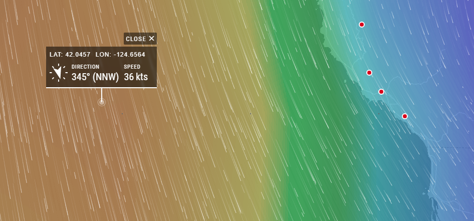

I'm just looking at day sailing for now. But forecasts aren't perfect. A local told me about the time he sailed around the St. George Reef lighthouse, 14 miles from the harbor, and got hit with a squall blowing 40kts even though the forecast was for clear weather. Says he got knocked down twice and barely kept it off the rocks.
I'm not looking to head out in a storm but I want to be prepared to survive if necessary. Is maintaining control in 35kts an unreasonable expectation? I went out into 25kts and 8' waves and really struggled to control the boat but managed to go where I wanted. That's why I'm asking about smaller headsails.
It's a sunny 71 in town right now but the wind map shows 36kts offshore.
