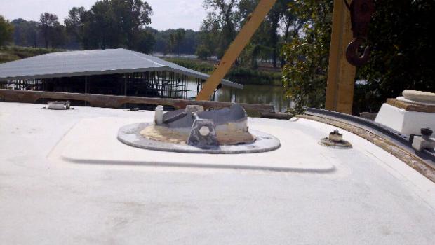

In the world I live in things have to be perfect replacements. When it comes to replacing my mast... simply where are the ditches dug on what to buy? Does it have to be nasa dead on exact?

I had a friend replace a mast on his H37c after dismasting. It wasn't the same, and looked terrible. No it doesn't have to be the same, but it would be so much simpler if it was. Mast step would fit. Hole in the dect the right size. Rigging points in the same place, etc. I think the original Kenyon section is still available.

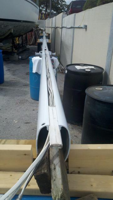

It was broke in Katrina. I have the piece in the boat... I had a 22 foot piece that came with the boat... I cut it up I should be able to recycle it... pretty heavy :)
