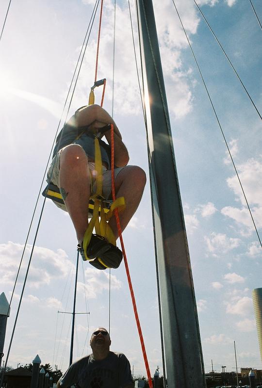

I have a Top Climber and a good Bosun's Chair. I like the system a lot after getting it mastered.
I'm 6'7" and weigh 225 and climb on a taut halyard using a second halyard as a safety line on my harness.
I found that straddling the mast on the way up made life easier because it reduced the tendency to become a pendulum.

I use the mast climber, 6'4" 240 at 59. Need the halyard tight, really tight to make it easier. I also use a spare halyard as a safety I have the wife just lower me down so that's an easy trip.

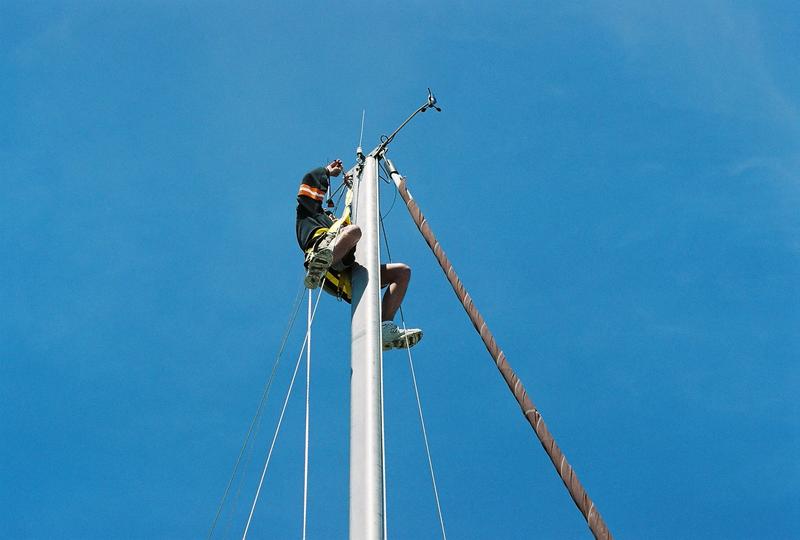

I got the Top Climber when I still had good knees and was running a lot. Now my knees are shot and at 57 years old, 6' 1", 215, it is a lot of work climbing up. I go up a taught halyard (as tight as you can get it), with a second Halyard as a safety when I have a helper. However, I have climbed up when by myself. I wouldn't recommend that.

Bought one years ago. Agree with all that it takes a little getting used to and it is a bit of work. It's nice to have aboard because it can be used solo if needed, although it's always better to have someone around to make sure your secondary line (we use the spinnaker halyard) is managed...and to catch you if you fall :eek:!
