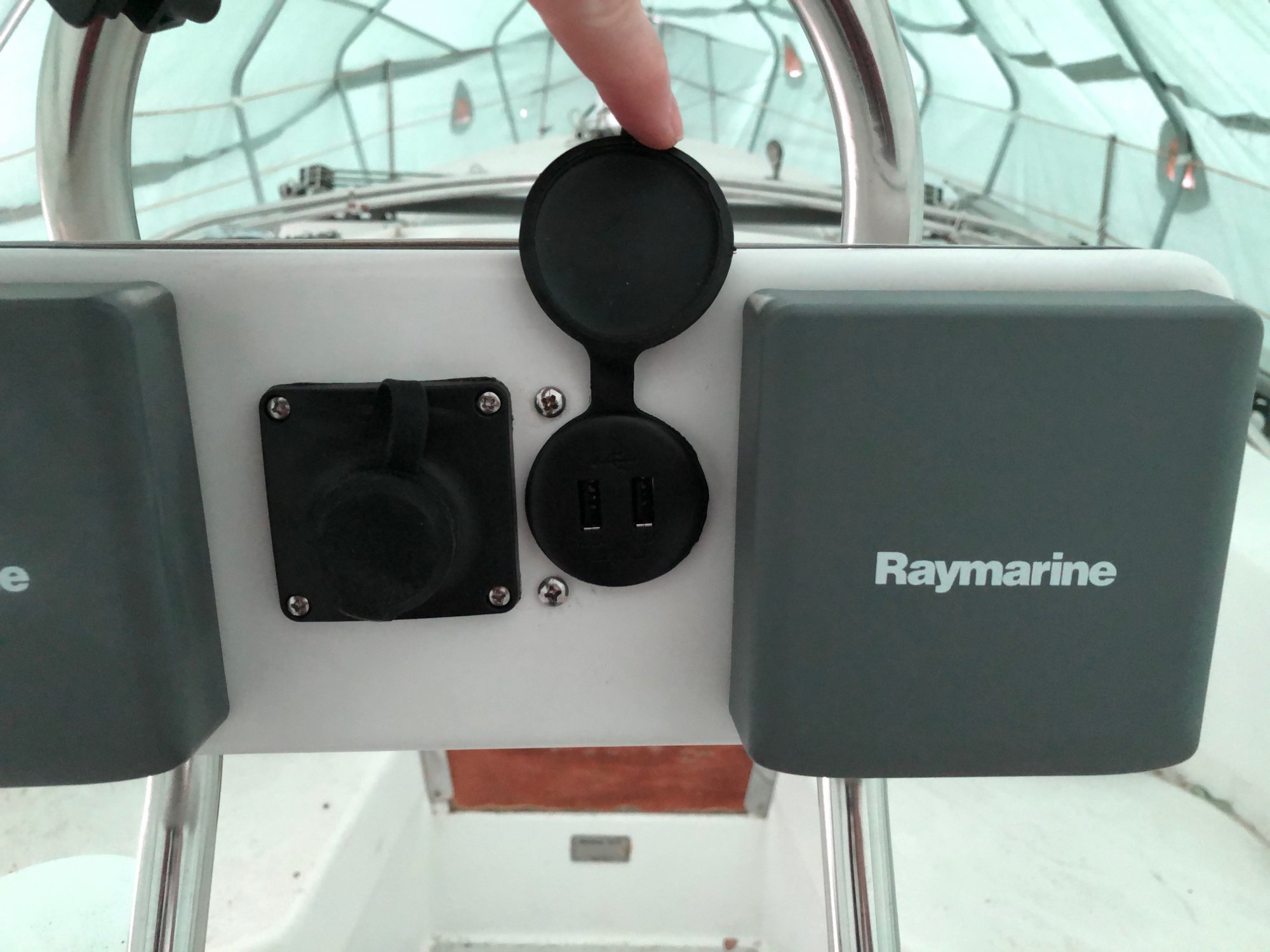

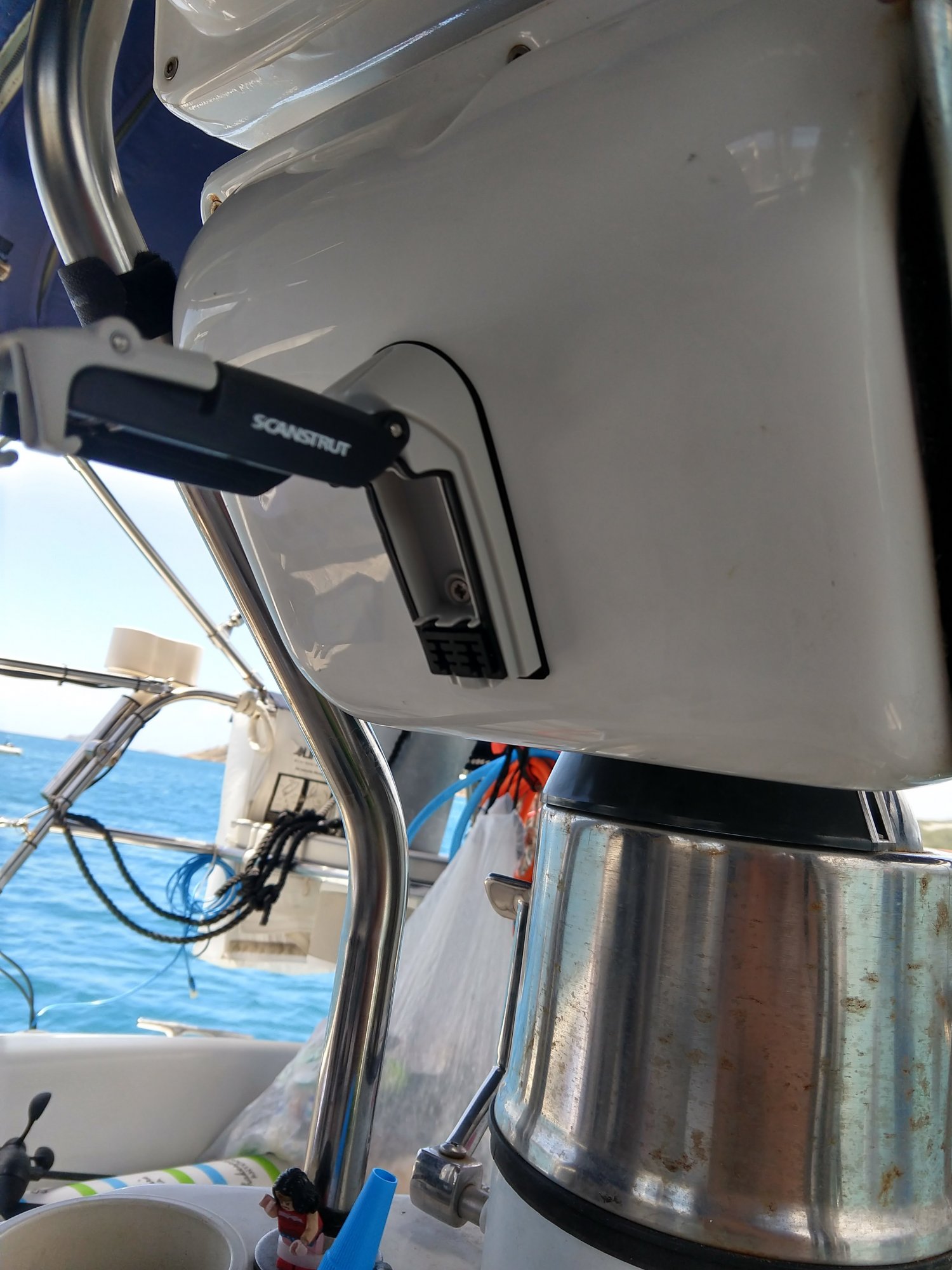

Dual USB outlet on the lower side of my NAVPOD facing the helm. Modern electronics are very shallow, so there is a lot of extra room in the navpod.
Cutting the hole for the USB outlet is child's play with a stepped drill. Cuts like butter, leaves a smooth hole.

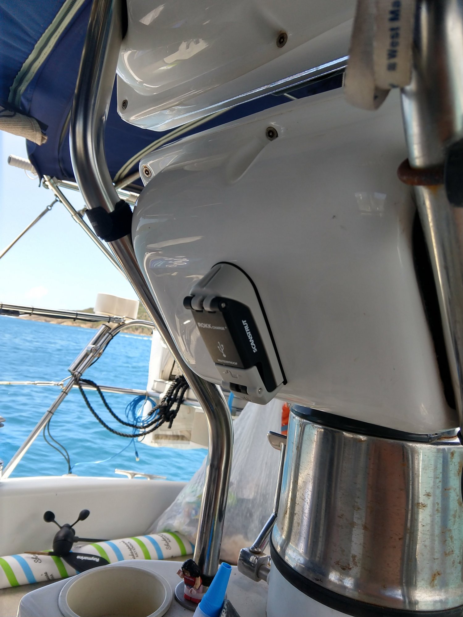

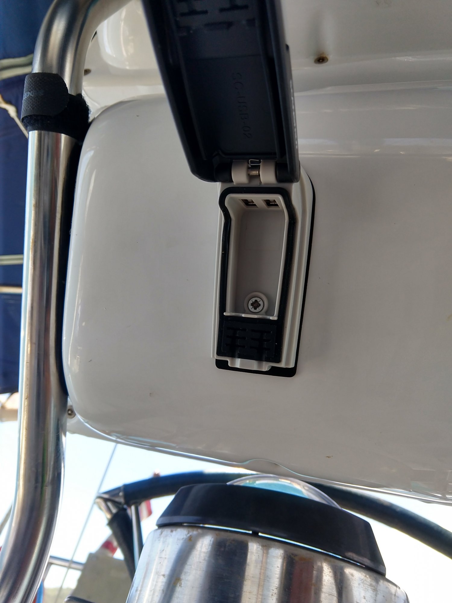

I switched to the Rokk Charger from Scantrust. A little more money but worth it. Two waterproof connections. I installed it on the back of the navpod.
Just recieved my today from this recommendation. Looks quality built. One thing that caught me was it is not flush mount and requires about a 1" hole.
Likes: SailingErrant
I think they tried to make it compatible for an upgrade if you already have the cigarette lighter type of outlet. I wish they made a flush mount as well but it works.

Ok I think I have a plan, I really like the Scanstrut ROKK Charge Rapid Charge Waterproof USB Socket that @JK_Boston_Catalina310 recommended. My Navpod for my 3 instruments just doesn't have any room so I looked at the lower trim skirt with the drink holder and cockpit table attached. It is all flat with some nice area to use on the helm side. Only real problem the bottom is open so I'm not 100% sure how to make it look neat with wires for power down there.
