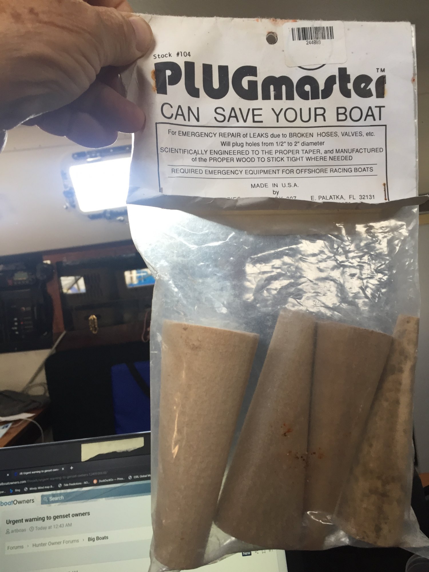

View attachment 215247View attachment 215247
I have a set of these on board. The issue with the problem I found is that this through hull is very inaccessible. As well, the hose was just about ready to fail without my being on board.
I am aware of another H49 that had a bad flood 2 years ago when the owner was off the boat. I can’t comment on what caused it, or the state of their bilge pumps,
All I’m saying is that these plugs are invaluable when you are on board, and aware of the water intrusion. I am confident I wouldn’t have had that luxury with this situation
