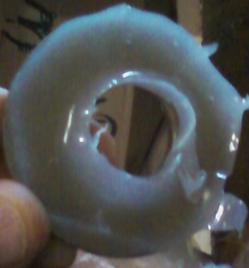

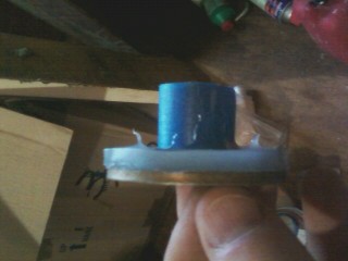

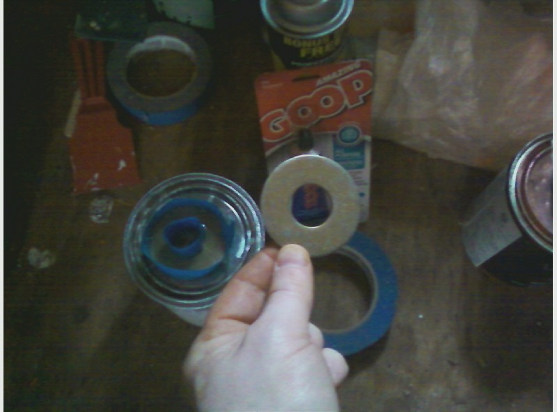

I used to have a Mac 22 and I manufactured my own gaskets. I took a large washer and made a "dike" out of masking tape, then filled the dike in with liquid goop (see pictures). You can get goop at Lowes. Let the goop dry overnight and then remove the tape. Easy peasy, lemon squeezy.
