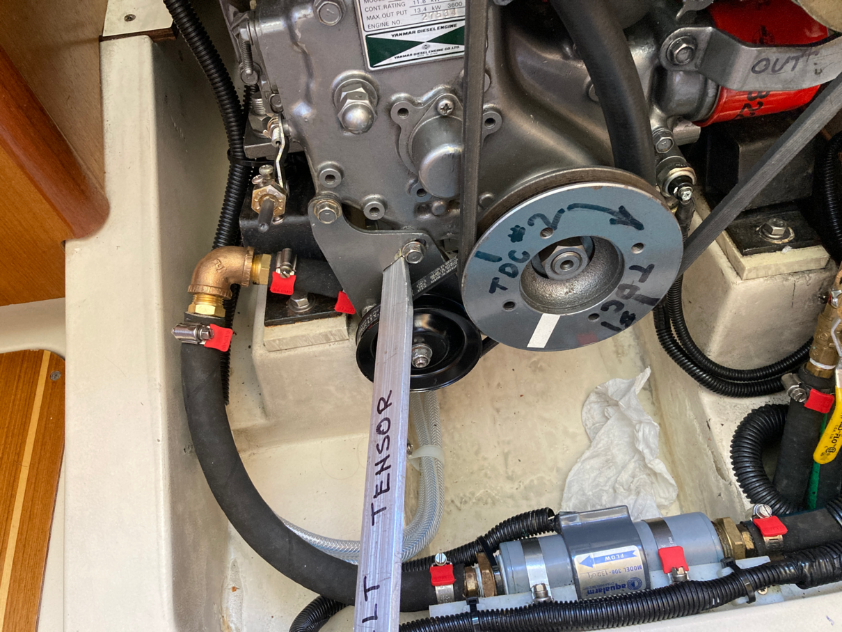

This is one 27 YO pulley on the engine crank of my Yanmar :
The water pump and alt. pulleys are the same. No belt dust and the belts don't show wear.

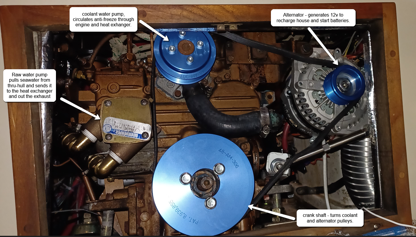

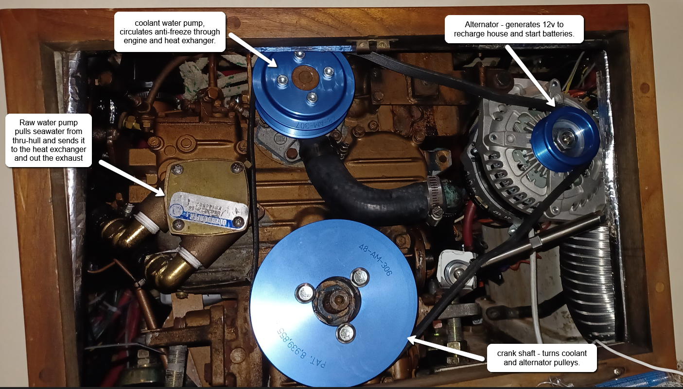

  • The alternator is the only charge source for the start battery and also provides all power to the house bank when cruising.
  • The alternator sends power to both the start and house bank through an ArgoFET battery isolator and all loads from the two banks are completely isolated from the other.
  • I control the 250A alternator with a Zeus regulator which is set to limit the max alternator output to 205A and the max charge to the LFP at 190A. It is also set to limit the alternator temperature to 205º as recommended by the manufacturer.
  • In order to get the max power out of my 250A alternator, I needed to upgrade the belt and pulleys to a J10 multi-v rib belt from the factory 3/8" single V belt.
  • I also make use of the Zeus' output limitations based on engine rpm so that the alternator make very little power at idle and WOT and ramps up to the max output at 1800rpm and then starts to go back down at 1900rpm. This keeps the little 23-hp engine happy while providing boat loads of power to the batteries.
  • I have also made a forced air ducting system that brings cool air to the intake vents of the alternator and pulls the hot air from the exhaust ports to discharge out the transom.
