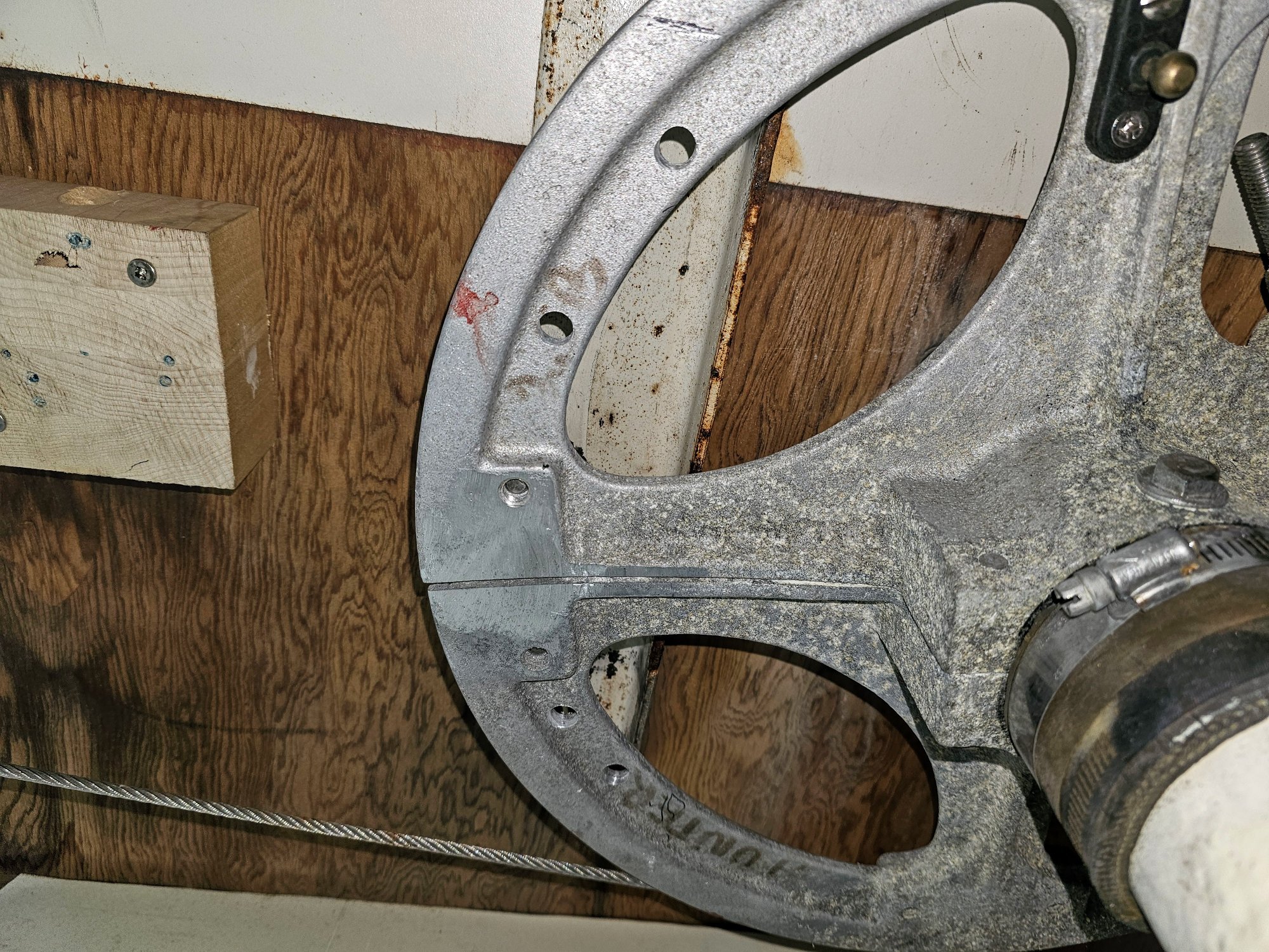

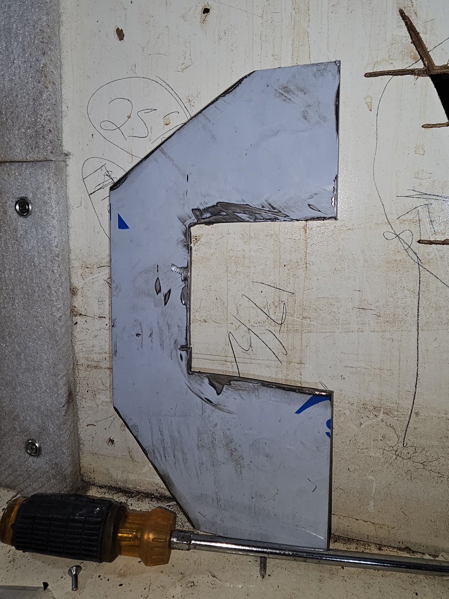

Using 1/8 stainless steel, I cut two plates and drilled four holes in the rudder drive wheel. I've attached the plates to the drive wheel with 4 two inch 5/16 SS screws. I instant glued about 10 SS 5/8 (?) washers together to provide a solid shim between the two plates so that I could really tighten the linear drive bolt to my plates. I'll add a second set of bolts and washers to the inner side of the plates so that the plate won't be torqued by the linear drive bolt when I tighten it down. Everything seems to be working appropriately.
I located the linear drive to the port side and installed a 12 x 20 x 1 inch starboard inside the bottom of the lazarette to spread out the torque. Plus two 4x4x1 starboard pieces to go under the linear drive bracket so that the drive arm was parallel to the drive wheel. I also found out the forward and aft positions for the drive bolt so that the total swing of the arm during operation was minimized (hopefully under their 5 degrees.

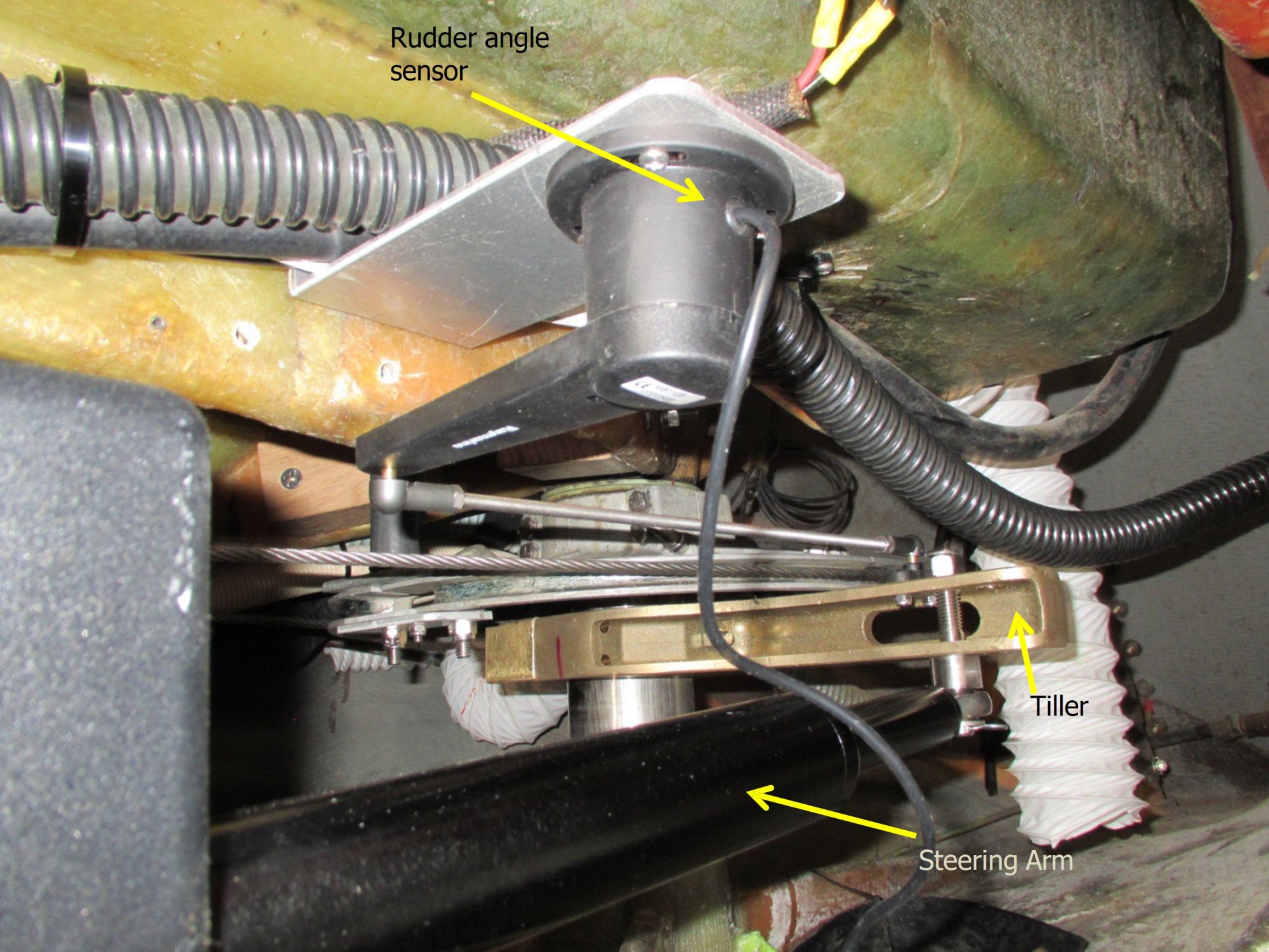

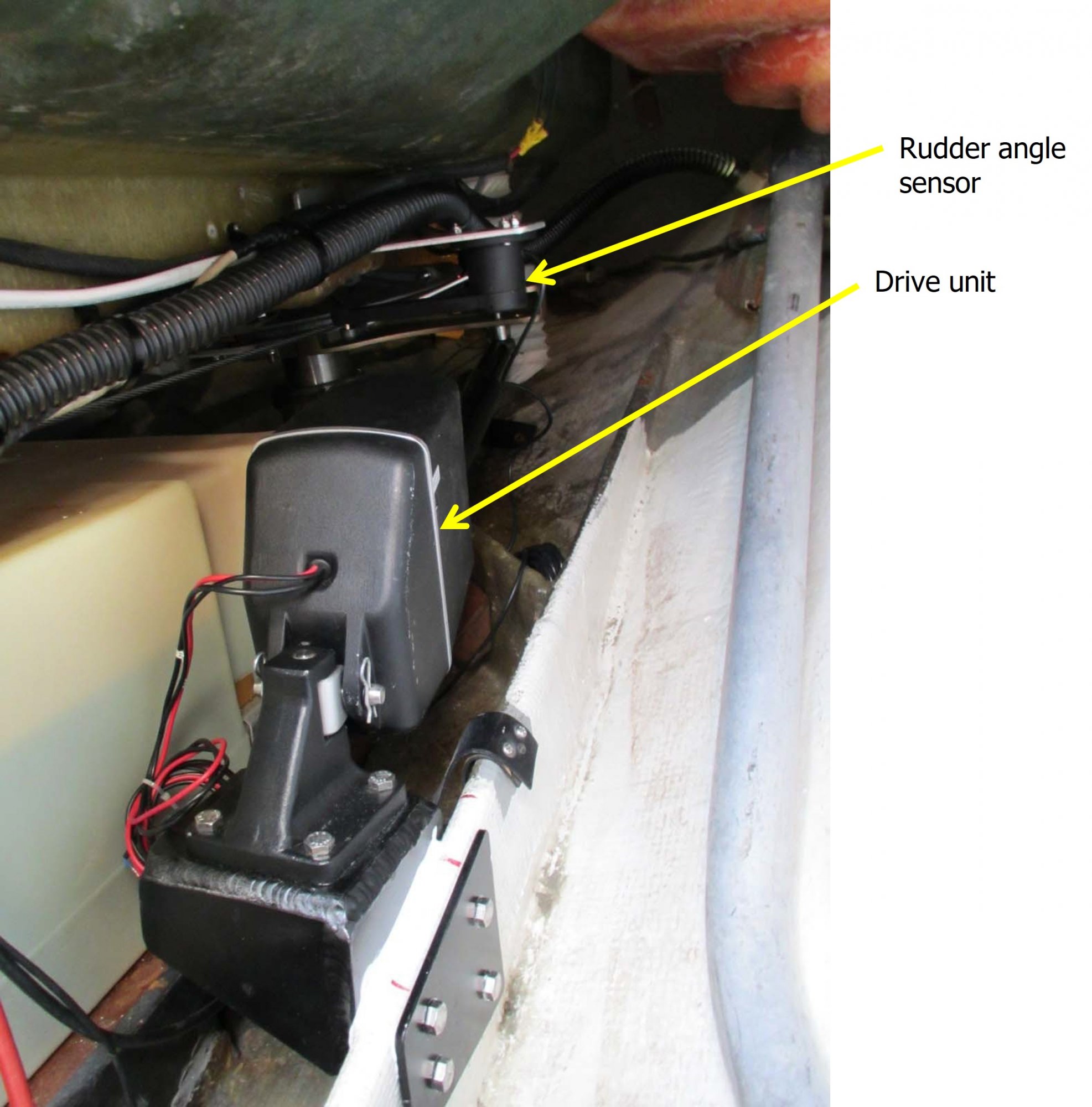

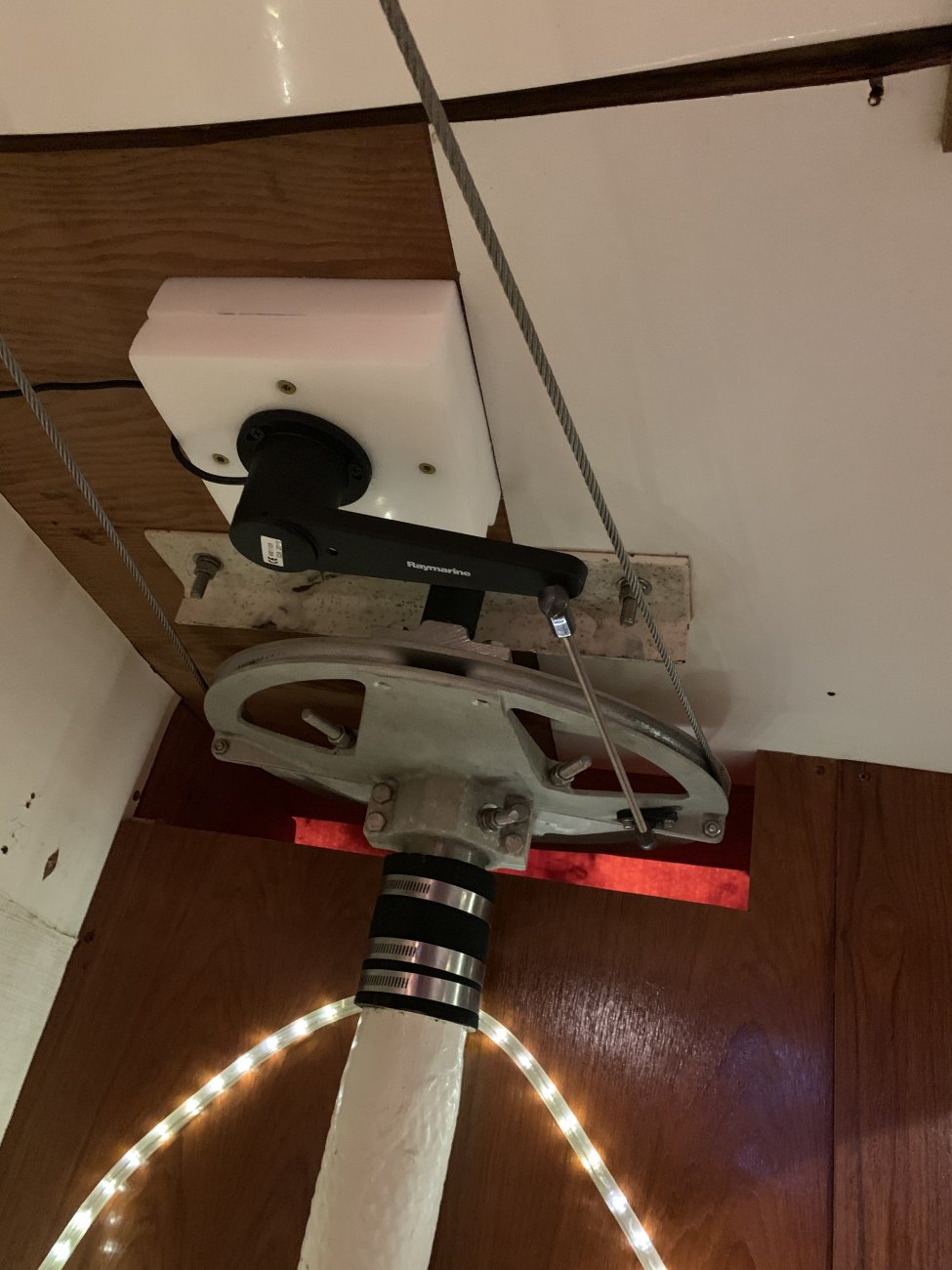

Not a Hunter, but here's what my installation looks like:
Looks GREAT did you do the welding? Unfortunately there is really no spot for the Edison arm under our drive wheel and not sure if I really want to shorten the rudder post housing to install the short arm. I do have a welder, but I think my fabrication should work and save the $800 for the Edison short arm. I would need to weld up a mount if I had installed it in the lazarette. THis is not my boat, but it shows how little room there is on a H34 to install an Edison short arm. I could cut the rudder post, but that would mean that the linear arm would be that much lower into the aft cabin.

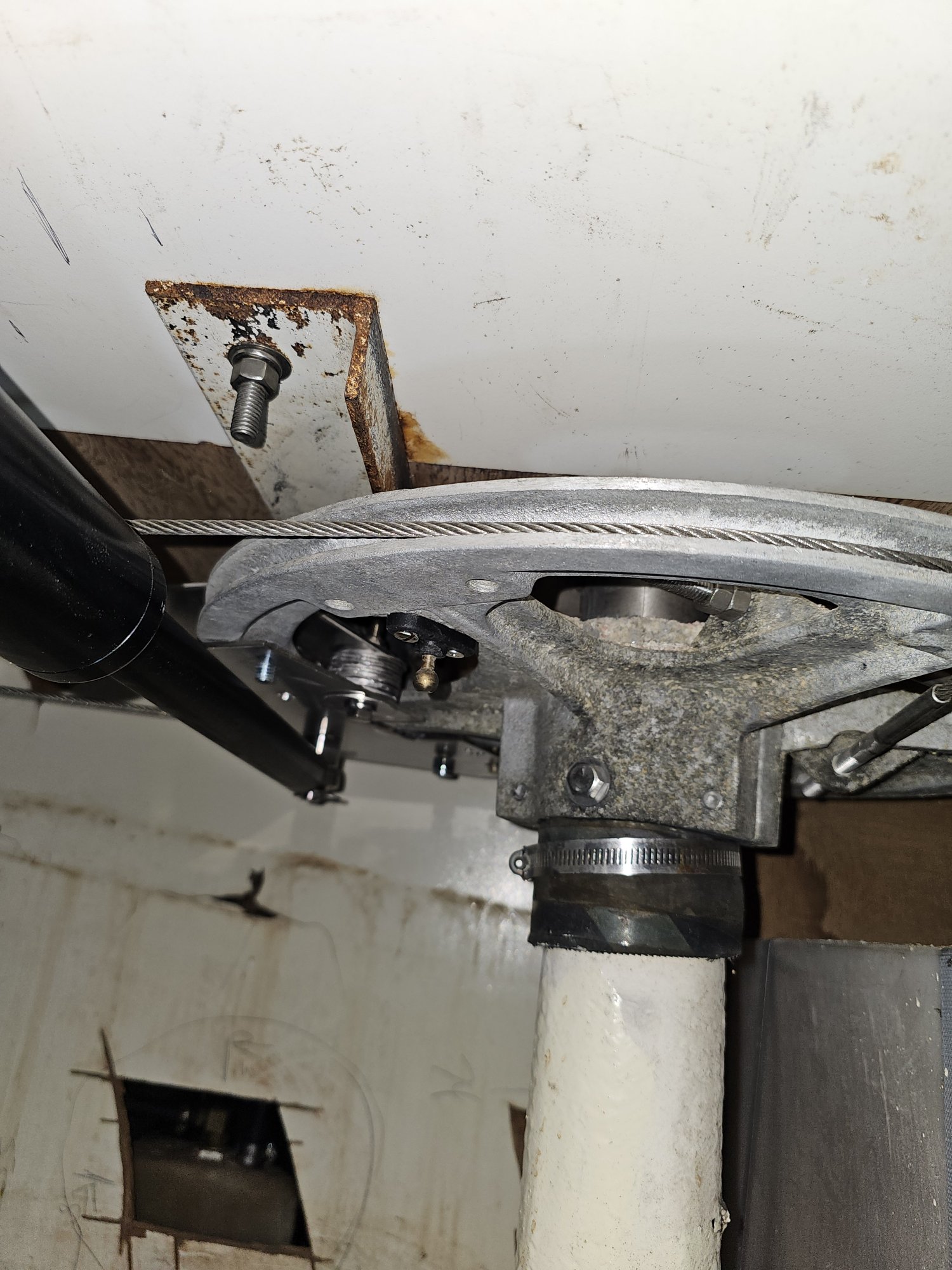

I purchased the type 1 linear drive and rudder angle sensor from Defender. I paid the boatyard a flat rate for the installation. All in for the boatyard was $5800.

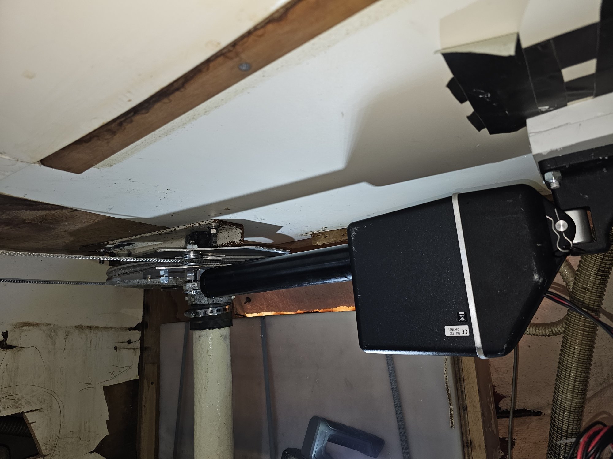

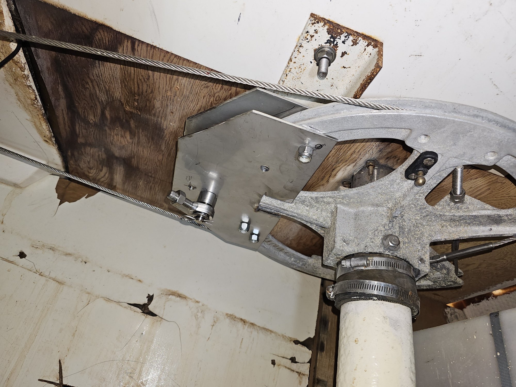

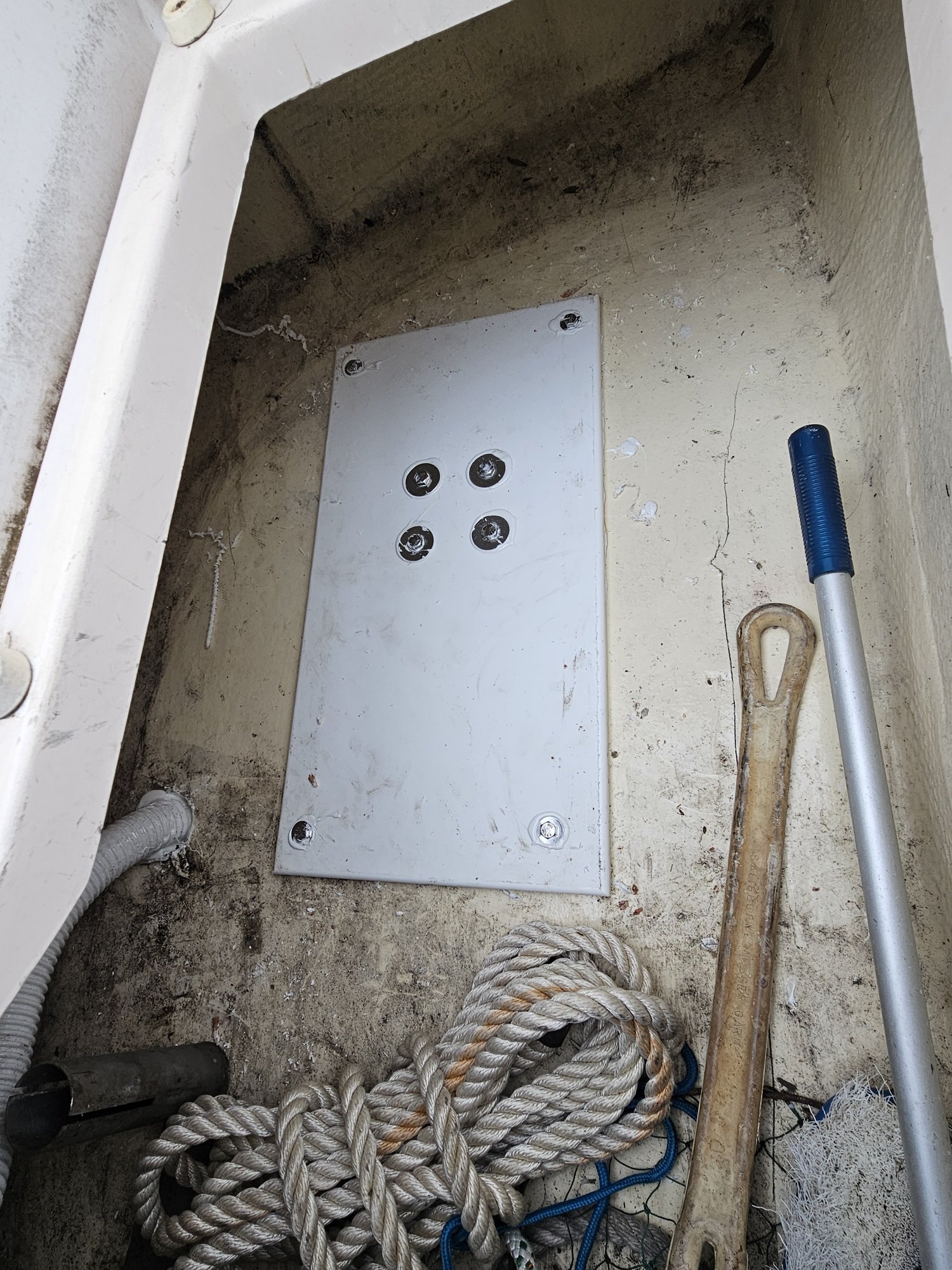

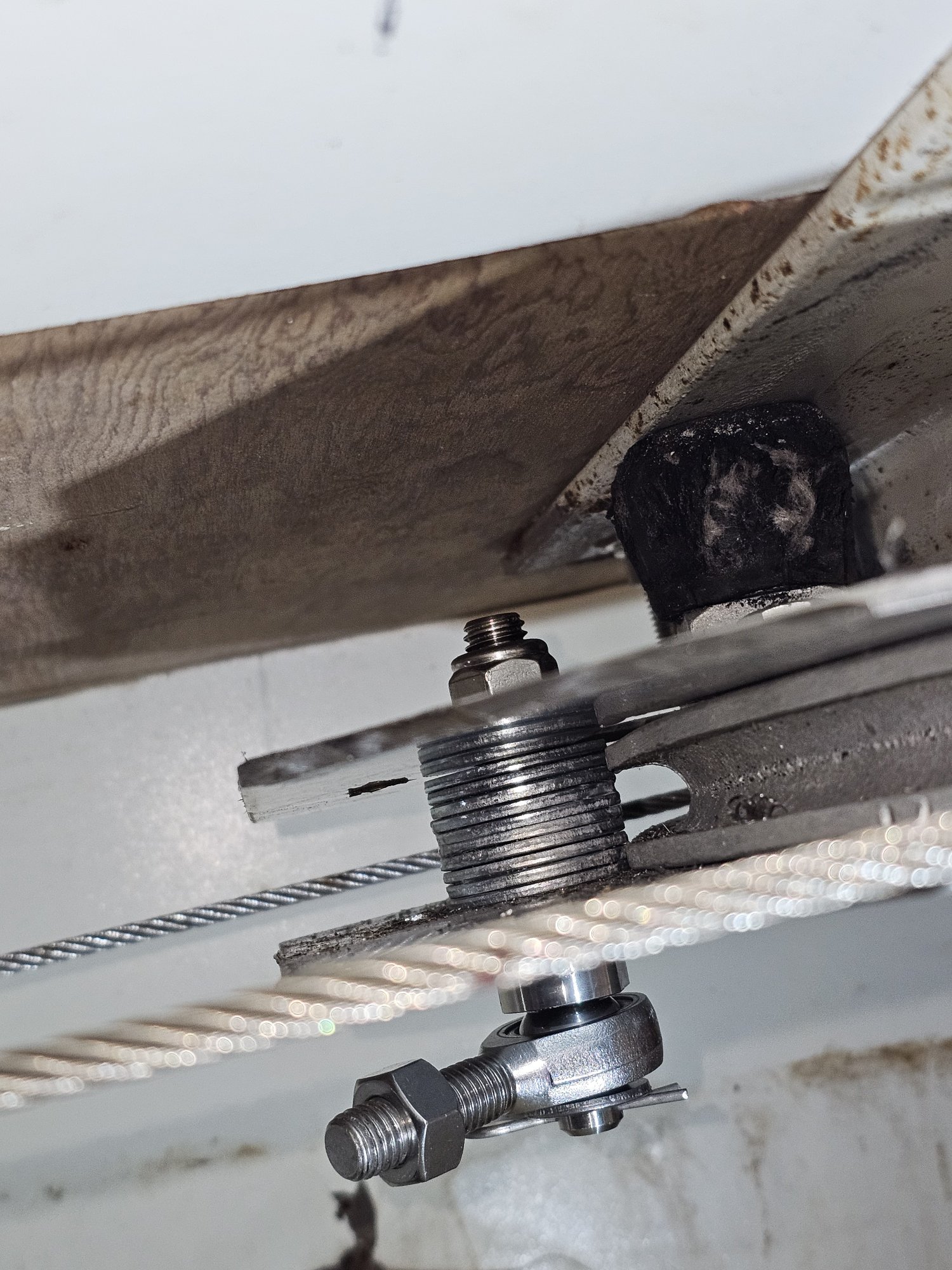

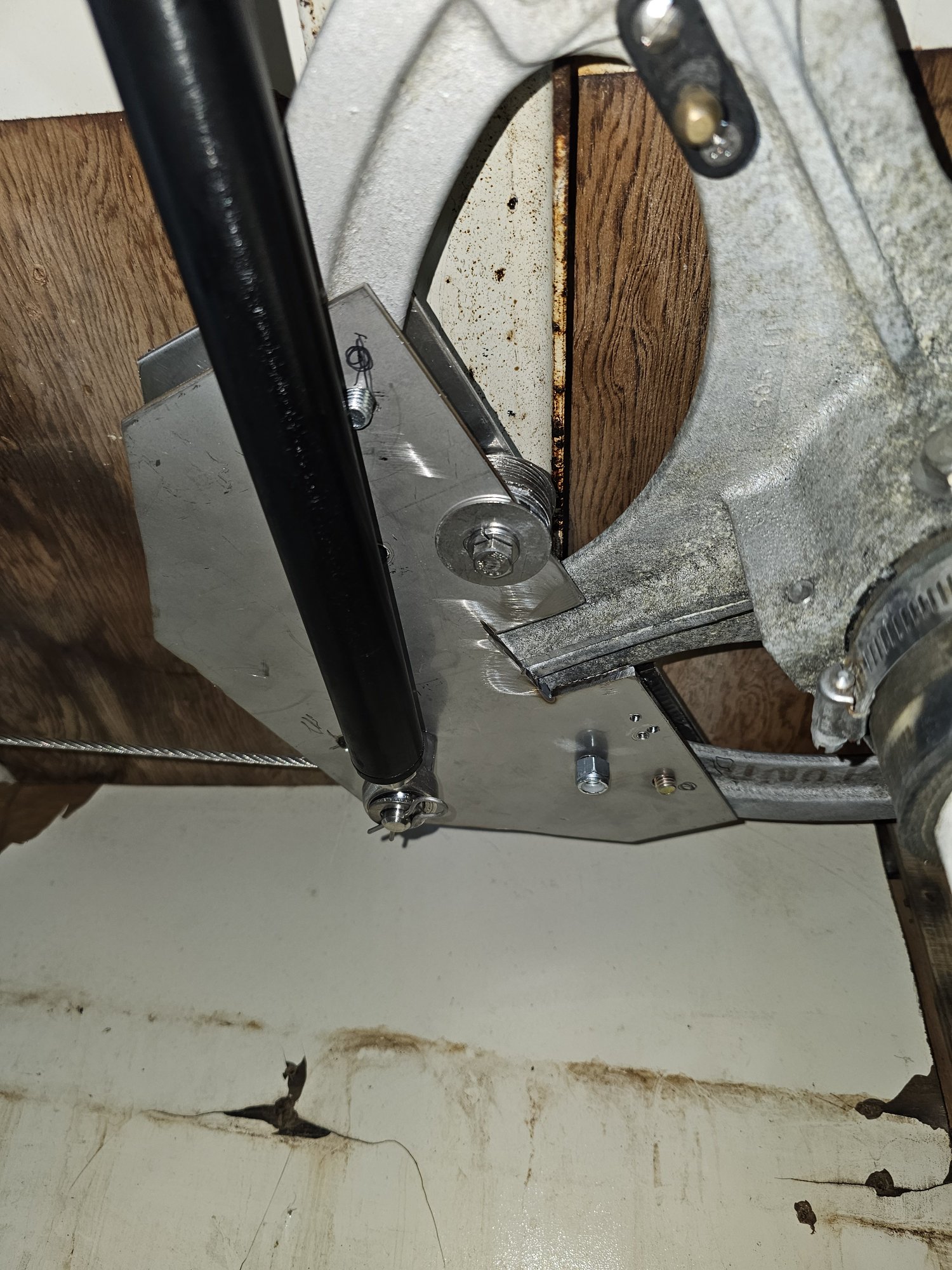

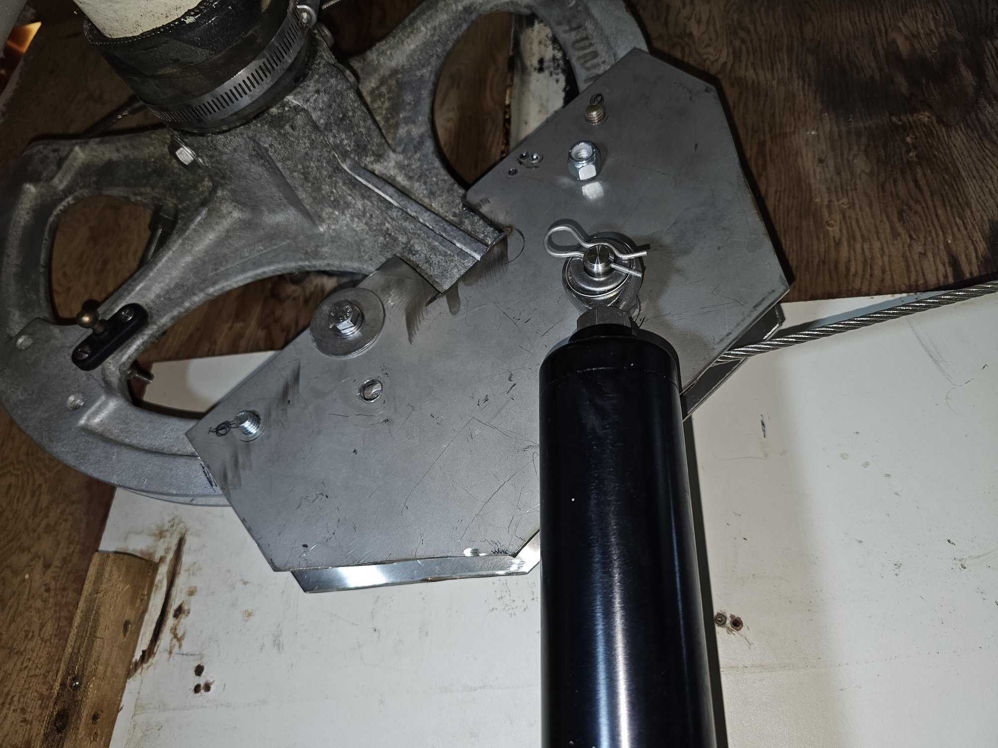

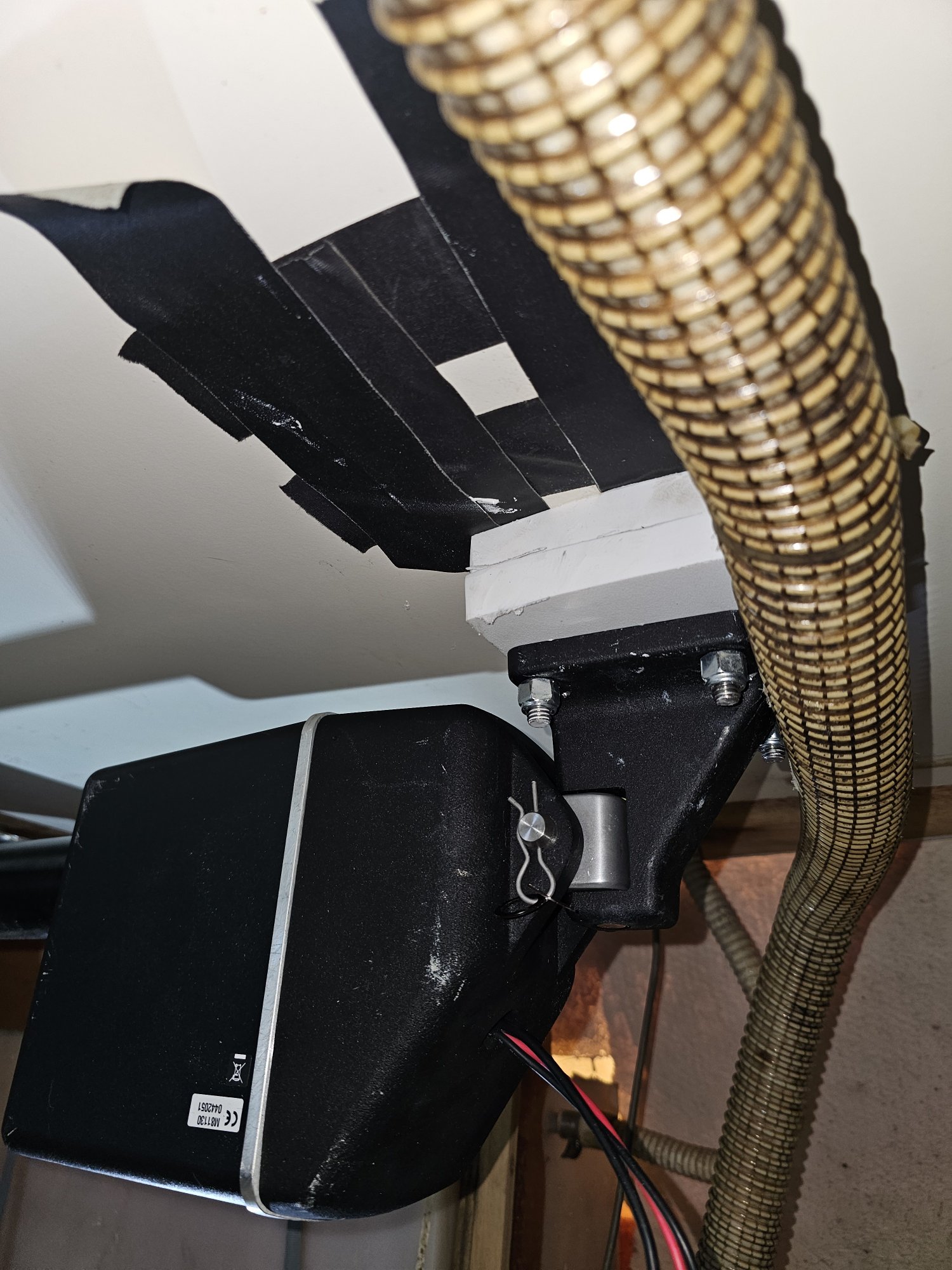

FINISHED! Here are the pictures from my ~$200 install kit to mount the linear drive to my H34 rudder wheel. There was no room to mount an Edison short arm underneath the deck, and trying to mount it in the lazarette would require a welded steel structure or something and take up most of the lazarette. So, I decided to make my own attachment kit with two1/8-inch stainless steel plates (Amazon $29 each), a large 3/4-inch piece of starboard (Amazon $48 much cheaper than you know who), and about $50 worth of stainless-steel bolts, washers, etc. Essentially, I sandwiched the rudder wheel between two the two sheets of 1/8" SS and drilled 4 bolts through the inner rim of the wheel. To properly locate the 4 holes in the rudder drive wheel, position on of the SS plates above the wheel and track the inside of rudder wheel, then move in about 1/4 inch to what would be the middle of the inner wheel and drill the four holes. THEN mount the two plates and drill through the rudder wheel and the second plate. Then instant glued SS washers together to provide a spacer for the drive bolt from the linear arm. I also drilled 2 holes on the very inside and used glued SS washers to offset squeezing the outside of the SS plates.
I installed the 1-inch starboard in the bottom of the lazarette to provide a more secure base for the linear arm mount and two 3/4 inch ~5x5 inch starboard block on the ceiling of the aft cabin to lower the linear arm so that the arm was parallel with the rudder wheel (cut offs from the Amazon 12x27x3/4 starboard). I positioned the linear arm perpendicular to the middle between where the drive bolt was at its maximum aft position (rudder midship) and left and/or right max. This kept the linear arm swing within the max swing requirements.
It may not be the prettiest result, but we were designing as we were building and like Michaelangelo, I did it all on my back.
