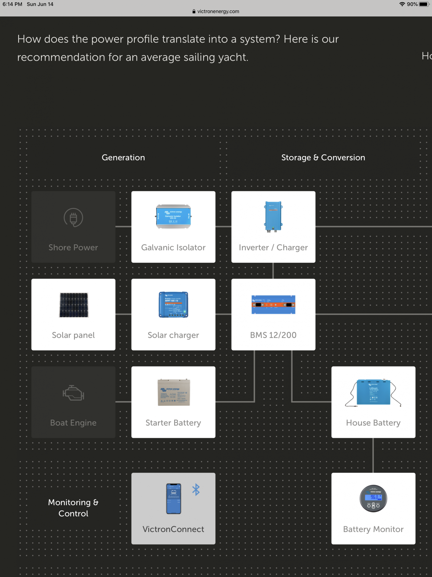

Sometime in the next year I will need to replace my FLA batteries and am considering upgrading to LiFePO4. I have been researching this and finding that the information can be quite confusing. I did ,however, find the attached system recommendation from Victron and I would be interested in any comments on it. I am also interested if anyone has installed the BMS 12/200 unit and, if so, were you able to connect a shore power charger and solar charger.
My boat is a 31 foot sailboat used for short cruises (1 week max) and day sailing. For the most part I charge from solar but have shore power charging if necessary. The alternator is the original installed with my 2gm20f. 200ah of LiFePO4 would be more than enough for my needs.

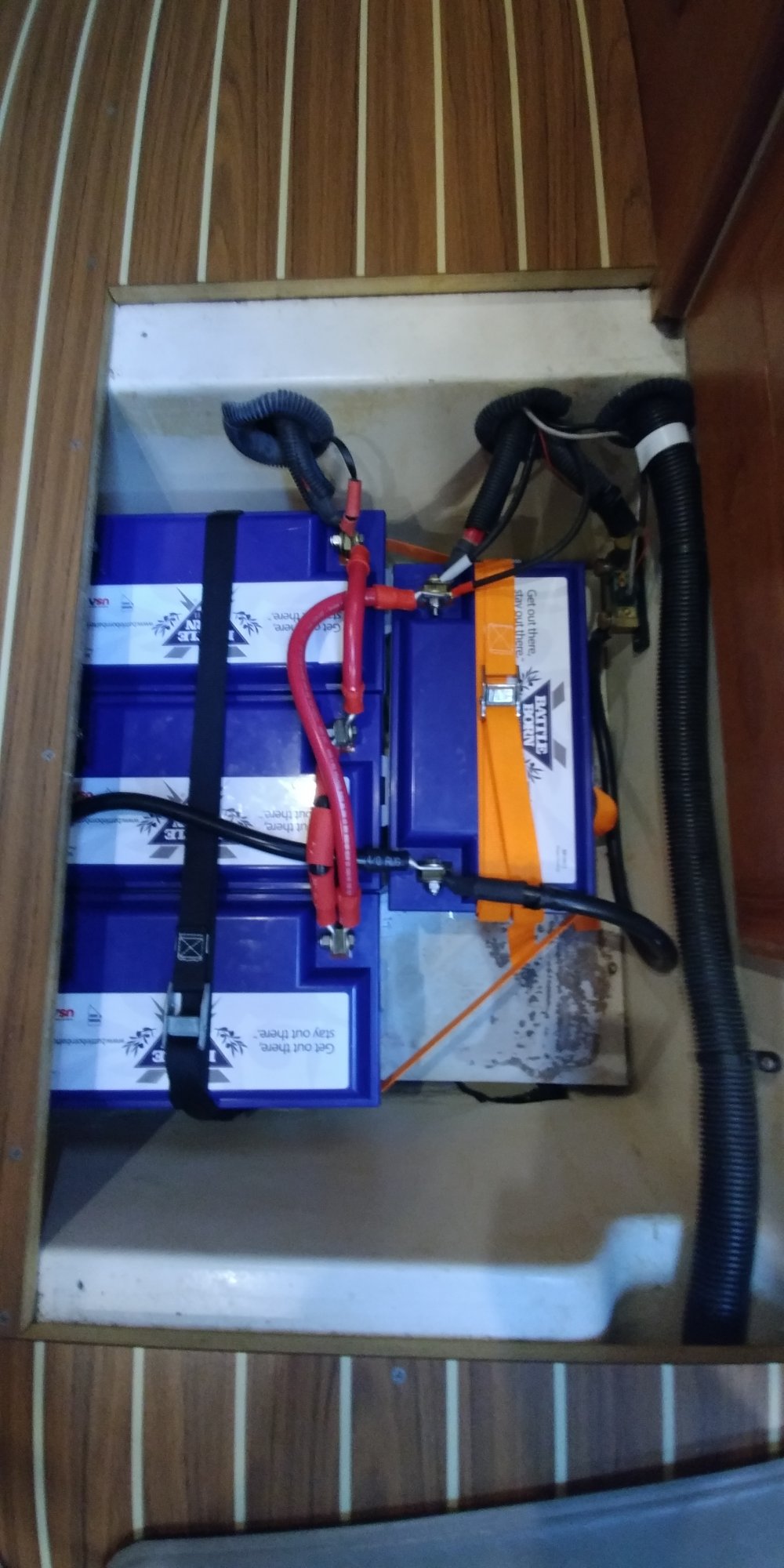

I converted to LiFePO4 about a year and 3 months ago. I went with a DIY system following much of @Maine Sail recommendations. Here are a few things I have to offer:
1) don't consider it if you aren't a bit of a nerd,
2) don't consider it if you aren't a full-time liveaboard on a mooring or anchor,
3) don't consider it if you are not willing to change all components of your charging system (solar controllers, alternator and shore power charger) and,
4) don't consider it if you can't keep lead acid batteries for at least 5 years.
If you're still interested, read the Marine How To article over and over until it makes sense. Then you can start looking at other sources.
Honestly they are a great upgrade, if you put in the time. If you don't, I have met several cruisers who have thrown thousands of dollars away drying to do something other than a full system change. I have even killed a well made, expensive alternator not following all of the recommendations.
