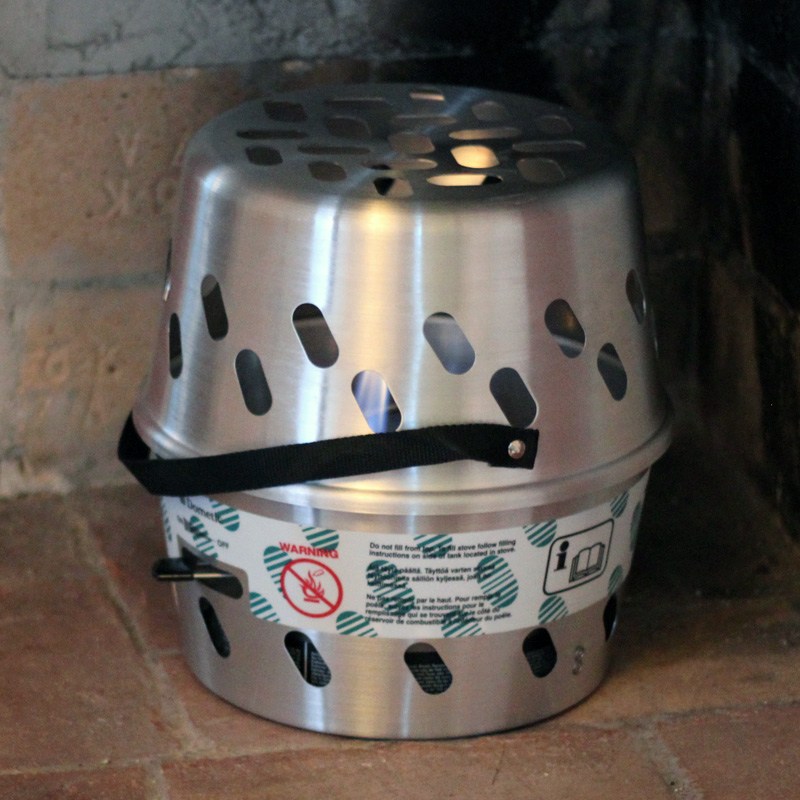

It started me thinking about getting a Origo 5100 Heatpal; I heard they will warm up a small cabin pretty nicely if enclosed. Based on their great stove line, the things are kinda pricey at 200 bucks, but well made.

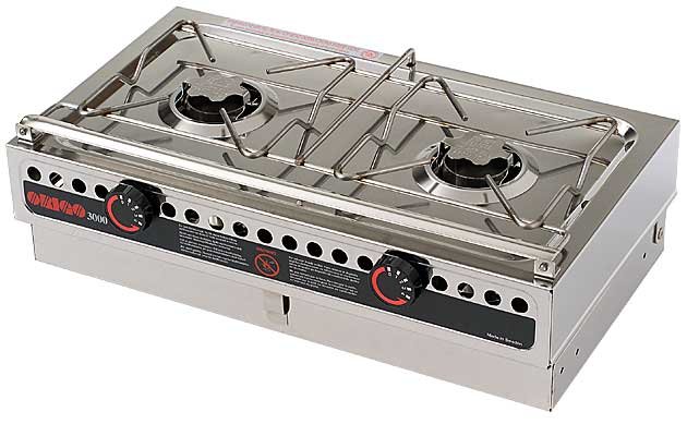

But it occurred to me as I thought about how I would mount it in the pot holders on my gimbaled Origo 3000 dual burner stove, why not just covert one of the burners to heater use??

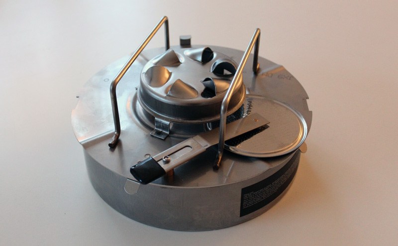

There are only two difference between the two devices 1) The heat defector, on the heater its sorta 'vortex' shaped, and 2) the top, which is really to stop you from being burned.
So I think I'm going to go buy a cheap aluminum pot, and drill a ton of air holes it it. And then clasp it on with the pot holders. We'll see how much the 'vortex' defector makes vs the cloverleaf one that comes with the stove (stock image below), but we'll see. Thoughts???
Here's my theory. The vortex cause the gas (exhaust) to swirl around the chamber heating the sides as well as the top. This will provide more radiant heat than just heating the top of the container.
If you look down the exhaust of a gas hot water heater there are baffles that do the same thing. Get the exhaust gas swirling and extracting more heat.

The other big difference between the Origo Heat Pal 5100 and the 1500/3000 cooker is the size of the exposed wick opening on top of the fuel canister. I tried the clay pot on a single burner Origo 1500 but the heat output was a bit low and clay pot cracked so I bought the Heat Pal 5100 and things improved. The best was adding wiring a refactory brick across the top of the Heat Pal auxiliary pot supports. It is nice that it is low on the cabin sole but put an anti-skid mat under it. I now use a small bulkhead mounted Cozy Cabin heater with a self powered Coframo fan.
