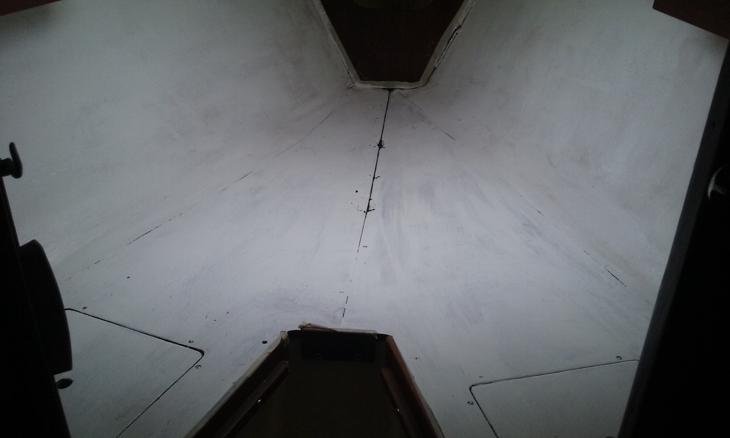

Hi All
I just got a O’day 27. The v-berth isn’t in very good shape and my wife won’t stay over night in it until it’s been made “sleepable”
Any advice on what some of you have done to re do your v-berths? I’ve given the floor and walls a fresh coat of paint. Walls still need yanother coat. Then was planning on painting white and navy blue stripes across the walls. Any advise on lighting or anything else? We are going to buy a memory pad to put in there too
Thanks in advance

Instead of painting stripes, you might consider teak pre-glued edge banding. Ironed on it gives you a nice warm wood effect. I used 1.5” wide to match what Oday already used. The surface needs to be smooth and fairly flat, but it looks like you’ve accomplished that. Good luck.

I would add good reading lights and a fan for ventilation. Memory foam is a good start but you may need to put something under it if you are a high humidity area.

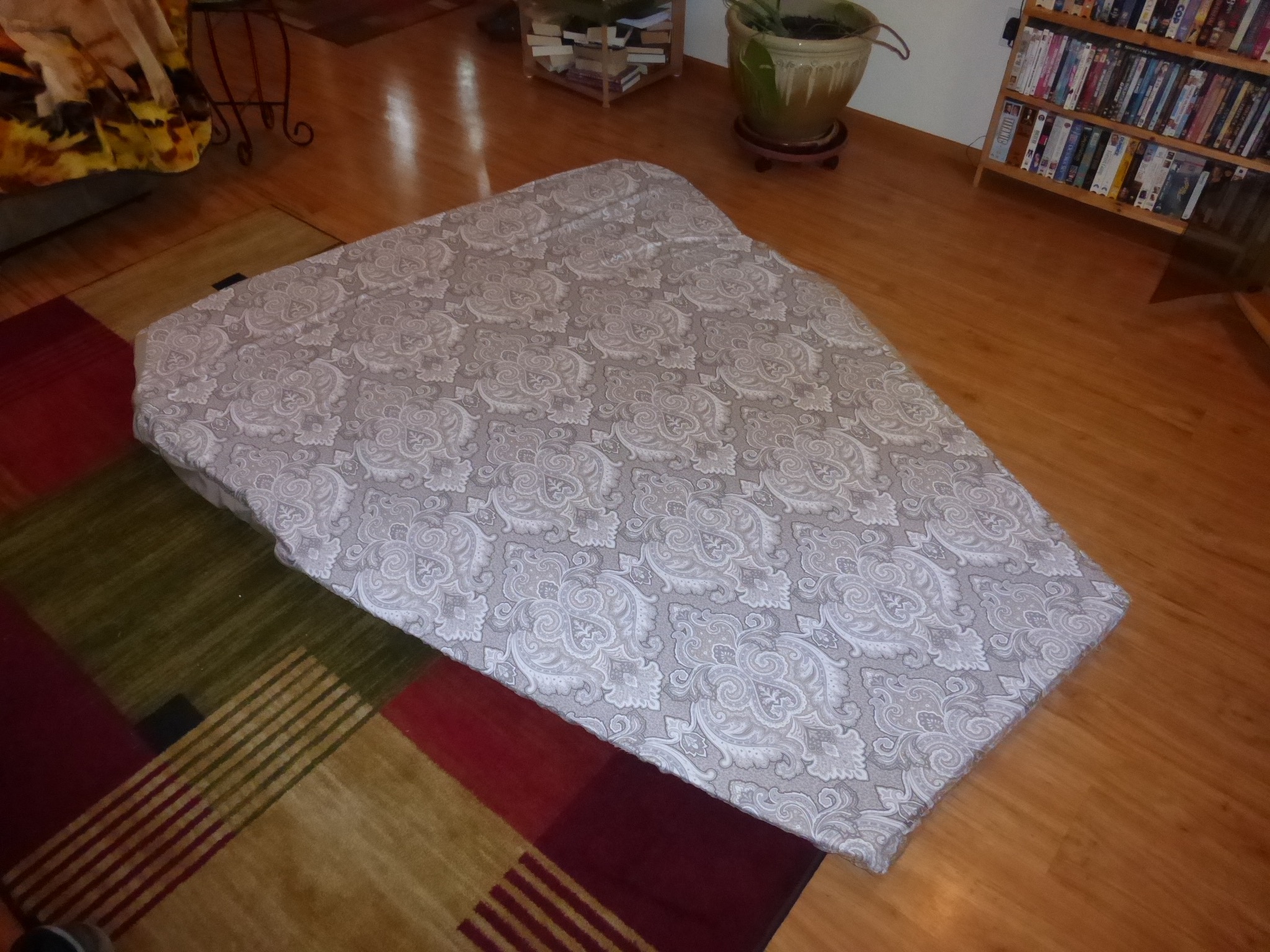

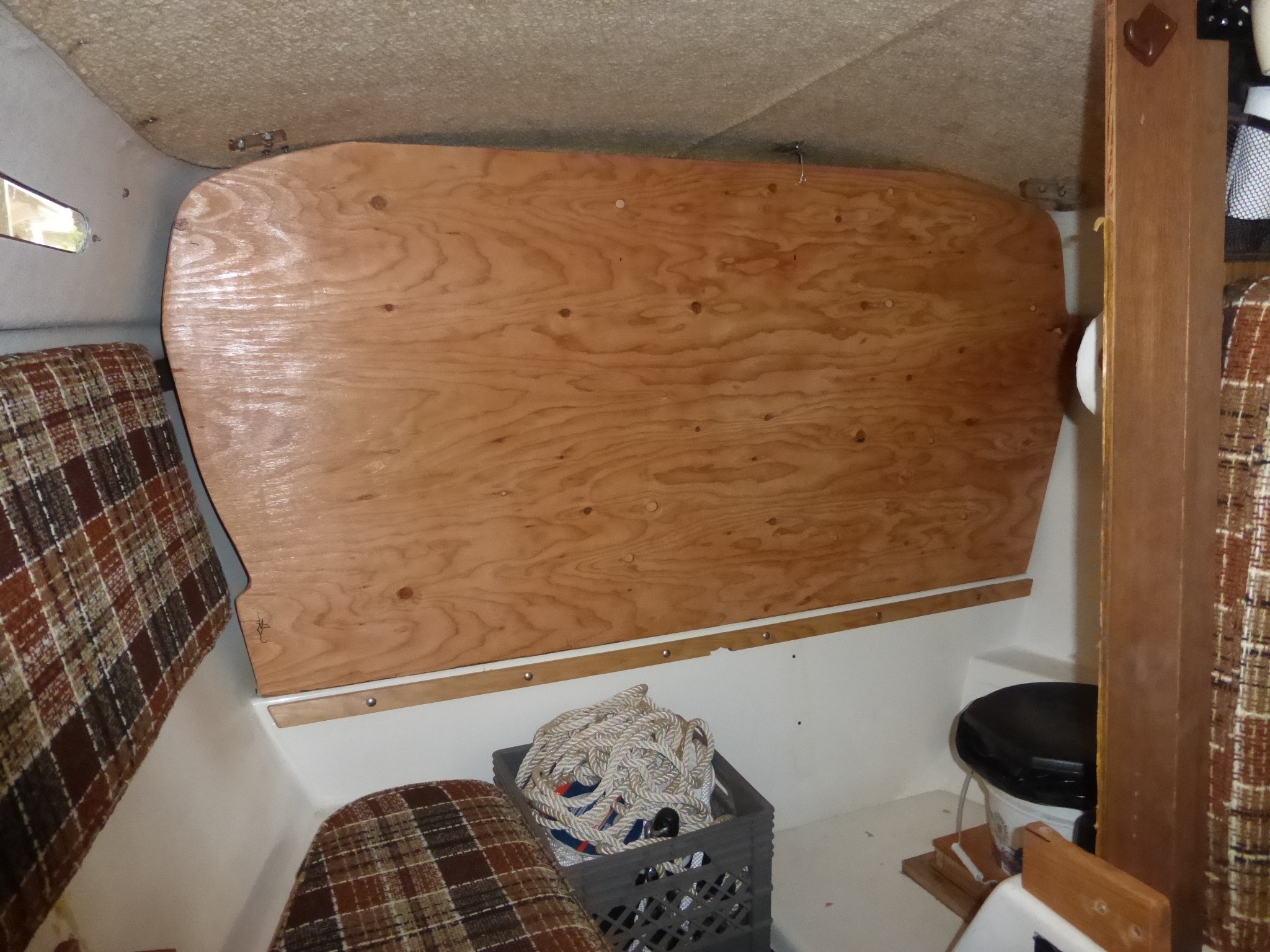

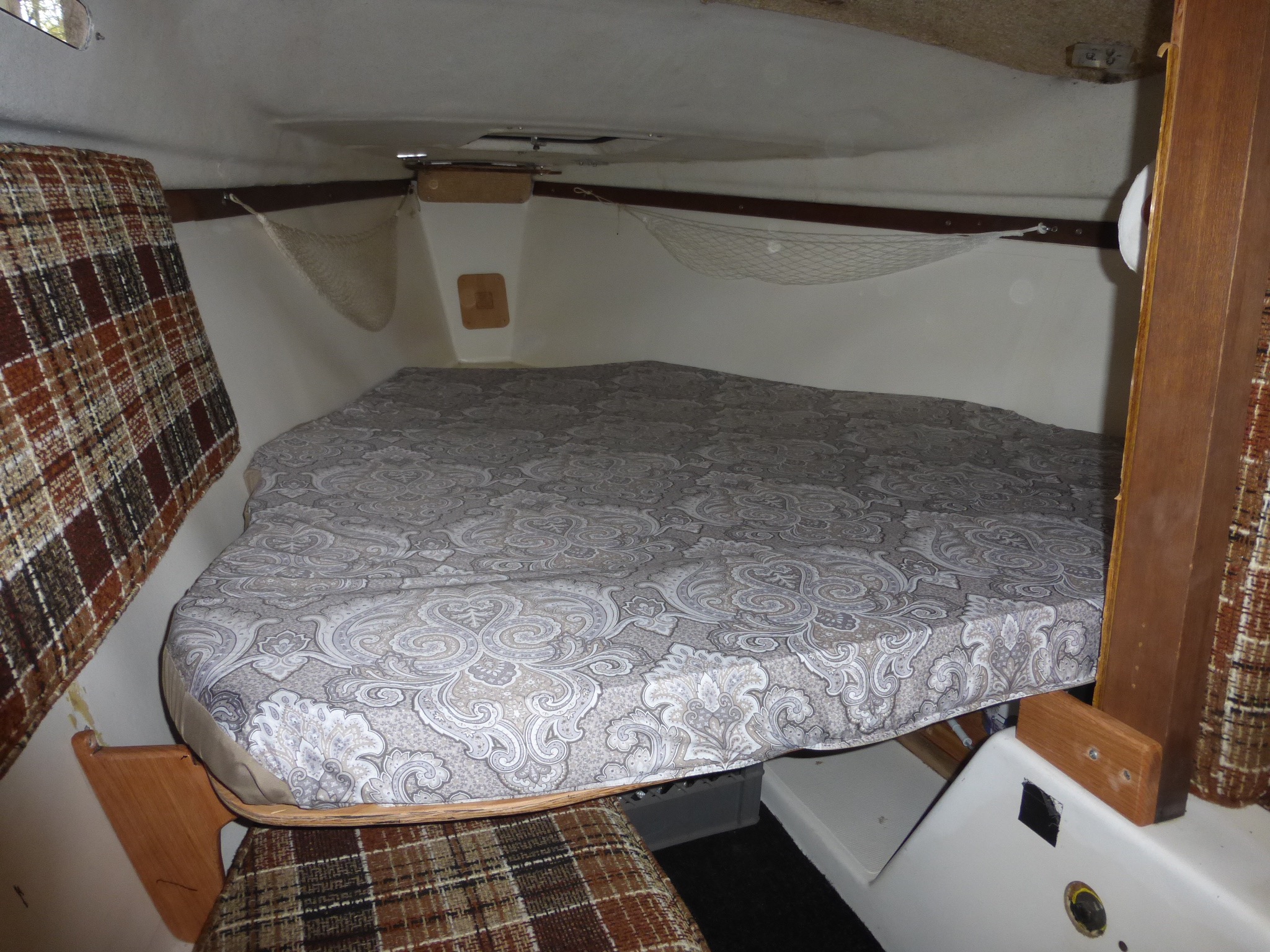

I've added a hinged extension to the v-birth in our M25, mostly to gain headroom width (we sleep head forward). some was taken off the queen mattress sides up in the V, and those pieces added (glued) to the sides near the foot before beveling the sides for a full fit in there. The wife made the custom fitted sheets. The mattress only comes out in the winter and I've had no problem folding it in half, lengthwise with a couple ties around it, to extract. cutting foam is quite easy with an electric meat cutting knife. available at every yard sale for ~$2.00 ;) .
