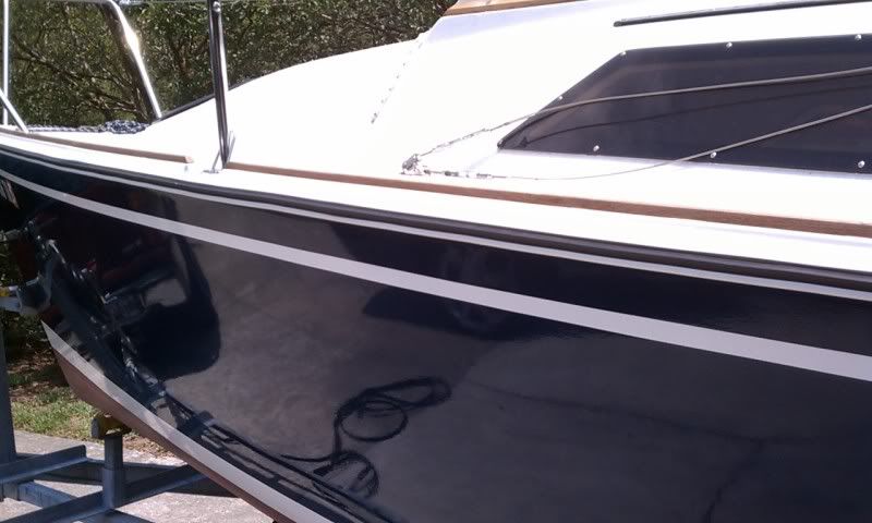

One thing I recommend is if you feel like you are having trouble with one aspect of the build, move onto something else. I had it in my mind that I had a certain order in which I had to do things. Painting the hull had to be done before I moved onto anything else. Murphy paid several visits and I just got burned out. When I finally got back to it I painted the deck. Since white was much more forgiving and the kiwigrip went down well it provided the motivation I needed to move on.

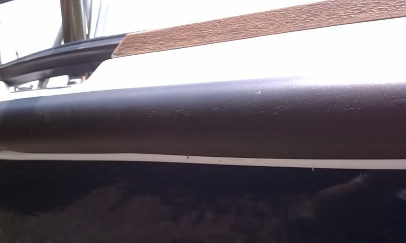

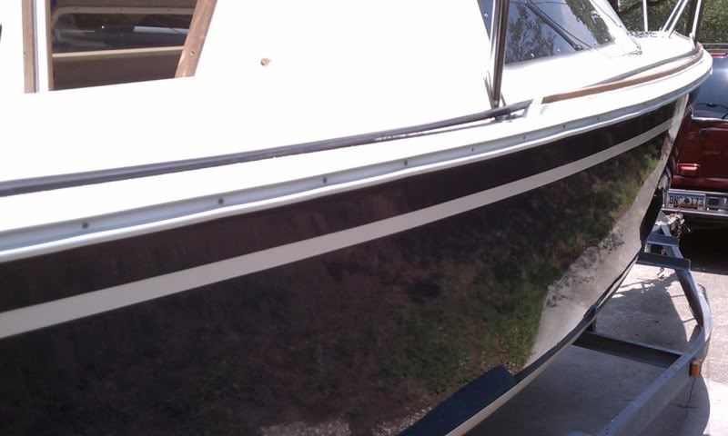

Looking at your pictures, have you applied a gunwhale (edge guard)? We applied a replacement to our 22 this winter and with a little patience and practice the new application went smooth... Purchased from D&R Marine...

Yes I have some ready to go on. Just need to get the boat out of the water and finish a few more things up. I got the semi rigid made by taco. Hopefully I didn't mess up. It is still pretty stiff but nowhere near at stiff as the rigid.

Do you have a reference for the type of rub rail your are using from Taco?

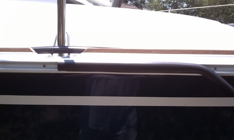

Funny you should ask this question. I was just getting ready to post about the rubrail installation.
What I bought
http://www.jamestowndistributors.co...ilyName=TACO+Marine+Semi-Rigid+Vinyl+Rub+Rail
The insert looks like an inner tube on my boat. It may look better on a different colored boat.
The size covers up any waviness, but I got my old insert and I'm using that. I screwed and glued with 4200. If I were to do it over again I would get the rigid for a couple reasons. The size of the insert most of, much less likely to have waviness, conform to the corners better. Even so, I think what I've got should last as long as I plan to keep the boat.
With my old insert. The only time you notice any waviness is when you sight down the boat. Looking straight on it looks pretty good.

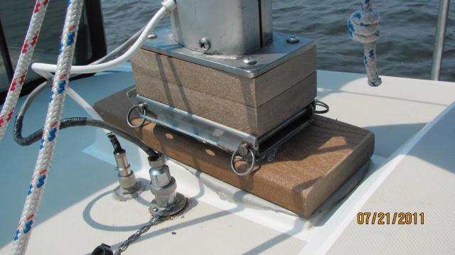

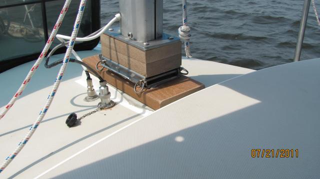

Oh OK. He was asking about Trex. I think you were the one who gave me the idea of using Trex to replace the Teak under my mast tabernacle. I did that job a couple of weeks ago and it came out great.
In fact, I had to cut 2" off the bottom of my mast because it was all corroded and ready to blow out. Rig-Rite had made up a stainless steel mast plug for the stainless steel hinged tabernacle they installed. Through the years, the two metals set up corrosion.
I took my mast to a marine fabricator on the river and the guy quoted me a price of $300 in labor for sleeving a piece of mast and welding flat stock around it. :eek: So I went home and thought about it and decided to have my son cut 2" off the bottom of my mast and I made up the difference with two 1" pieces of Trex between the tabernacle hinge plate, and the mast plug. I gave the 2" piece of my mast to Rudy and he's going to have some mast plugs made up for the Z-190 masts and hopefully made out of Aluminum. So the Trex under my mast tabernacle plates is permanent but the Trex in between the top plate and the mast plug is only temporary. I'm going to need to make up 2-1/4" in order to get my stays to come right when I get the new mast plug from Rudy.
Right now, my mast looks kind of "fugly" but she sails great! Sometimes you need to just "think outside of the box."
Joe
