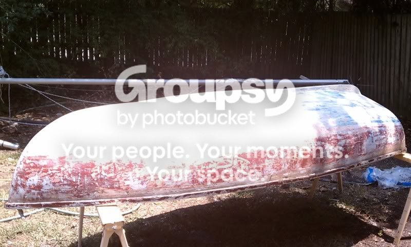

One thing I recommend is if you feel like you are having trouble with one aspect of the build, move onto something else. I had it in my mind that I had a certain order in which I had to do things. Painting the hull had to be done before I moved onto anything else. Murphy paid several visits and I just got burned out. When I finally got back to it I painted the deck. Since white was much more forgiving and the kiwigrip went down well it provided the motivation I needed to move on.

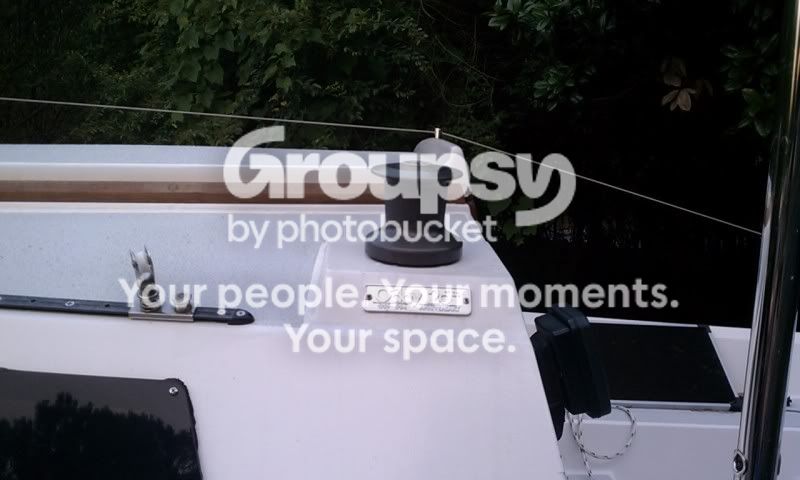

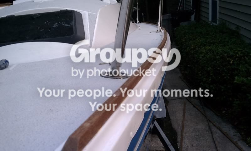

Looking at your pictures, have you applied a gunwhale (edge guard)? We applied a replacement to our 22 this winter and with a little patience and practice the new application went smooth... Purchased from D&R Marine...
Regards, John

Yes I have some ready to go on. Just need to get the boat out of the water and finish a few more things up. I got the semi rigid made by taco. Hopefully I didn't mess up. It is still pretty stiff but nowhere near at stiff as the rigid.

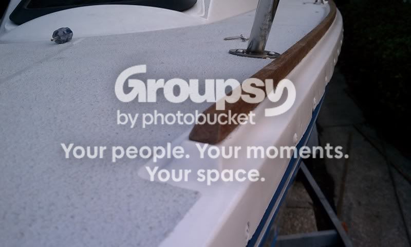

I think he was asking about the ipe that I used. If so, ipe is an extremely dense and heavy wood usually used for high end decks. Really has beautiful grain and color. Both when stained or left natural (turns silver). I'm still monitoring it on my boat. Some seems to be doing OK, some is checking worse than I wanted but still in one piece. I varnished one piece of toerail to see if it holds up better and it does seem like its doing a little better, but I wasn't really looking to varnish my wood. It machined really well, but nearly impossible to sand (hence the other name of Ironwood). When I redo the wood I'll probably try using one of the solid trex-type materials. I've seen it used for handrails and it looks pretty decent after "kissing" it with a propane torch.
