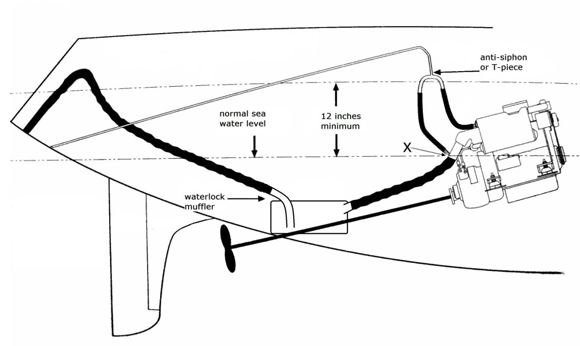

Just a question and it may have not been shown in the pictures, but isn't the exhaust supposed to have a turn up at the exit point above the water line to prevent any siphoning
