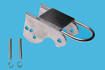

This. We use an ATN mast climber on the main halyard, but tie into all available halyards as backup. However, our boat has a spinnaker crane and I wonder what it's limits are relative to a direct downward force experienced when using it as a primary ascension point.
24,764
You are spot on @berner73.
You need to assess your hardware and know what it can and cannot do. On lighter boats the use of the main sheaves is likely the best options. The forces are supported. The crane on a spinnaker halyard is designed to deal with pulling forces, not downward forces.
The image of the crane, looks like the welds will hold but 200 lbs might bend the crane.
