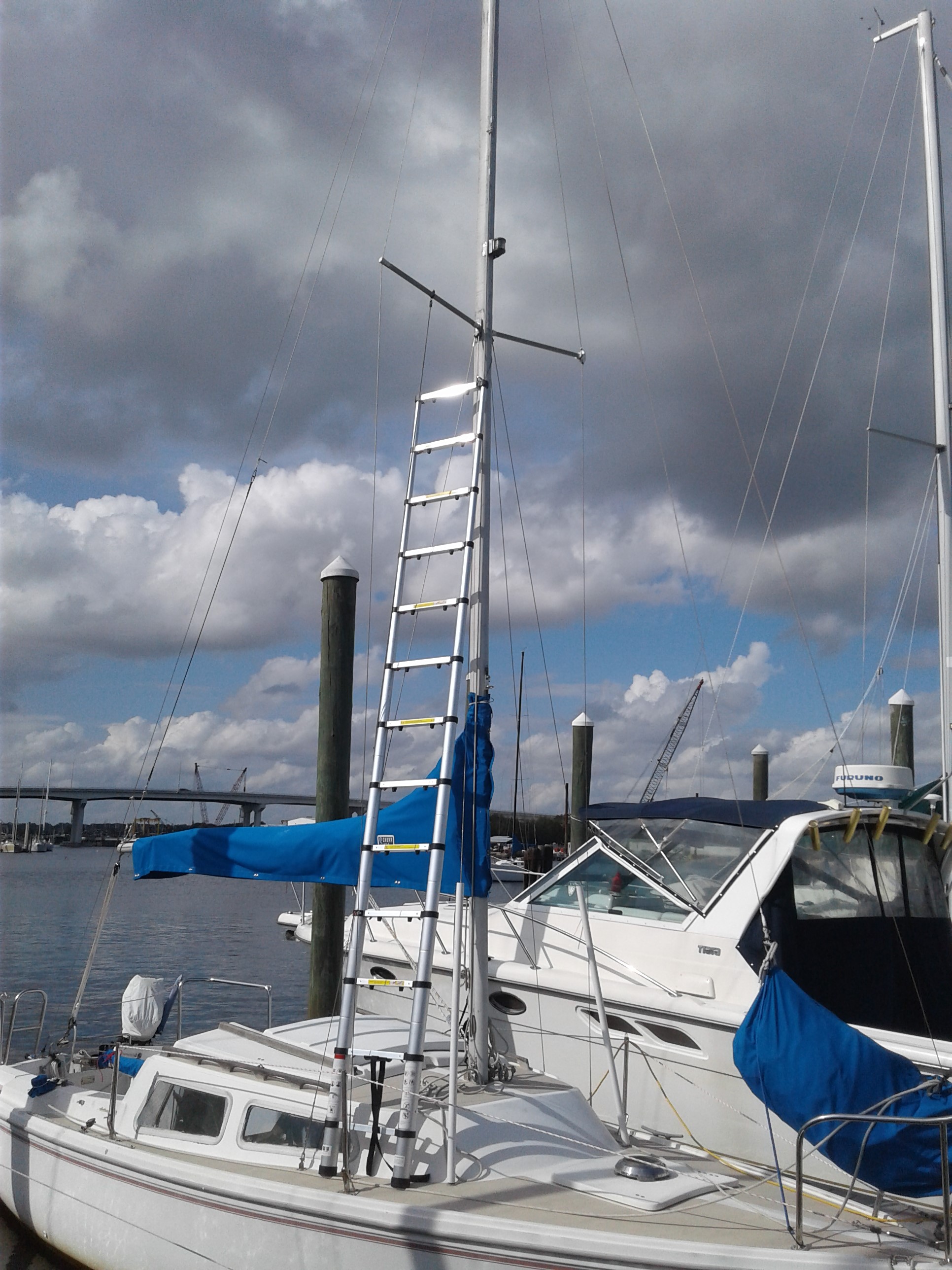

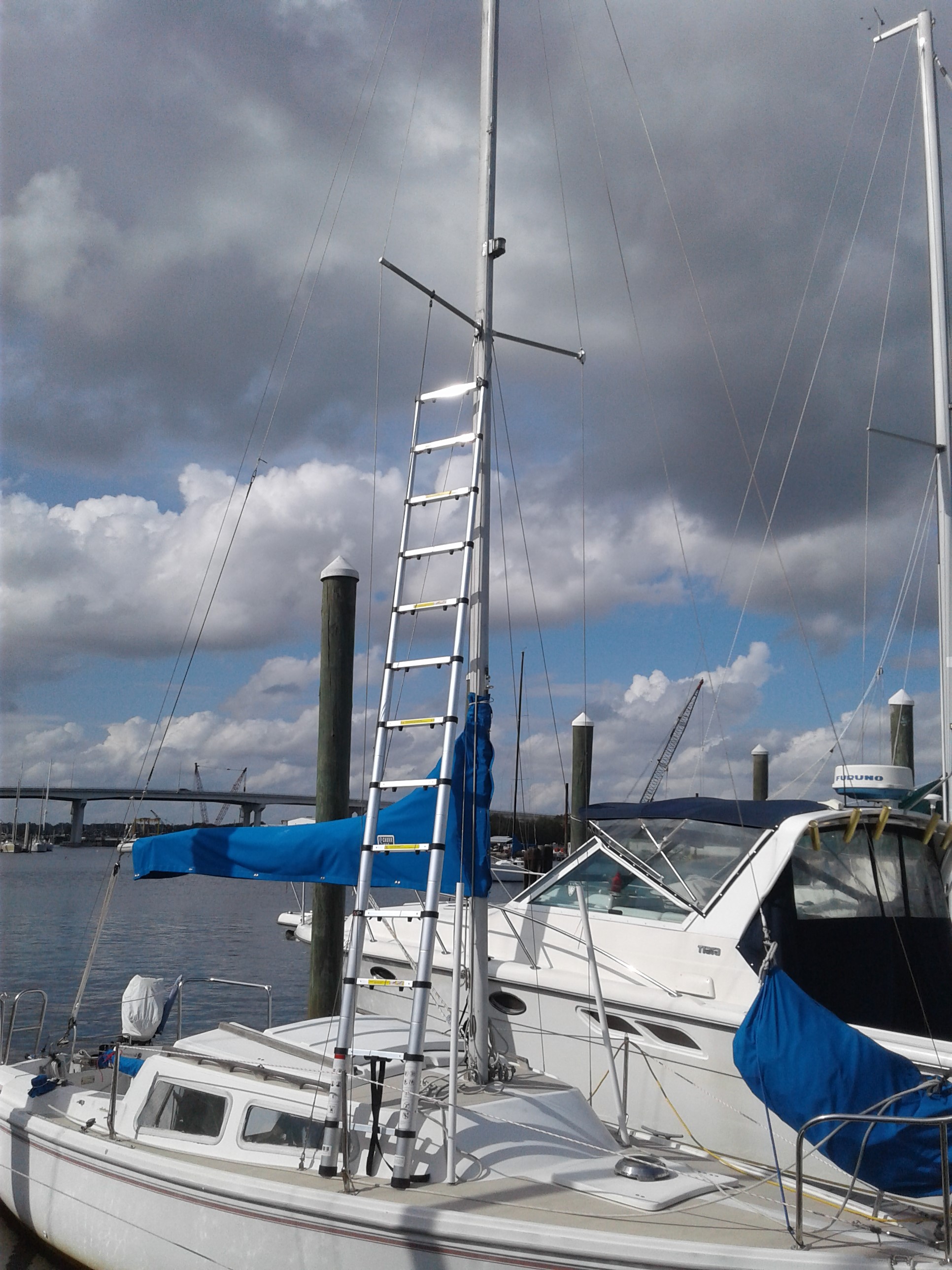

If you look real close you will see I anchored the top with the jib halyard on the top rung. Did not move with the ladder neatly jammed inside the lower shrouds. But fastening the zip ties around the spreader boots one handed (one hand for boat one hand for work! rule) was a little challenging.

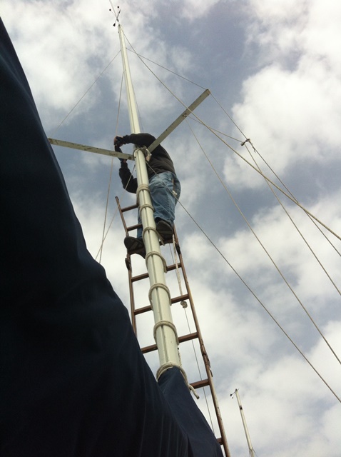

Although old school use of ladders was to use a ladder on small boats, as a dealer I dropped all masts on Precision,Hunter,Beneteau, Catalina, MacGregor and others. I have seen accidents of owners using ladders that resulted in injuries but what got my attention was a black body bag with a body going past me on a stretcher headed to the morgue. I urge extreme caution in the use of ladders as I was never a fan of them going up masts

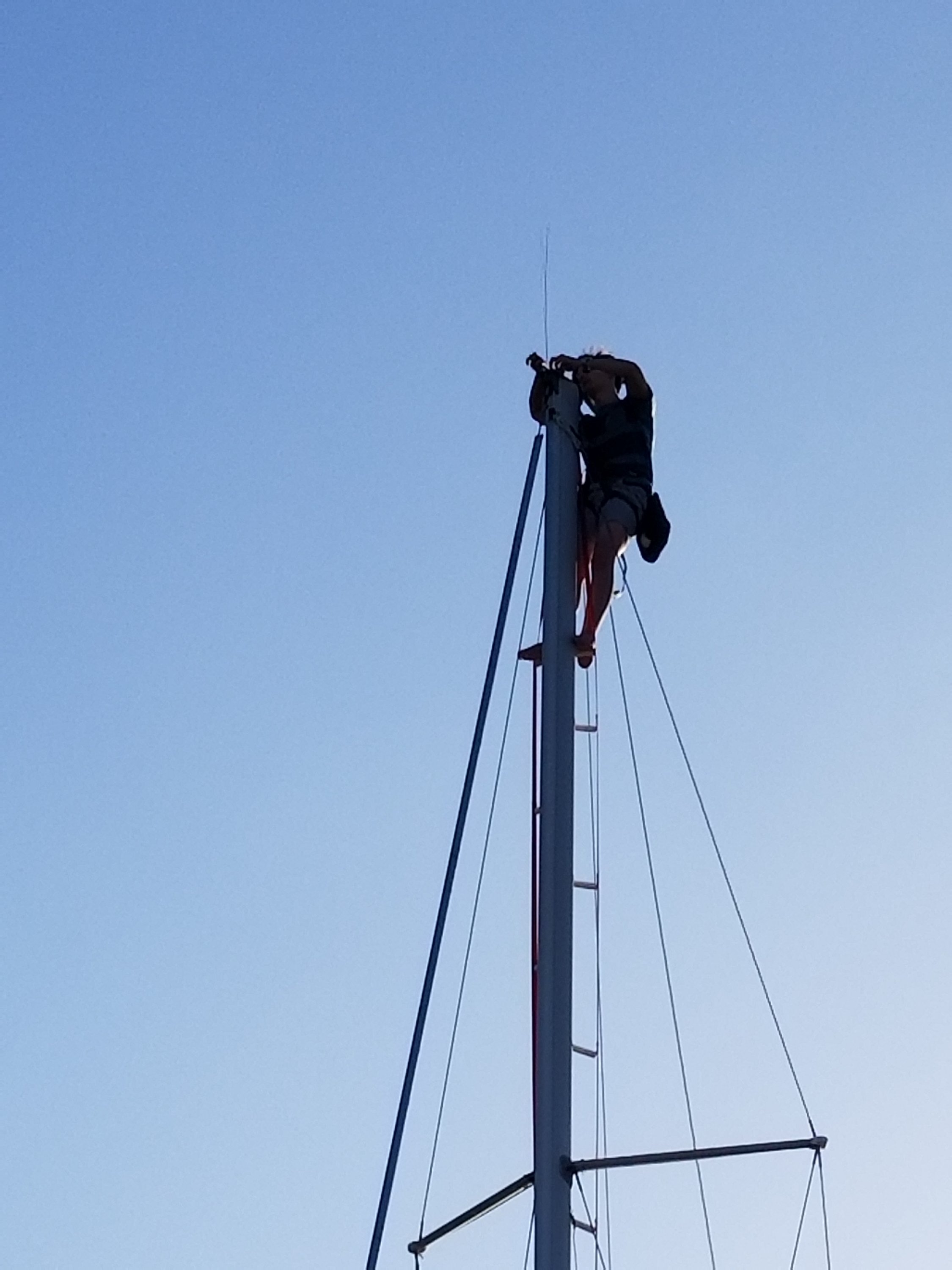

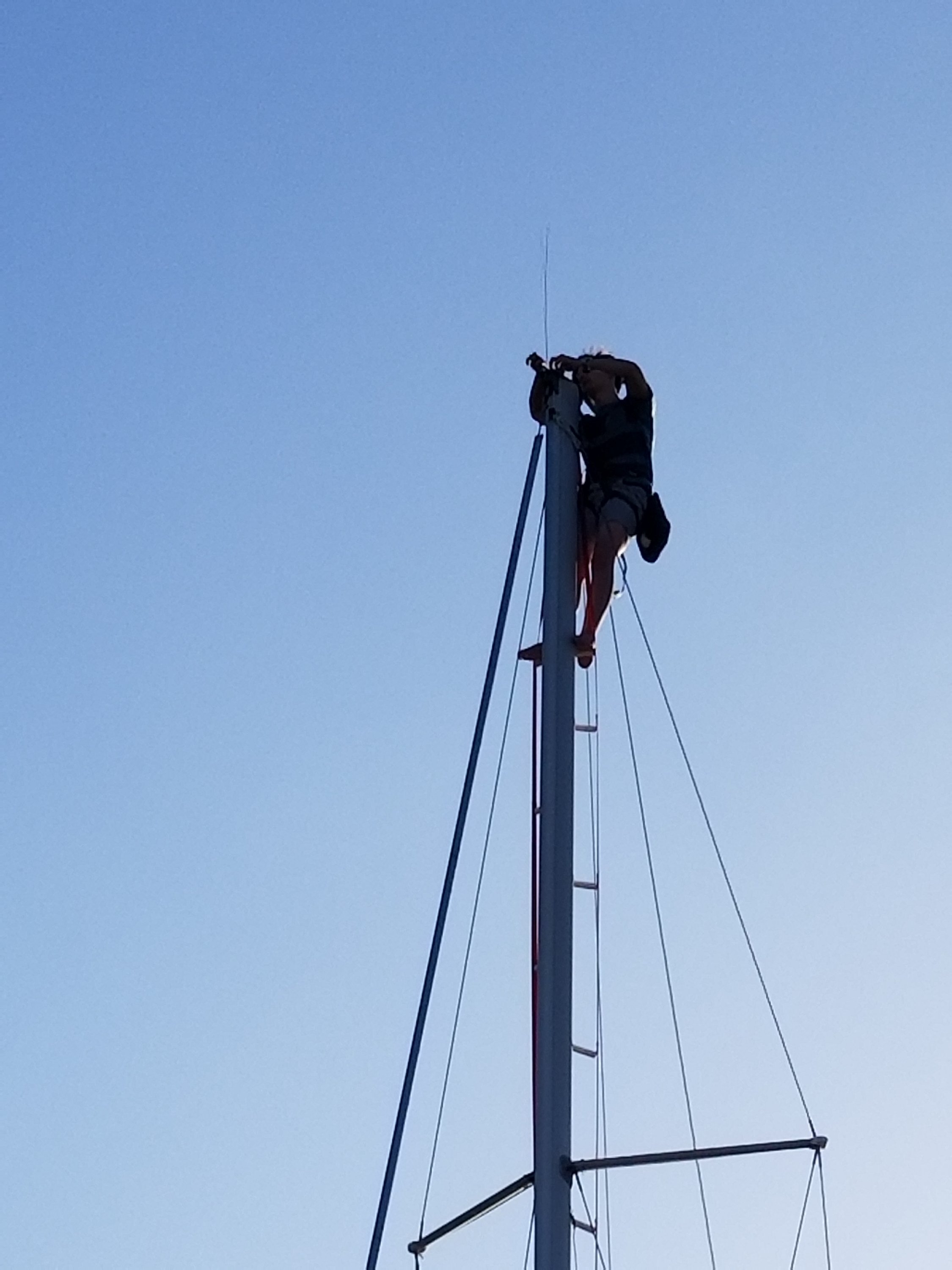

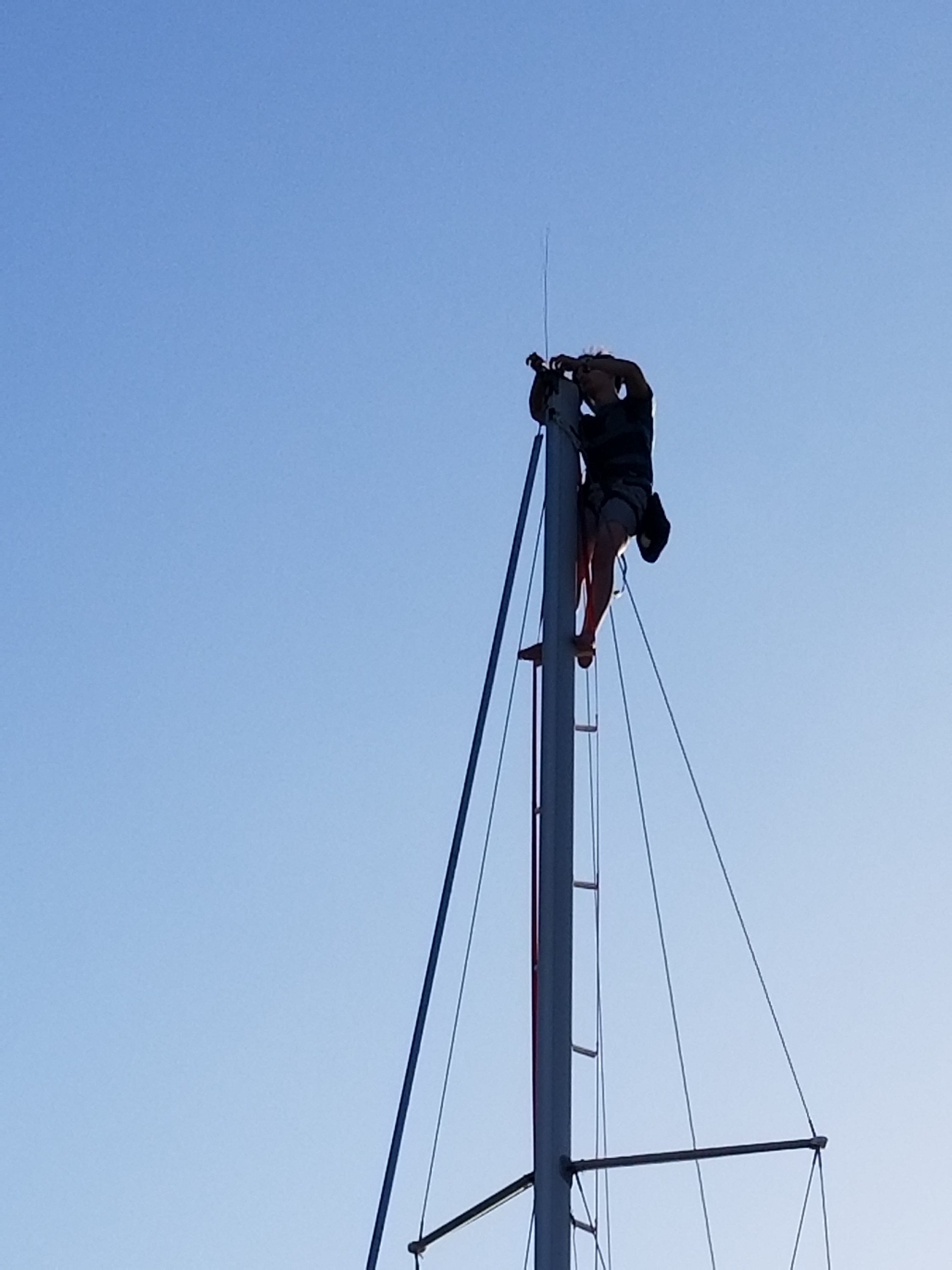

I have been having my 18 year old son go up the mast using something similar to a mast mate.

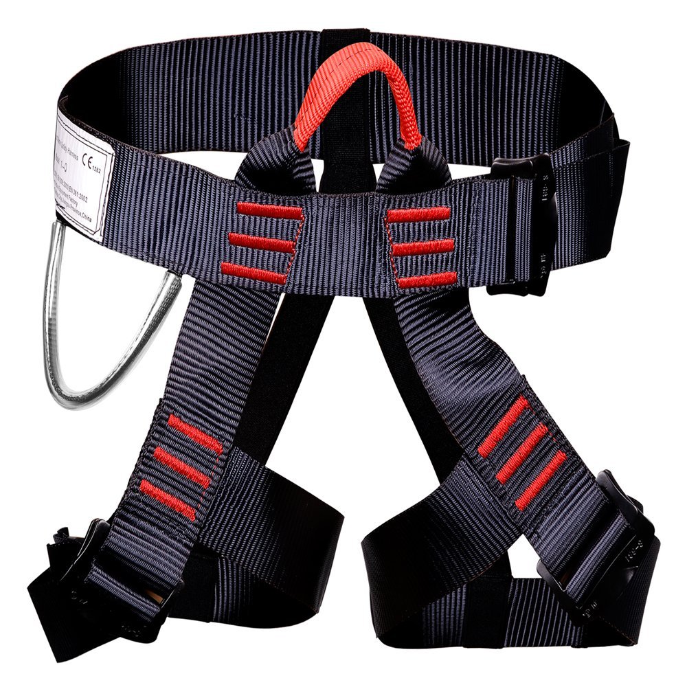

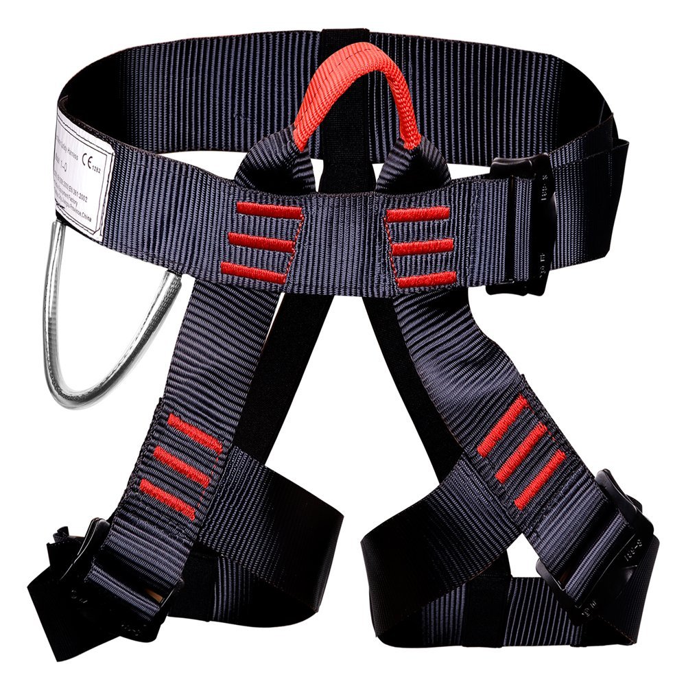

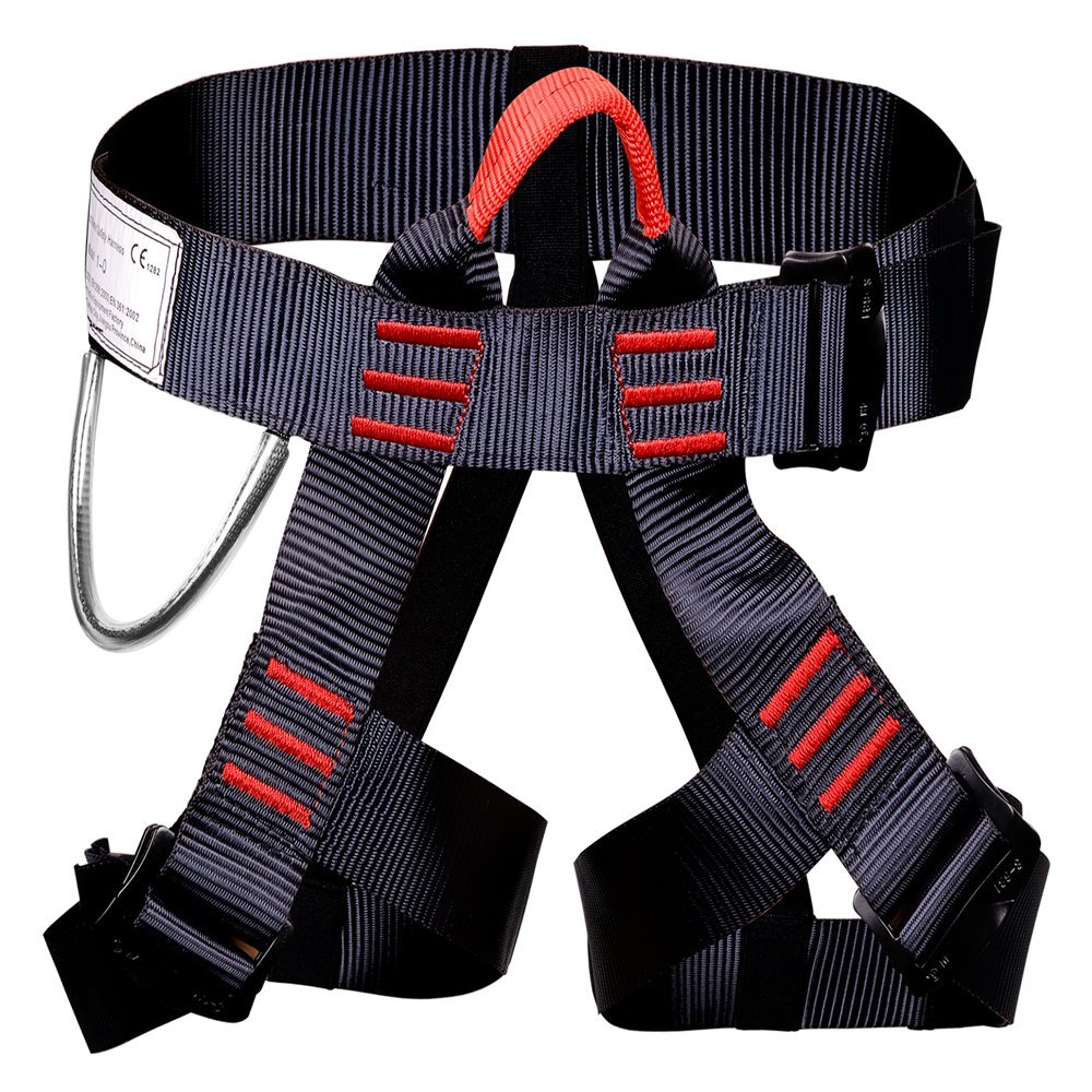

Along with a climbing harness like this:
