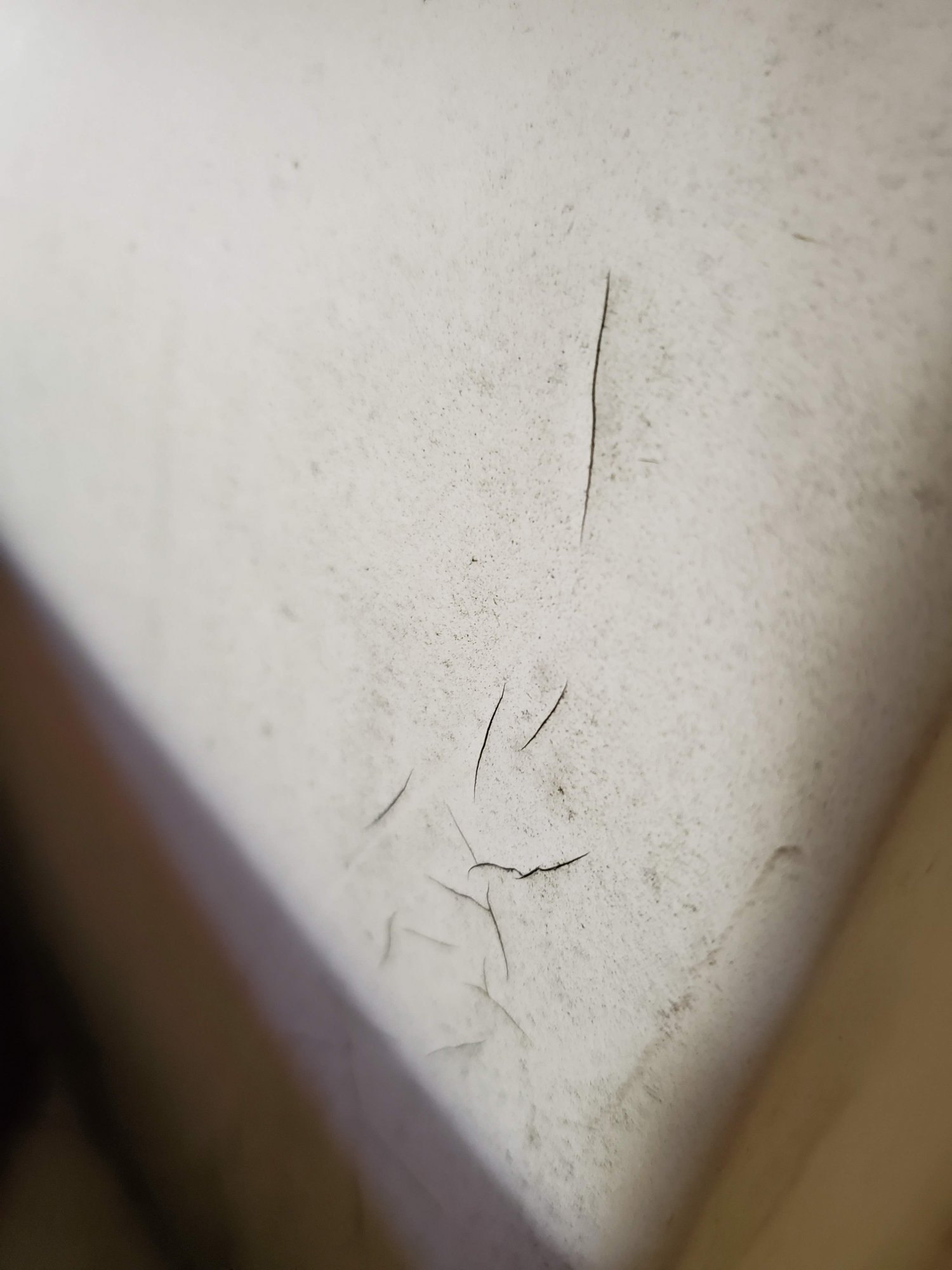

I have an 83 Cape Dory Typhoon that I am restoring. It has unusual gel coat cracking in certain areas of the deck. So far I haven't found anybody who knows what caused them. The deck core seems to be dry, no dead spots in hammer testing and no typical stress cracks in the area. The boat spent the last 7 years on it's trailer, under a tarp. I need to know the cause before I attempt to fix them. Thanks in advance!

without a close inspection, it may be tough to be sure. It looks like freeze and thaw cycles have taken their turn at this. Standing water on fiberglass, doing the same thing will often look like this. Is this the low spot on the side decks? Does it extend beyond where water would collect?

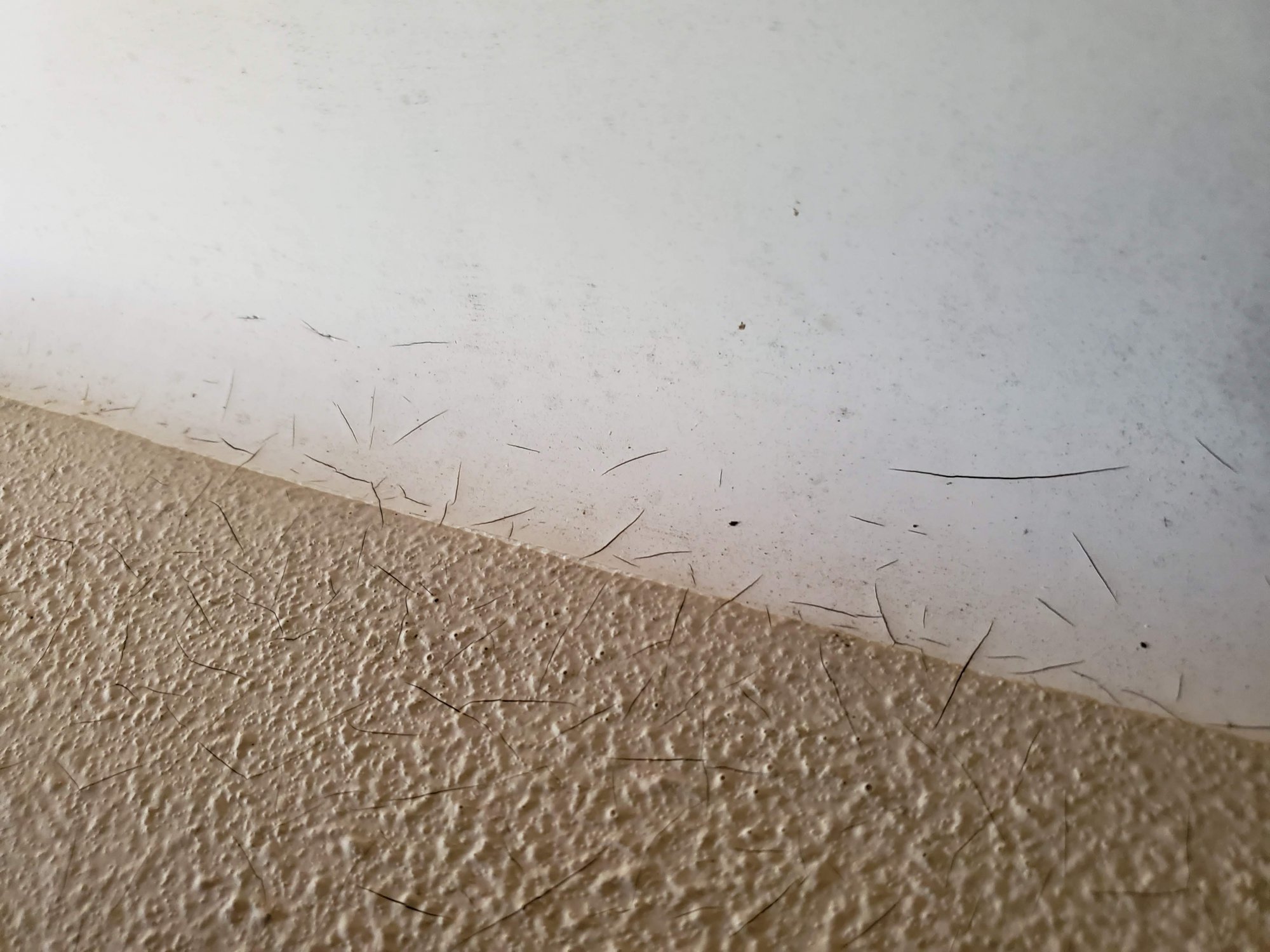

It appears to extend in to the nonslip and the cracking also follows the stain pattern.
More pics or known boat history may help. You could find a spot, less prominent and dremel or cut one or two to see what is behind or between them and the layup.

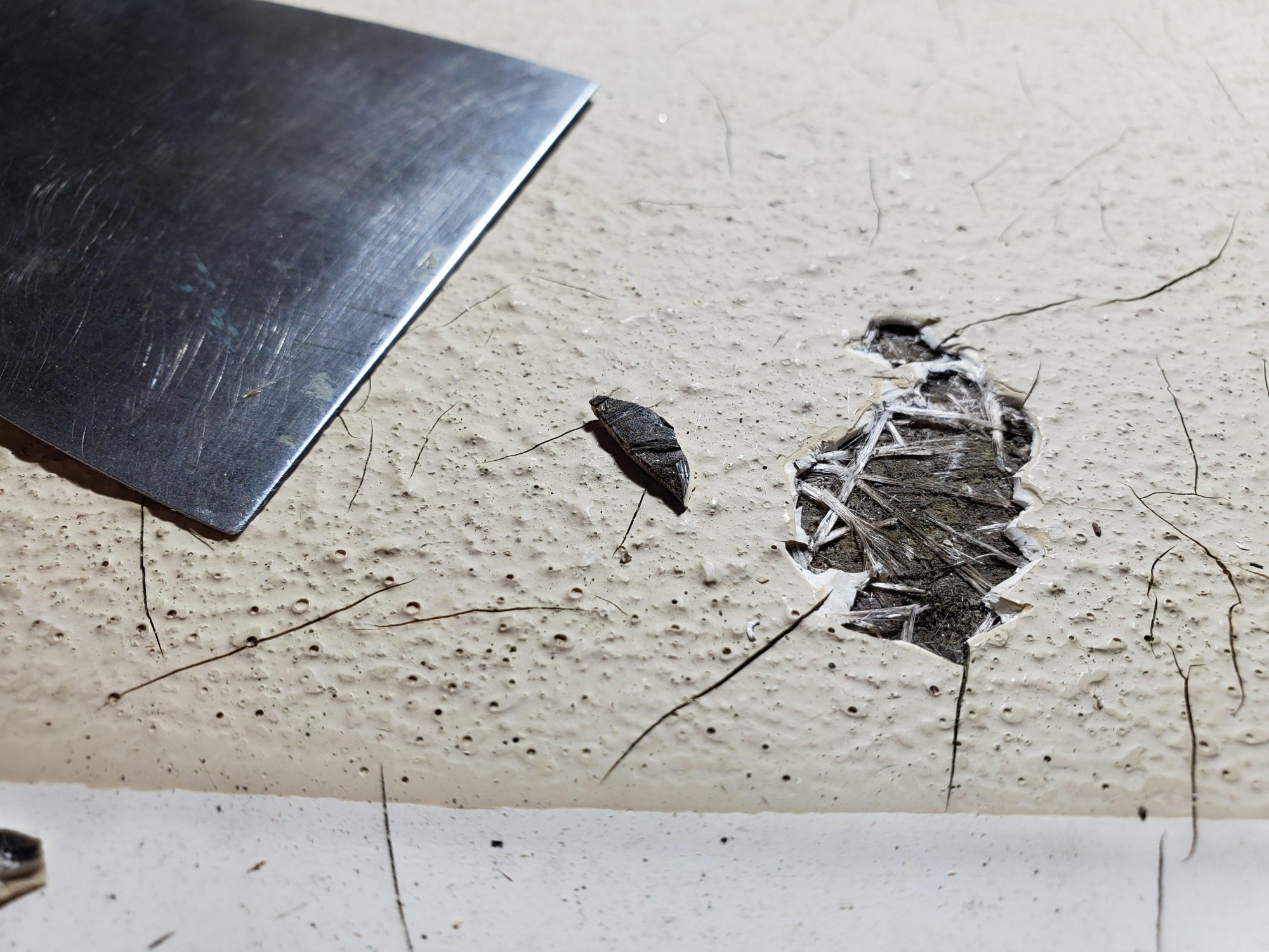

It looks like paint to me. I prolly couldn't resist putting a putty knife under one of those cracks, and giving it a flip to see what comes off and what's underneath. As for cause a puddle would do it (But more likely on paint than on Gelcoat.)

Moisture getting into the gelcoat or under the gel coat then freezing could easily create such cracks in the thing surface. Once started it would be relatively easy to continue over several seasons. The fact that it goes up the side a bit could also be explained by wicking of the moisture perhaps with some snow on the deck, then a freezing cycle.
It is not a definitive answer. You are going to be doing some removal, assessing that you have a sound sub-strata, then sealing the exposed substrata, and resurfacing of the affected areas.
I concur with @shemandr I would be inclined to see if the bits chip off. It would expose the lack of attachment to the substrata that makes up the deck. If deck is plywood you might have a substrata that you can work with. If not (say it is end grain balsa) then it may be deteriorated and you will need to replace the core before repairing the surface.

Judy, you may be right. I just went out and popped a chip of the gelcoat loose. It came off (relatively) easily with no real adhesion to the underlying layup. That said, the area immediately adjoining that was quite tight to the laminate. I guess this is a topside equivalent to an osmotic blister?

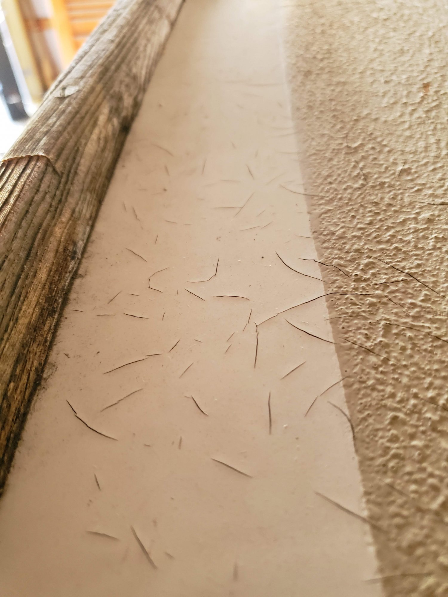

That last picture is nasty. That isn't just gel coat, it's the laminate that is deteriorating. Likely due to poor resin mixing and/or exposure to moisture and freeze/thaw cycles. How much do you have invested in this project? I'm sure this is repairable but will likely require stripping the entire deck and cabin down to the glass mat or even down to the core and re-glassing over it.

I am pretty sure that the appearance of the mat in that photo is because the PO pressure washed the boat and forced dirty water down into that small delaminated area. The crack I opened to pop off that chip was the biggest and most open, that's why I chose that spot. After trying to raise more of the gelcoat I found the other areas were much better bonded. I'm going to dremel some more of those cracks and seen if I encounter more delams.
