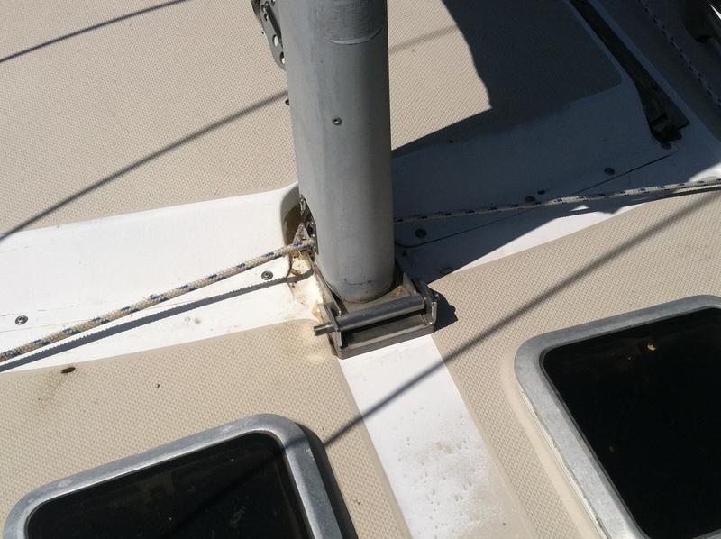

When un-stepping the mast, does it lay down towards the stern or towards the bow? The tabernacle on my new-to-me boat appears to have a hinge on the front, towards the bow. I’ve sailed a Catalina 22 for years and we always lay the mast down towards the stern. This apparent hinge on the leading edge has me a little confused!

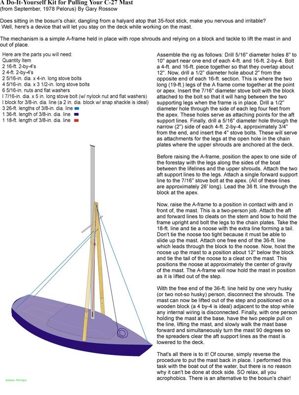

Speaking of stepping the mast, where can I find the instructions for building the “A” frame for un-stepping and stepping the mast?

As for stepping the mast, looks like forward is all you can do. This is not the standard tabernacle. You will have to pivot it down to the bow and then pull the pin. I don't know your exact marina situation but you will need many friends to help you do this.

The forward acting tabernacle allows you to use the boom as a gin pole. The C27 has forward and aft lower shrouds... you would need to disconnect the aft shrouds and backstay for lowering. I have seen sailboats rigged like this so they can clear low bridges while underway.
The wooden, fixed base A frame system was intended for a non tabernacle (hinged) step... it lifts the mast up enough to clear the step flange... then swing the mast horizontal before lowering to the deck.
With the hinged tabernacle you don't need to lift the mast.... so the A frame could be much smaller and hinged at the base to be used as a stabilizer ....
Try googling "A frame mast raising systems"

I may have to see if the tabernacle pin can be pulled so the mast could be lifted up with an "A" frame rather than lay it forward.

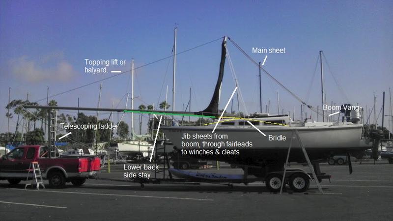

Joe, thanks for your input.
Can't get my head around lowering the mast forward yet. Will have to think about that. But ultimately do need to lower it to check shrouds, sheaves, etc. Our club is a "do it yourself" type club so I'm sure I can get a lot of input about how to do it and many hands to help. Thanks again!
RDett42
Unfortunately its is the only way to lower it. You can use the boom as a gin pole. I attach lines to the end of the boom and run them through the fairleads. I slide the fairleads as far forward as possible and then wrap them around the winches an secure them with cleats. This keeps the boom from being pulled over. They have to be adjusted as you raise or lower the mast. To keep the mast from going sideways I use the back lower side stays clamped onto a bridles that are attached to two stanchions on each side. I use the mainsheet to raise and lower the mast in line with the boom vang. The mainsheet though long is not long enough. I use a telescoping ladder lashed to the bed of my truck to act as a mast crutch. It is all very solid and secure.
