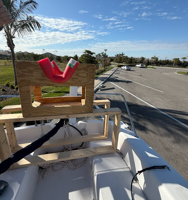

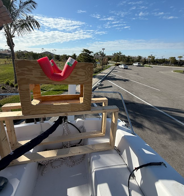

Thanks for the info. The previous owner built one from wood because the when they tried to use the MastUP pole, they couldn't figure out how to mount it because the traveler was in the way and became too much work. Here's a photo of the what they assembled:
