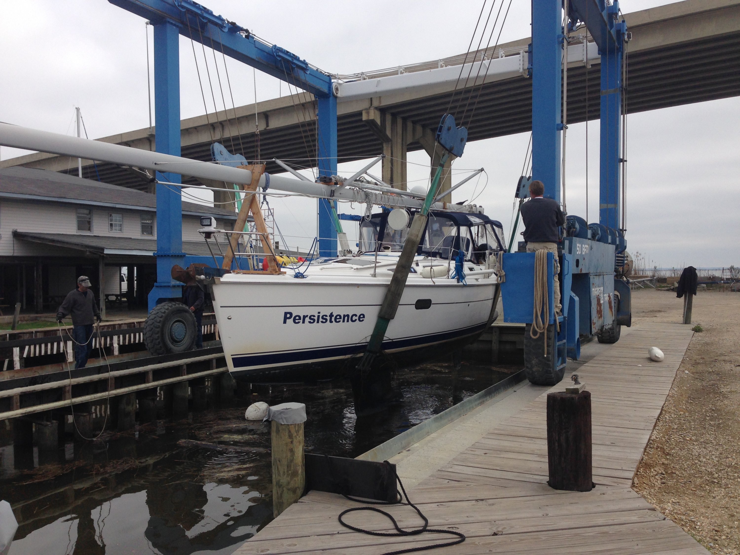

I have done it both ways on the Tenn-Tom from Kentucky Lake to Mobile and then coming back up in the spring. At my home port, they took it off. At Turner in Mobile, we left it furled in the mast. Made no difference, but what does is putting the spreaders up, not down.
Mar 3, 2003
710
Hunter 356 Grand Rivers
You can't move around on deck through the locks with spreaders down unless you get it (mast) up high which hurts your center of gravity. If you restrain your mast with a good cradle, it is not an issue. Mine restrains it forward and back and I tied lines to the spreaders vertically to cleats on the sides. No rolling possible. Most critical thing is to design a good, substantial cradle.
