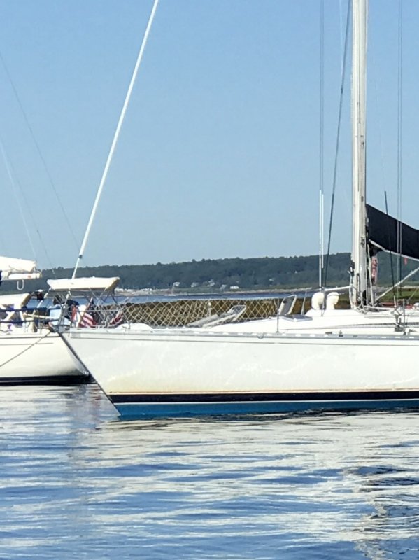

The sun had just recently dipped below the horizon, over an idyllic picture perfect Maine post card evening, the seals were barking, it was quiet, peaceful & serene. As I am sipping a glass of fine wine, while checking tomorrows weather on my iPad, in the cockpit I glance over to catch the last few nits of daylight, on what is close to the longest day of the year, yet something was odd.. I did not quite recognize what it was but a few minutes later I glance over again and this time it hits me like Mike Tyson chewing on my ear... I look at my wife and simply say; "I gotta go, that boat is sinking."
After Saturday nights debacle I realized I had actually I captured her bow about 15-20 minutes before the five gallon bucket brigade began. Unfortunately in the excitement my phone was on our boat during the height of it so this is the only photo I have of her sinking. She dipped to about half way up the tops sides and this is nowhere near as low as she got..

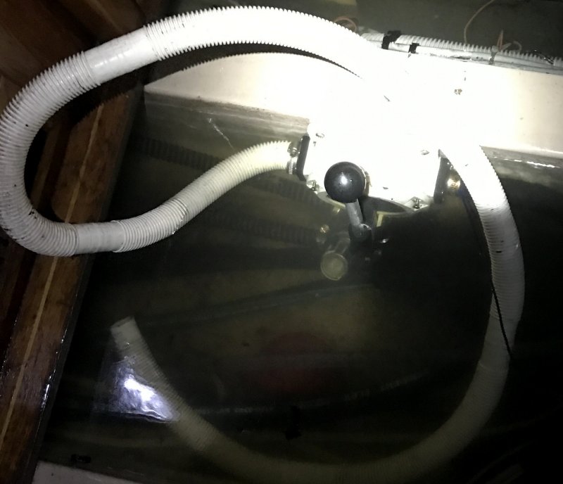

I began the frantic search for the manual bilge pumps handle. You know the handle that should ALWAYS be within inches of the manual bilge pump?? Not..... I frantically searched every nook and cranny in the cockpit to no avail. Nothing in the lazarettes but piles of rotted running rigging, filth and grime and no sign of anything related to safety or good safe boating. At this point I realize I need to go grab my own manual bilge pump handle and some head lamps. I yelled to the two guys bailing that I would be right back and the last thing I said was;

"Can you reach into the winch holder on the pedestal and pass me the bilge pump handle and grab me the three headlamps in the saloon table as well as the hand held VHF?"
Within about 10 seconds I had everything I needed, just as it should be, in an emergency.
When I got back to the sinking boat I tried to insert the bilge pump handle, but it was a no-go. The boat apparently uses a different handle than the rest of the world. D'oh.. I won't even go into the sheer stupidity of a non-industry standardized emergency bilge pump handle, when it comes to safety.. After realizing my own bilge pump handle would not fit, I hailed on CH 9, the working channel of the anchorage we were in, for a bilge pump handle to help save the sinking boat.

After the VHF call we received half a dozen handles but only one of them fit. Immediately a guy I know who came over to help, I'll call him Johnny, but that's not his real name. Johnny went to work pumping the bilge manually from the cockpit. He was frantically pumping away, like a teenage boy with a Farrah Faucett poster, but the flow was meager at best. He said that initially the pump felt like it was doing something, for perhaps the first 20 pumps, then it quickly faded to something akin the pee-stream of a chipmunk. You guessed it, a dead pump diaphragm due to LACK OF MAINTENANCE.

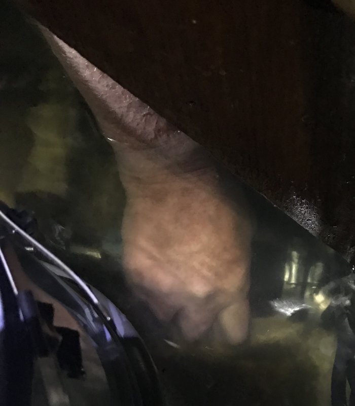

Back on the boat I make my way down the companionway, while ducking the bucket brigade, to attempt to tighten the stuffing box. As I reach in there I can still feel the cold water flowing in. The water is still up to my shoulder, while accessing the stuffing box, and I can't really see the stuffing box yet but I can freely rotate & wiggle both hose clamps around the stuffing box hose. "Are you freaking kidding me?" I mutter. I have now been attempting to tighten the clamps for about three or four minutes but every time I think I have the "nut driver" on the clamp bolt it rotates away from me. As boats go a job that's easy with two hands is impossible with one handed access... "Ricky" I yell to another guy I know, and no it's not his real name, "Can you get any access to the stuffing box from starboard?", "I am shining my head lamp on it now." I say.
Within a few seconds I see Ricky's hand but Ricky can't see the stuffing box, he can only feel it.
Ricky's hand on our second tightening attempt, after the water had subsided a bit:
"Holy $hit this thing just rotates!" he say's... "I know!"..
I reach down and rotate the clamp to where I think I need it oriented, which is tough to do in shoulder deep water that is occluded with bilge grime, oil sheen, floating Rotella quarts and anti-freeze gallons bumping off my thighs.
I rotated the clamp and manually guided Ricky's thumb to it and said; "Press hard." Ricky presses and I begin to make a few turns, then a few more, then more and more and more. I am beginning to think this clamp was never tight at all...??? We managed to get the clamp somewhat snug then moved to the other one. The second clamp takes nearly 15 turns before it even starts to "grab" or compress the hose. Once again I am left thinking WTF...???

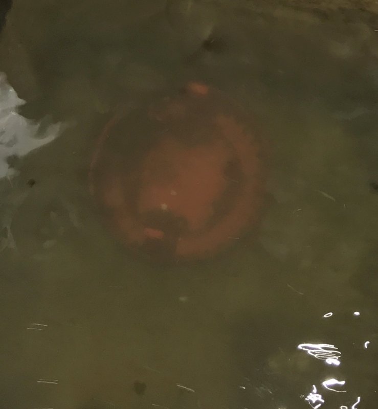

The water level finally gets down to the point where we could see this:
Abandoned bilge pump strainer basket
What do you suppose that is? I knew instantly that it was a strainer basket for a Rule BILGE PUMP. Yes, the pump was gone, apparently had failed, wires were cut and left to dangle in bilge water and the pump was never replaced!!!
No, I am NOT kidding, you really can't make this $hit up.
This is why the bilge switches did not work.

Lest you think ripping out one bilge pump, and failing to replace it, is bad, how about ripping out TWO bilge pumps and failing to replace them........?????????? I suspect even Bubbles from Trailer Park Boys would own a better maintained boat than this. Here kitty......
The second abandoned bilge pump strainer basket....
Shake your head and laugh all you want but I am not kidding about this at all. At one point in time this vessel had no less than four working bilge pumps two manual pumps and two centrifugal Rule type bilge pumps. It now has ZERO, unless you count a small diaphragm pump with a 100% clogged intake screen.....

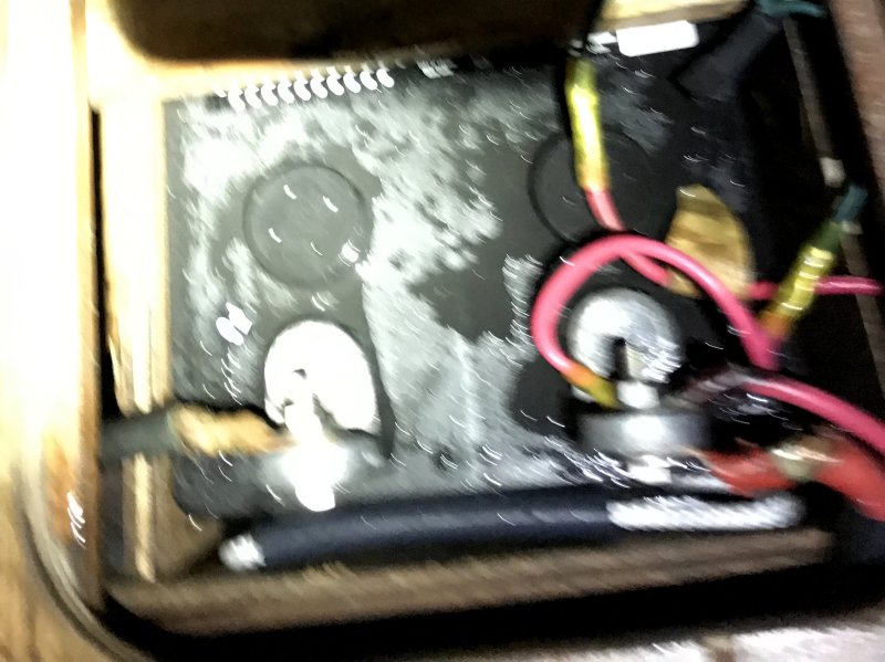

Oh and how can I forget the batteries....
A fully submerged battery!
Please, please, please THE BILGE IS NO PLACE FOR BATTERIES! This battery is BELOW the cabin sole boards on a very shallow bilge boat. DUMB, DUMB, DUMB. This practice alone should disqualify any boat from off-shore racing, but I digress.
In this debacle even the house bank which sits higher, under the aft cabin berth, got submerged. Sorry for the bad pic this is just how the night went.
If you question the speed of DC corrosion please understand that these terminals went from silver to eaten/eroded almost no time at all. The bubbles around the negative terminal are DC corrosion physically eating away at the battery terminals.
I will say it again, BATTERIES SHOULD NOT BE IN THE BILGE!!!

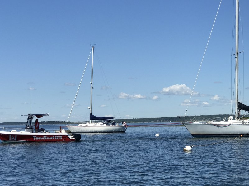

Tow Boat US had been called, I suspect by the marina, and sent a representative boat with a 120V crash pump. This photo is really quite representative of the entire night, a virtual blur..

The next day at about 10:45 am Tow Boat US showed up:
throughout this entire ordeal, even the next day the owner never showed up nor did any crew only the tow boat operator, some marine help and us bystanders in teh anchorage. An utter lack of respect for the vessel and human life by this owner...

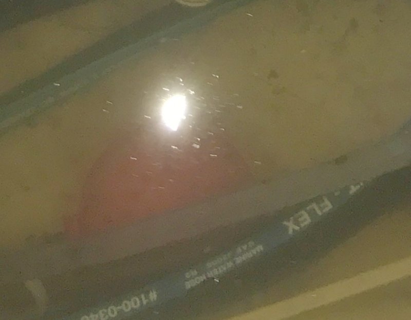

If you think all my harping on safe electrical installations is over the top, think again! This 120V pump was being fed by an on-board inverter, one that was improperly wired, and it gave me the shock of my life when I went to move it from one bilge compartment to the other. I grabbed the pumps handle to move it and ZAAAAAAP! It was hard to even let go yet no breaker ever tripped. My entire arm was still tingling for about 30 minutes. SAFE AC installations, even inverters, DO matter!!!!
ZAAAAAAP!!!
Shortly after being zaaaaaped I went to check on the bow pump and wham... I slipped on slimy diesel saturated bilge pad that had been abandoned in the bilge. Come on really? Is your boats bilge a trash can now too????? For Christ sake already!!
In the above photo you can now see a bit more clearly the abandoned bilge pump strainer as well as the abandoned bilge pump wiring. This owner KNOWS this boat is not safe but apparently DOES NOT CARE.....
I suspect this boat, when you consider the horrendous condition & lack of upkeep, should be totaled. The engine got drenched and the boat was not even towed until about 11:00 am the next day. When you pickle an engine it needs to happen ASAP...
