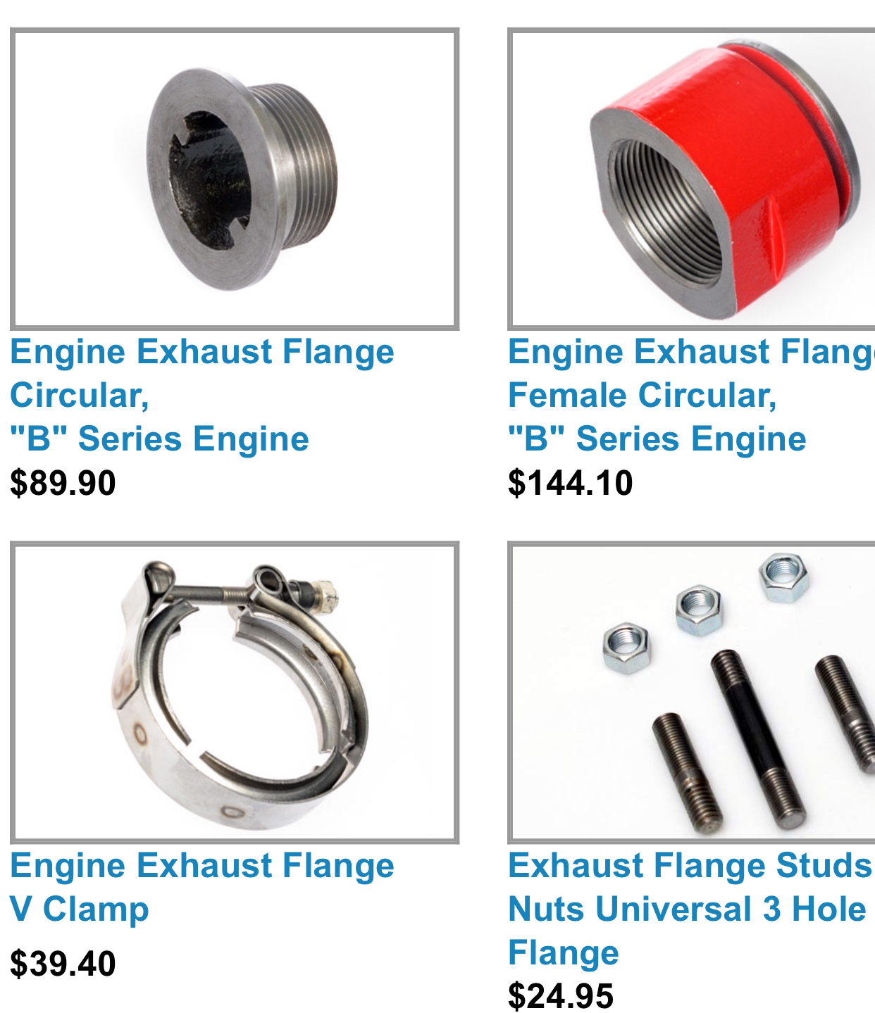

A heads up, check your riser. Started the boat up last weekend and with in seconds the riser blew off. A clamp that holds it on broke. Looking at this clamp, a "T" type SS clamp with a bolt that has a barrel on one end, the barrel broke clean off. It looks like it had been corroding for a while. Funny how I sailed/motored all last season and even winterized without any failure and it blows off in seconds during spring commissioning. That's the good news. It could have happened later in the season and stranded me. There is a gasket between the riser and elbow. The gasket was pretty much gone. Perhaps it slowly broke away causing the clamp to loosen and vibrate, causing the failure. Just speculation. In any case you guys may want to check yours out this spring. CO2 poisoning with a lose clamp/bad gasket, not good.
