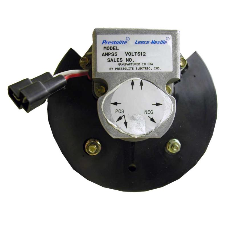

Leece-Neville 8MR Series is what you want... These are the old Motorola alts...

My old Motorola just has the POS terminal for output to the batteries and one other that goes to the starter switch. The replacement appears a little more complexed!
