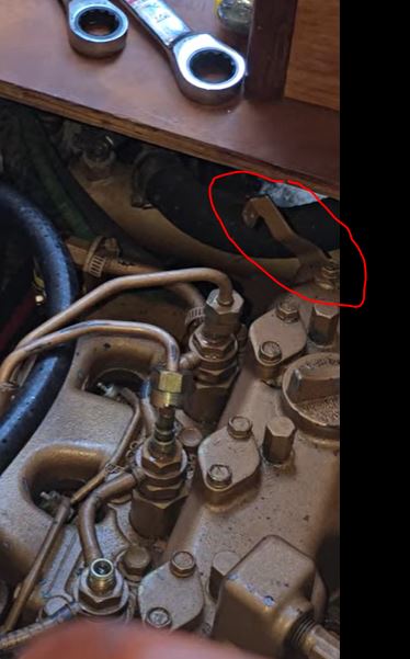

2. You have decompression lever (see attached image)
Activate that and turn engine over to see if you get more fuel flow

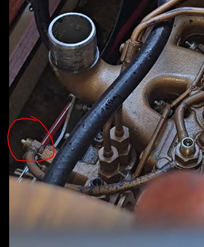

3. Open the bleed valve.
You appear to have a bleed valve on your injector pump, but it seems to be missing the knob (see attached image)
I have an M50 and when the bleed valve is open, the fuel lift pump pushes fuel rapidly through the bleed/bypass hoses to flush out all the air. When the bleed valve is closed, the fuel pump just puts positive pressure on the injector pump. The engine will run with the bleed valve open and with the bleed valve closed.
You need to put the knob back on and open the valve all the way, then run the fuel pump to see if fuel recirculates back to the tank.
Search "kubota bleed valve" to see what it looks like (and see attached file)
