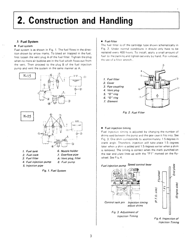

Did you open the valve "B" on the pump? Fuel should flow out of there.
Im not sure which one is 'B' I got as far as the first nut past the bleeder knob. Tomorrow im gonna loosen all the nuts on the bottom and top of the pump. We have never had to bleed this engine since we owned it and i've chaged all filters, all fuel lines,

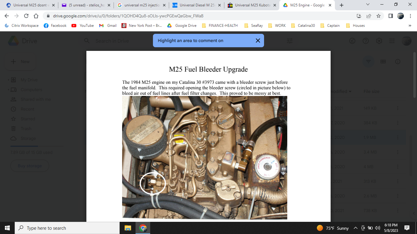

etc. (photo not my engine)
Normally IF you do not run it out of fuel then you can bleed the system with the bleeder screw circuled in your photo. If the engine runs out of fuel or by other means gets air into the high-pressure lines from the injection pump to the injectors, than you will need to do a manual bleeding of the high-pressure lines.
The M25 bleeder is a bit more primitive and not as effective as the M25XP because the bleeder vent does not return to the tank. Just because you are getting some fuel out of the bleeder does not mean that you got all of the air out. When I change filters on my XP, I let the lift pump run for at least 60-seconds after the pitch drops which is an indication that the system is full of fuel. This returns the fuel released by the bleeder back to the tank. Then, when I close the bleeder screw, I listen to make sure that the pump nearly instantly slows down to its normal slow tick-tick-tick which indicates that there is no air to compress. If it takes several seconds to slow down, I know that there is still air in the system and I need to bleed more.
I suspect that part of your problem might be that you had not gotten all of the air out so once you started cranking, that air was sucked into the injection pump and is now just being compressed in the high-pressure line. If it was me, I would:
  1. 1st off, make sure that no water was coming into the system, i.e., thru-hull closed, and water lift drain open.
  2. Then I would crack each of the high-pressure lines at the injection pump and crank to make sure I have fuel there. You may need to loosen the nut a fair bit and jiggle the lines to break free the sealing flange.
  3. Once I got fuel from the pump end of the HP lines, I would loosen the injector end of the HP lines and bleed it there.
  4. Once I was sure that I have fuel all the way to the injectors with no air in the system it should fire and if not you likely need to look deeper.
