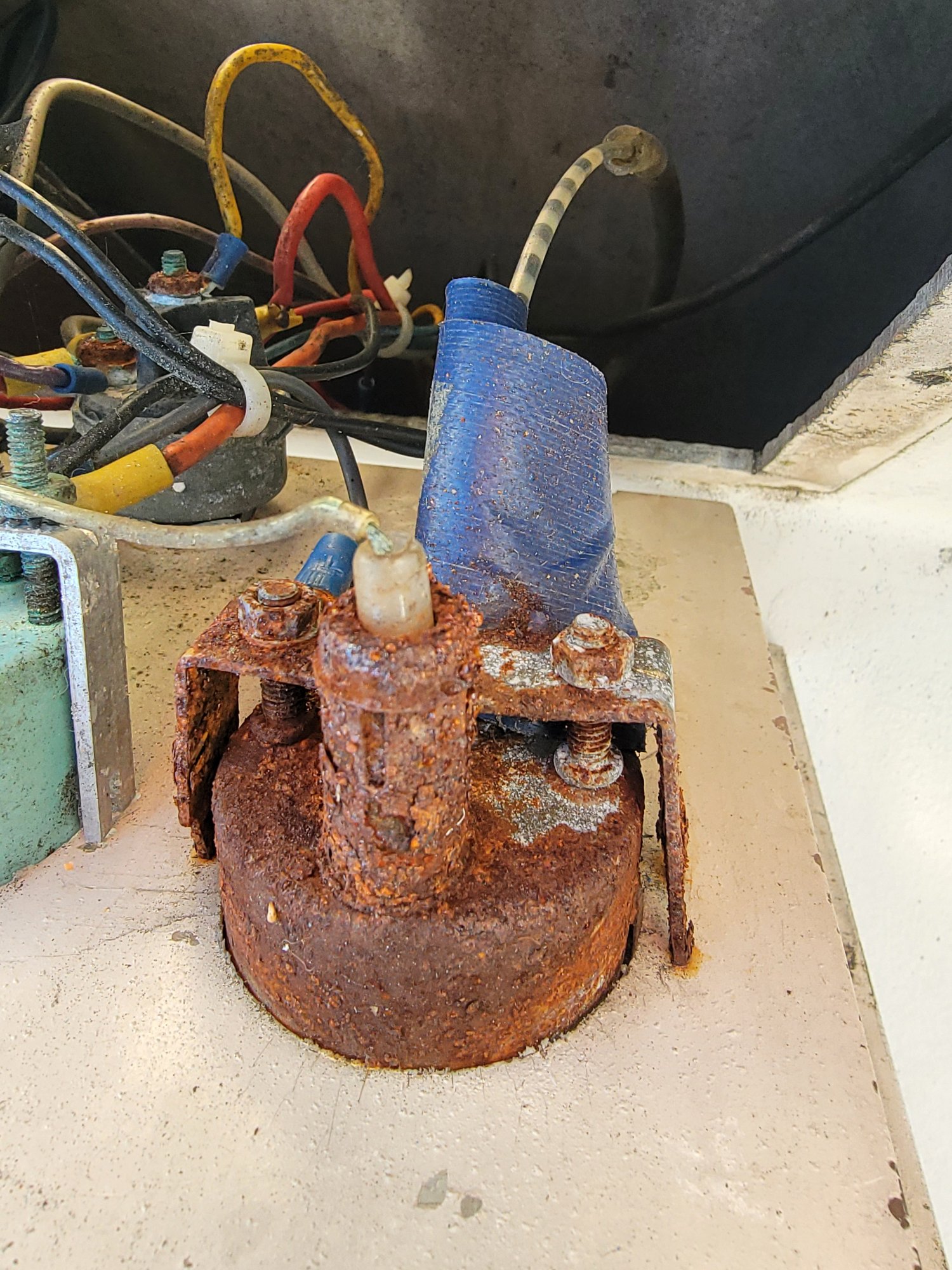

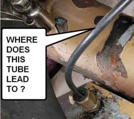

That line that Ralph asked about looks an awful lot like a sensor line for a manual oil pressure oil pressure (non electric).
OMG, you don't suppose this boat was built by British Leyland Motors in the UK with all their crap dashboard gauges. Oil pressure was a tube to a Bourdon tube pressure gauge in the dash. Speed and RPM were high speed rotating spring wire within cables which led to the dash (think engine stop cable.) There was also temperature readout but it was not electrical. It was as if they had never heard of electricity. Hopefully not.
As its a switch, i am assuming the PO didn't like not having a guage and added the box as an upgrade that later failed catastrophically (note the wobbly reconstructed side)
If wobbly is the case, I'd suggest removing the box and consider any "T" joints be done with solid piping (1/8" NPT) or other small but solid assembled piping.

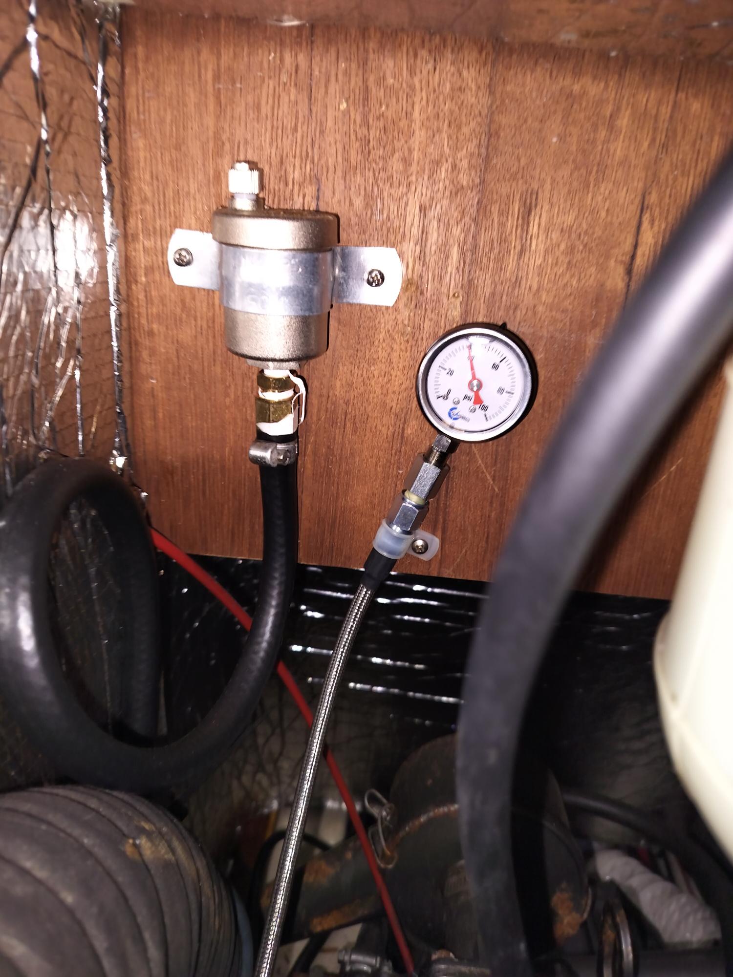

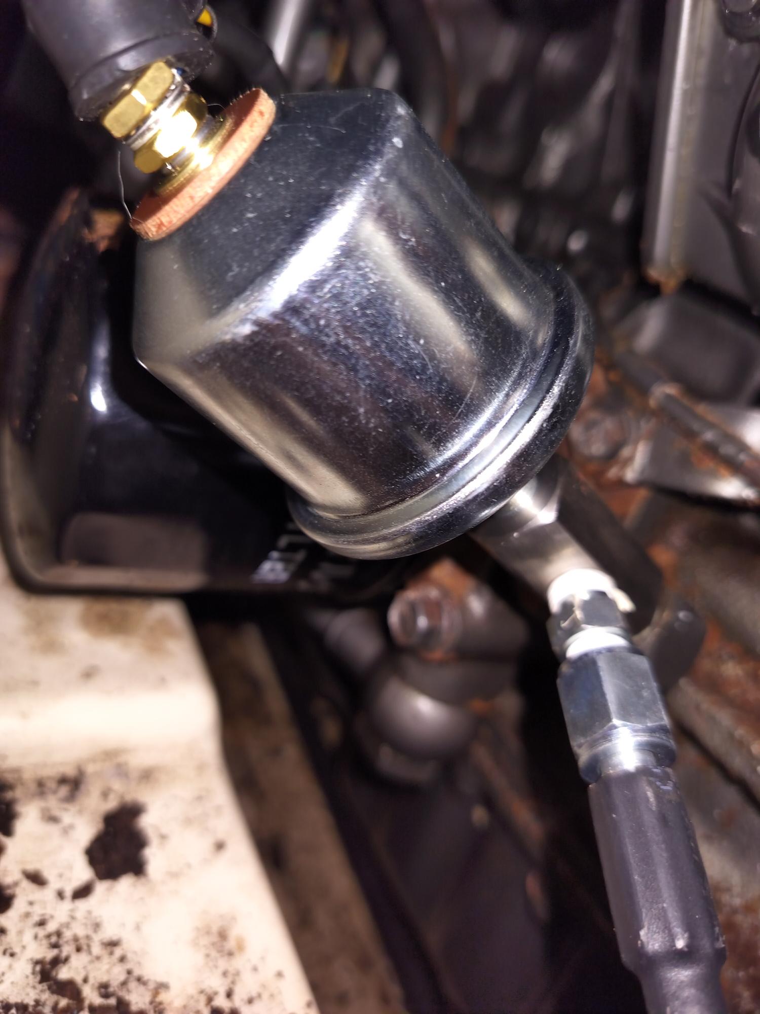

If you are concerned with the block modified by the PO you can probably replace the block with a more compact Tee as long as the block doesn't serve some other function. I'll post some pictures of what I did with my Yanmar later.
Oct 26, 2010
2,214
Hunter 40.5 Beaufort, SC
Not so much a Yanmar vs Universal engine issue. Just an example of how an adapter or T could replace the big, clunky "box" as you suggested
My adapter had one male BPT that fit into the location of the original pressure sensor. (ordered from McMaster Carr). Yanmar used BPT threads for the OEM sensor. The adapter had two NPT female connections. I put in the replacement (non-OEM) sensor with male NPT connection into the adapter. The matching electric oil pressure gauge was placed at the helm where the original oil pressure gauge was. I also atached a metal weave female NPT oil line hose into the other NPT female location. I then ran the oil pressure sensing line to a mechanical gauge I put in the engine compartment (it is there for reference to the electric gauge at the helm should I think I have a problem.) The poster could adapt the same concept hooking his adapter into the original location of the oil sensor which now has a hose that feeds the block.

Could very well be. All depends on just what's hidden in that Pandora's box. Unless it serves some unseen purpose, I would say it's got to go.

Here are the pictures I promised. As @Ralph Johnstone noted, you need to find out all the things that the "mystery box" does, feeds from and feeds to. It may be straightforward to replace the box with a simple adapter if it only provides a way to connect to the electronic gauge sensor and some other gauge. Don't use and teflon tape or pipe sealant where the adapter screws into the block and where the electronic sensor screws into the adapter. It needs to be able to have a good ground to work properly. You'll also need to know the types of threaded fittings (NPT or BPT) and get the right kind of adapter. The connection with the teflon tape goes to the mechanical gauge in the engine compartment. All readings shown are at idle. Pressure goes up to about 60 psig on both gauges at about 3000 rpm.

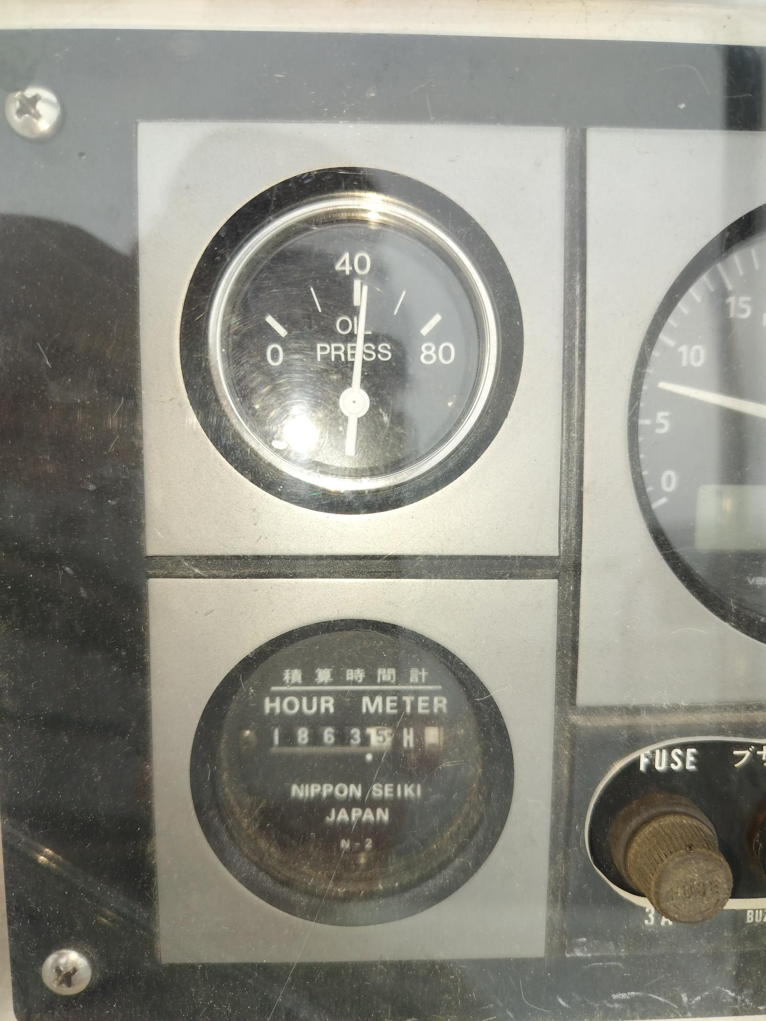

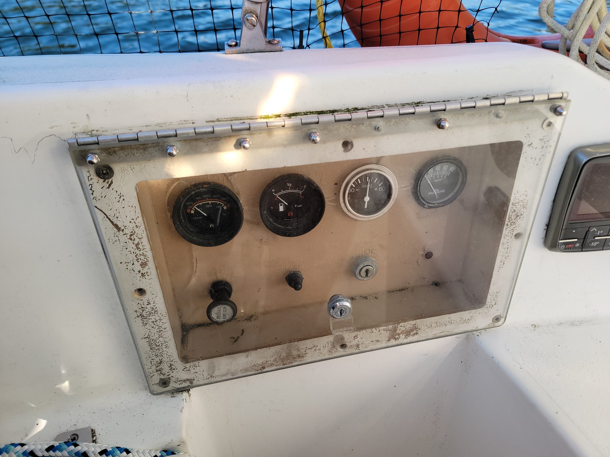

Where is that gauge installed? It does not appear to be located on the standard instrument panel shown in the link from @kloudie1. Find that gauge and see if it has a solid line, not an electrical wire, feeding it.
If all of the above is correct and the pressure on the gauge behaves as you have stated (drops slowly from 45 to 20 pounds as the engine heats up) and drops to 0 when at idle after that and the buzzer comes on that indeed, it is most likely you have a REAL low oil pressure situation. Two different indications, one electrical and one mechanical gauge both say you have low pressure - Believe your indications.
Thanks yes i agree - it does feel like its a real pressure issue but being that the guages are clearly suspect and theres a chance that its solely a sensor issue of course i'll try adding manual sensor first such as you show - FYI the boat has a completely non standard panel with an oil guage and buzzer( with no RPM or hour meter :/ but yes i do intend to install). The thicker line people are suspecting is mechanical seems too flexible to be mechanical but i will confirm by removing the panel and inspecting the guage.

@smokey73 . is your number one picture upside down ? Can't get my head around where we are. Do you have anything taken from farther back ?
Also, is your adapter the hex tube with a 1/8" NPT hole in the side ? Looks good but would look even better from further back.

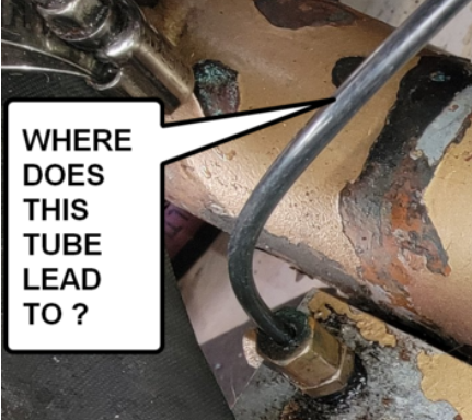

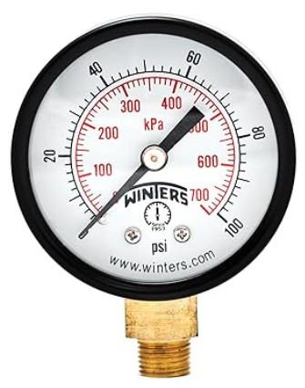

Mechanical means that oil under pressure is delivered to a mechanical pressure gauge in the engine panel as shown :
Any soft tubing will suffice. The one you show :
.......................... looks like 1/8" polyethylene pneumatic instrumentation tubing. Really bad choice in a hot environment. The softened tubing will release from the compression fitting.
Keep us informed and take lots of pictures of what's inside the mysterious box.

@Ralph Johnstone No, picture 1 is not upside down. It is looking down from the front of the engine. Can't really take from much further away as "things" clutter the picture. The oil filter is just behind the fitting and is horizontal to the engine. The sump can be see in the center at the bottom of the picture.
Yes, the hex tube is the adapter bought from McMaster Carr. It has male BPT threads to fit into OEM connection on the Yanmar and then two 1/8" NPT female threaded locations for the aftermarket sensor and mechanical gauge connection. The replacement sensor is the shiny silver cylinder with the electrical connection. The 1/8" fitting with the teflon tape and metal reinforced hose is the hose to the mechanical gauge in picture 2. I liked to have the independent oil pressure confirmation of the mechanical gauge that I can refer to when I suspect there is question with the electrical gauge. It is a lot less subject to wire resistance or connection issues like a electrical sensor.
I agree that what looks like the instrument tubing is not a good choice. That is why I used metal reinforced metal hose that is often used for turbocharger oil supply tubing in race cars.

After dislocating my neck trying to figure why your electric pressure sensor is in a different position and why the oil filter is in the wrong position, I conclude your Hunter 40.5 does not have a Yanmar 2GM.
Moving right along here, yes, your arrangement is the best for two different points of presure sensing. As I mentioned in post #22, somewhere out there exists a sensor which acts as a pressure sensor for a readout and a pressure switch for an alarm. I'll find it later on or I won't be able to sleep tonight.

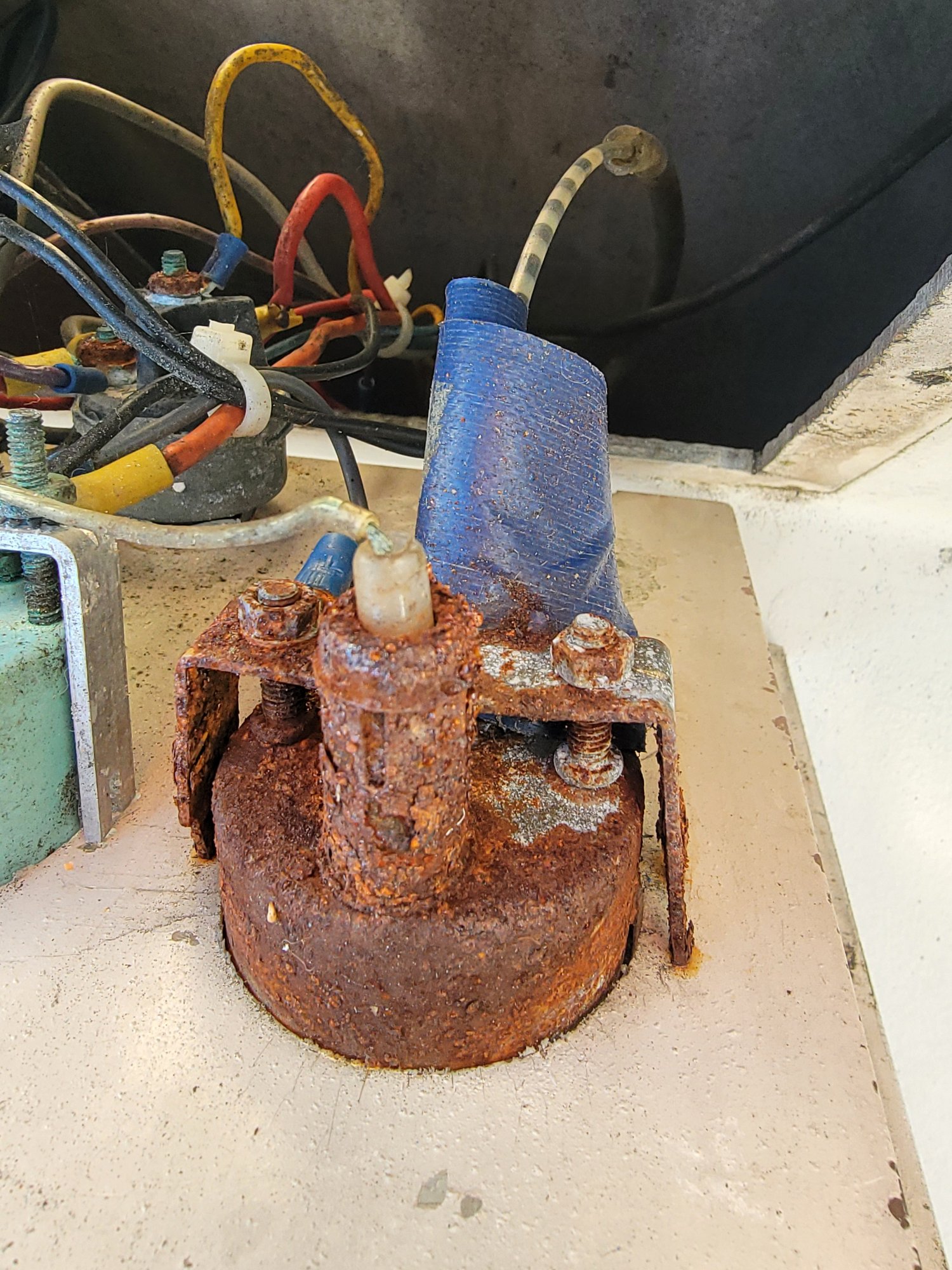

OKay so one line is the buzzer and the other is a mechanical tube - I can see the oil leading to the guage.
You can see replacing these guages and sealing the panel has been on my list for a while.
I'm going to spend some proper time on the boat at the weekend - it will then be in its home for the winter and I can safely open up the box, take measurements, clean up the ER and order the new guages.
I'm assuming switching to all electric would be better wouldn't it? I hate the idea of a flimsy tube carring oil half way across the boat.
Moving right along here, yes, your arrangement is the best for two different points of pressure sensing. As I mentioned in post #22, somewhere out there exists a sensor which acts as a pressure sensor for a readout and a pressure switch for an alarm. I'll find it later on or I won't be able to sleep tonight.
Yes, it is a Yanmar 4JH2E. It is the principle of being able to use adapters to provide input to the sensor's you choose to have I was trying to illustrate.
I personally don't like like the idea of one single sensor providing two functions. I removes the concept of redundancy.
In fact I now have three separate measures of oil pressure now. Probably overkill but it was a simple mod. I now have one electronic sensed gauge reading pressure at the panel, one sensing pressure at the mechanical gauge in the engine compartment, and a third that is a "low pressure switch" sensed at a different point that provides an alarm if the pressure gets dangerously low (about 8 psi). Originally I was just going to install a temporary mechanical gauge to figure out why my electronic sensor was reading low, but it was just about as easy to make it permanent since I had to have an adapter anyway.
