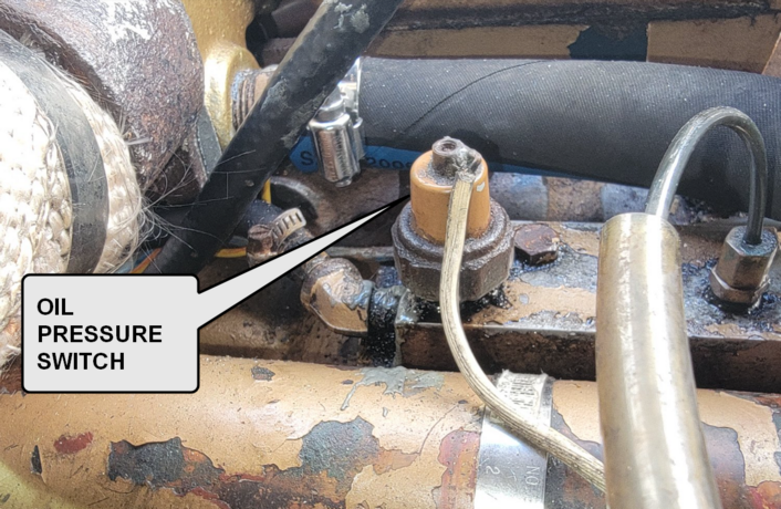

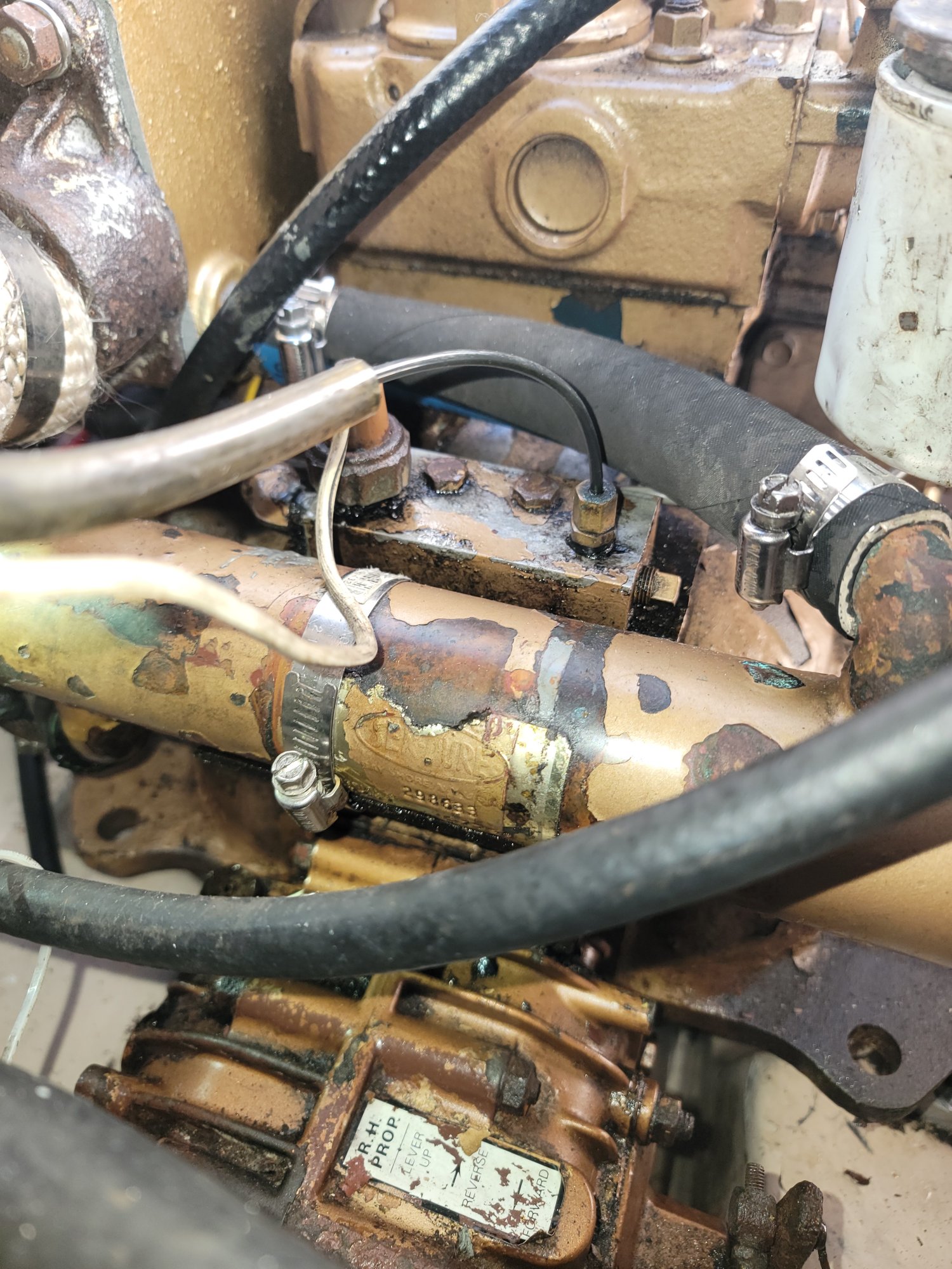

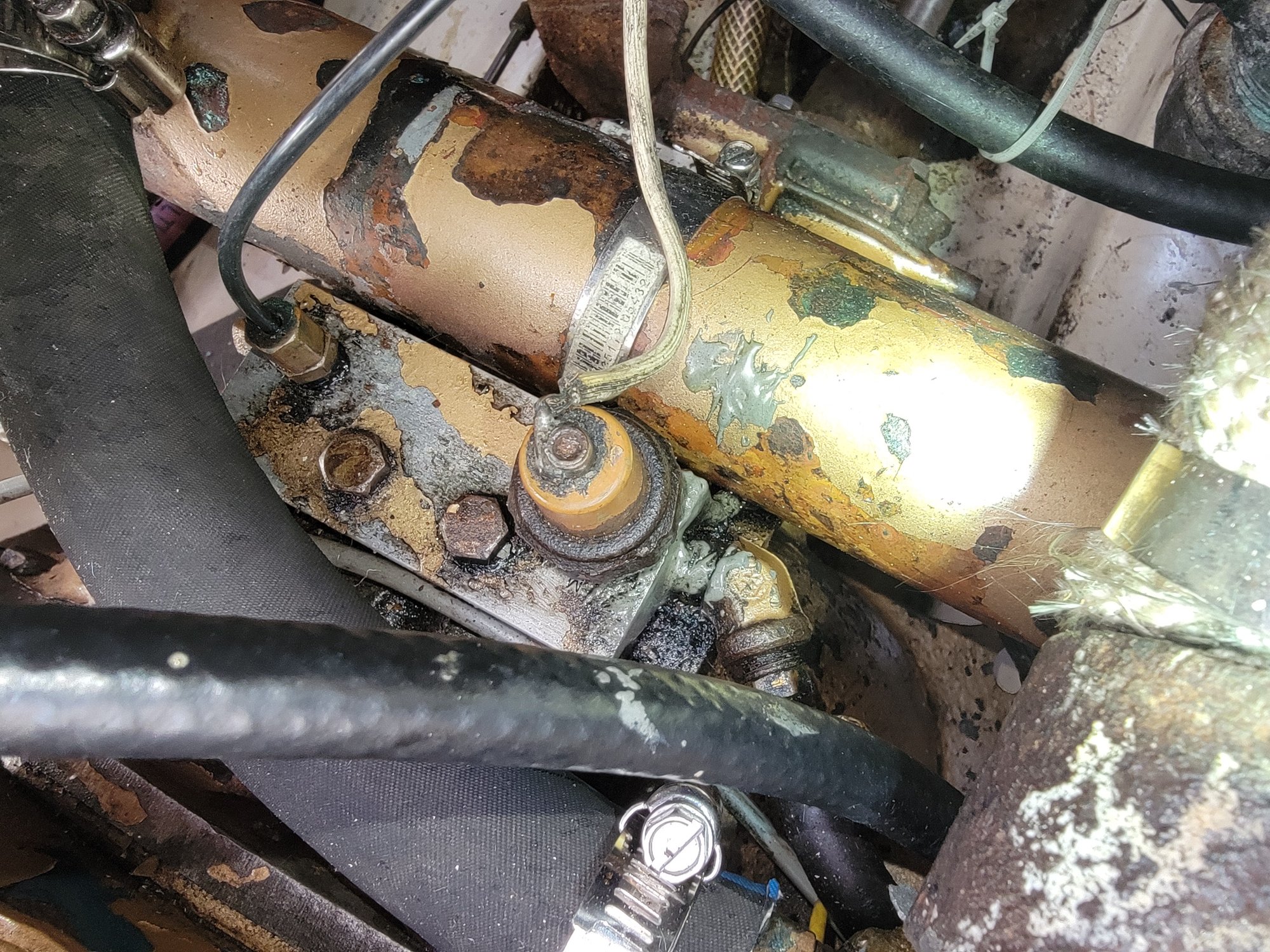

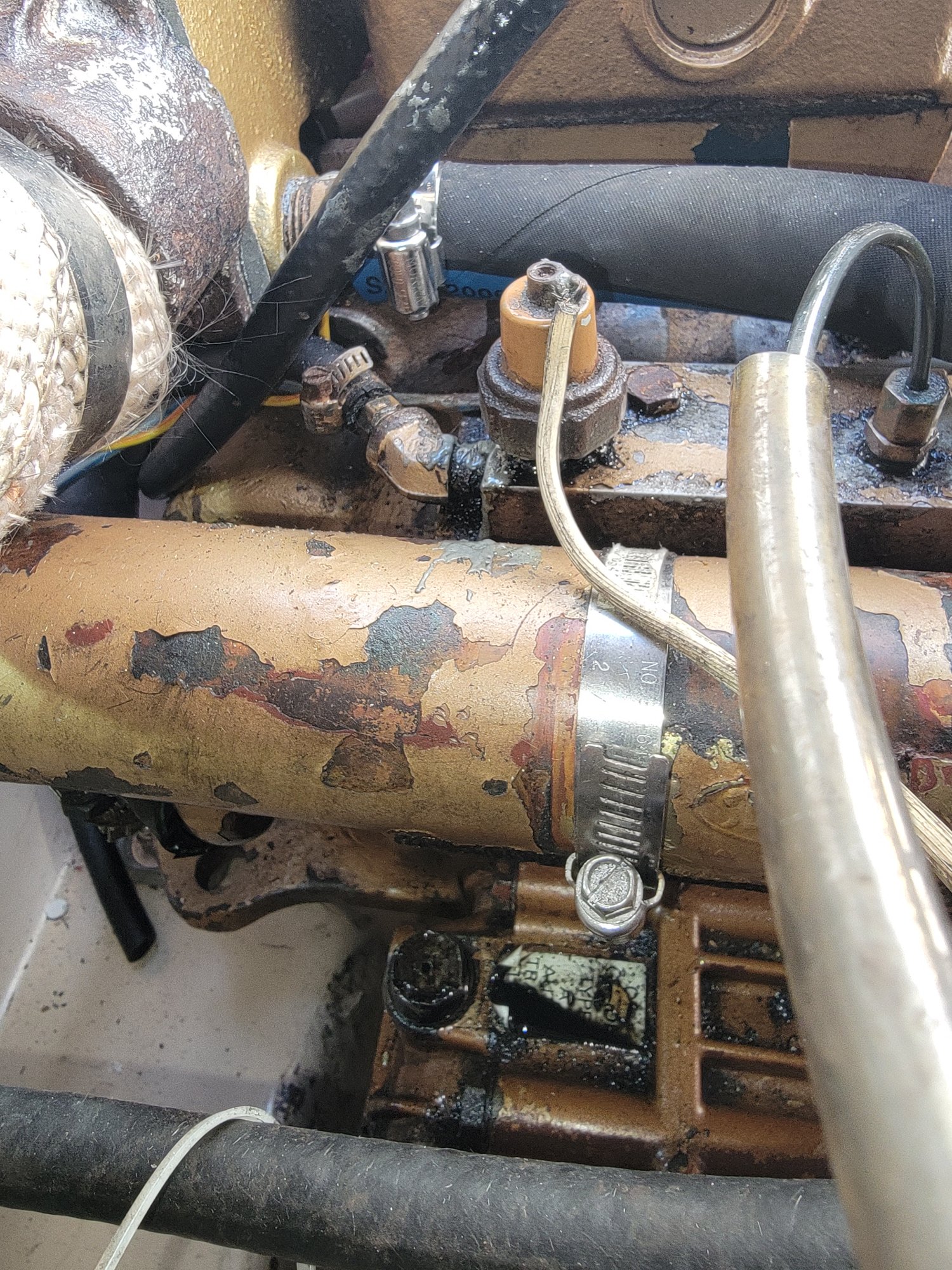

okay i think the hive mind here was absolutely correct... i spotted some oil on top of the transmission - it looks like its dripping from above and it appears that there is some after market external box... for the pressure sensor to live in (at least i very much assume this is what it is given that the small hose that the 45 degree elbow feeds from loops back under the manifold and into where the sensor is supposed to live.
Ive wiped this flat surface clean this surface a few times- i believe the oil is coming from here.
This part doesnt appear in the technical manual so i assume its after market. Any idea what it would be called?
It also appears to me that this box has been soldered to repair it. maybe? Maybe also its damaged and thats why its leaking?
If anyone knows what part this might be perhaps i can order a replacement for it and the sensor?.. (BTW - i believe this is a sender as im 99% this goes to a guage and buzzer - not just a light)
Thanks so much - and apologies for making you look at the dirty end of the engine!

Hard to tell what that tubular device is without some detailed photos on any connections.
My first thought was a heat exchanger, but too small and not in the typical orientation.
Maybe an oil cooler?

Do you have a Universal M18 maintenance manual from this site yet ? I'm too lazy to look for one because as I said, I'm a Yanmar guy. Without a manual handy, I'm pretty sure I'm in the right ballpark in saying this is the oil pressure switch :
A pressure switch in not a pressure sensor. It doesn't give you a pressure readout, it only opens and closes an internal switch at a dangerously low oil pressure (about 5 PSI). Any small oil leaks in this area will not affect the pressure supplied to the sensor element by virtue of the the relatively large cross sectional area of the pipes and tubes feeding the inlet to the pressure switch. Next :

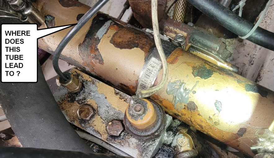

The adjacent tube shown above looks interesting if you can tell us where it leads to with a picture of the termination.
@Stu Jackson , any chance you could supply a manual to indicate what the block is that the pressure switch sites on ?

Thanks @Ralph Johnstone ! Yes the m18 technical manual and parts list just shows an oil switch screwing directly into the kubota z600 block under the manifold, unlike my engine where this is placed near the heat exchanger - as I mentioned I've not come across anything like this external box. This is the OEM part the parts list calls for- Universal, Switch, Oil, 298663
As its a switch, i am assuming the PO didn't like not having a guage and added the box as an upgrade that later failed catastrophically (note the wobbly reconstructed side)
So i think i should replace this whole box and pressure sender. Could this be with a 3 pin sender which sends pressure signal and a 8 psi warn? Assuming not any will do?
