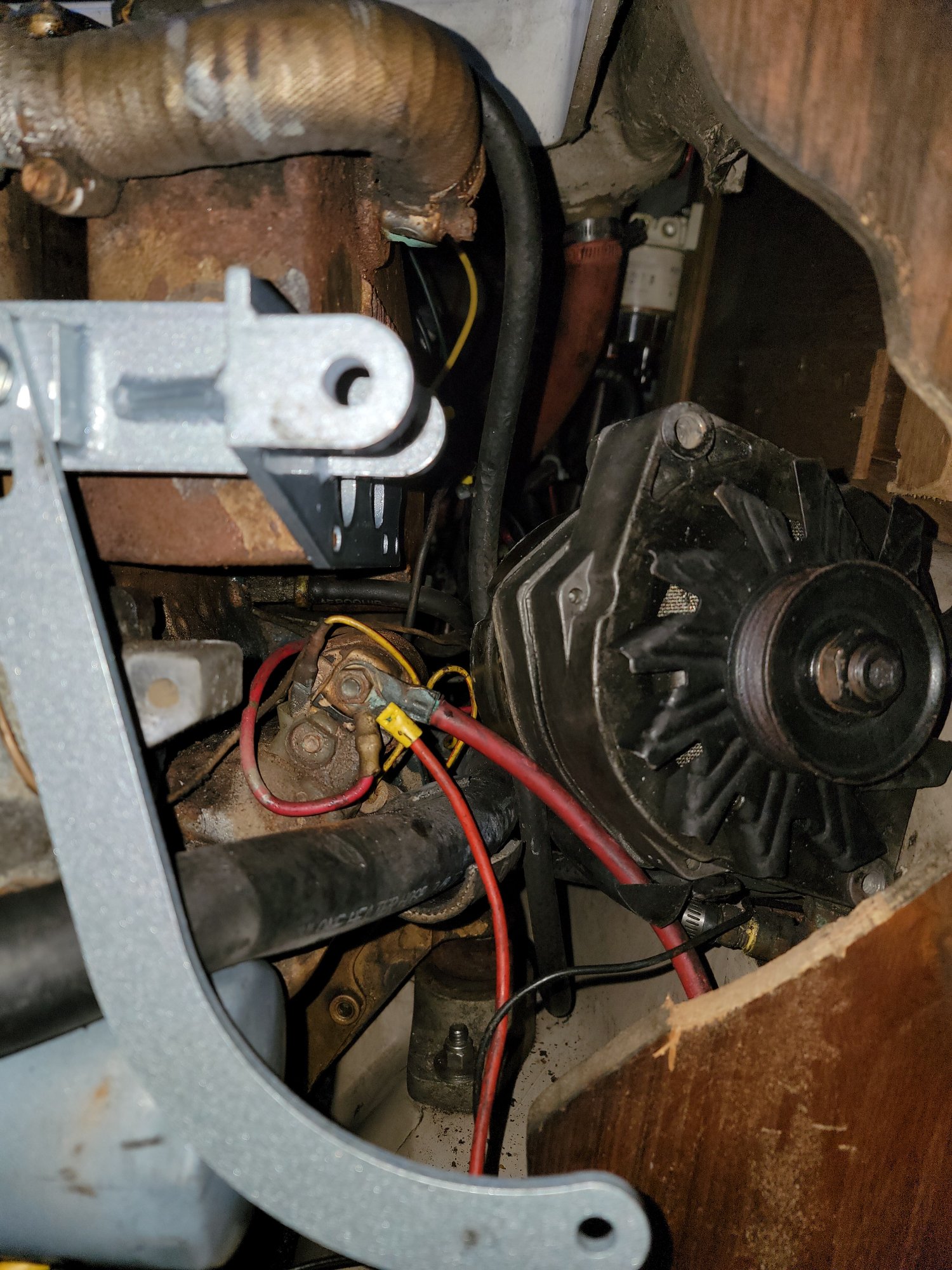

@Richard19068 curious how close your alternator got to the starter solenoid and whether you had to make any adaptations. Was it close? Mine is touching! I dont know if my alternator was upgraded but looking at the space available feels you'd need a very shallow one..

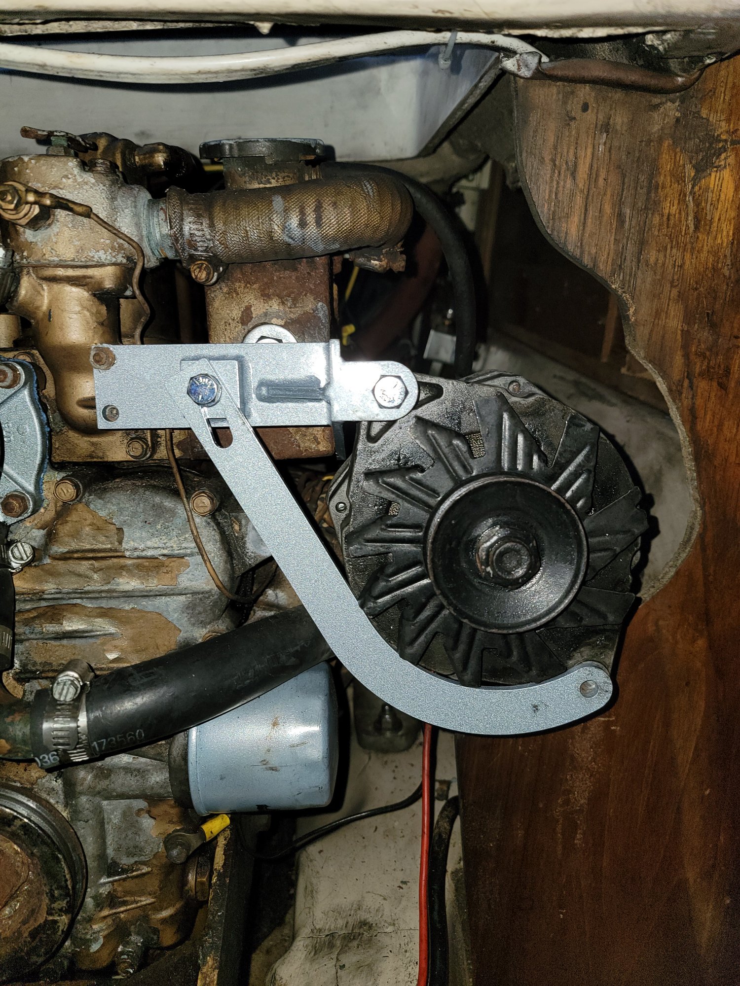

bellow, ive just offered these up- cant bolt it - its resting on the starter solanoid contacts! (dont worry, powers disconnected!)
From what i can tell i have 4 options:
1. somehow wrangle the solanoid electrical contacts to left away from the alternator, perhaps reducing the number on the solanoid with the aim of moving the danger from the alternator. Shield the contacts with some insulator that can take a bit of heat
2. somehow fabricate a longer or an extension to the tension arm (really, why did i pay CAD$1k for this thing that does not work?)
3. replace the alternator with something that will fit (no idea how i guarantee this)
4. give up, use the old bracket. Its lasted 38 years
Perhaps there are more?

My setup is a bit different than yours but my alternator is still too close to the starter.
I need to modify the adjustment arm/bracket but it works so it's one of the things I haven't gotten around to.

Wrong alt for that engine.. the rear screen enclosure will vontact the solenoid and create a dead short.. those engines use a Motorola frame alt not a Delco.. we have seen two crackedM-18 timing gear housings and it resulted in both engines being replaced as parts to fix them were not available..

Thanks, yeah feared it was a case of wrong alt. This boat is like one of those loose yarn threads you pull from a sweater.
I would say though, that with the upgraded bracket a cracked timing gear case is no longer a concern (as it isn't using that weak ear any more) so wondering if adapted brackets are preferable to replacing the alt
