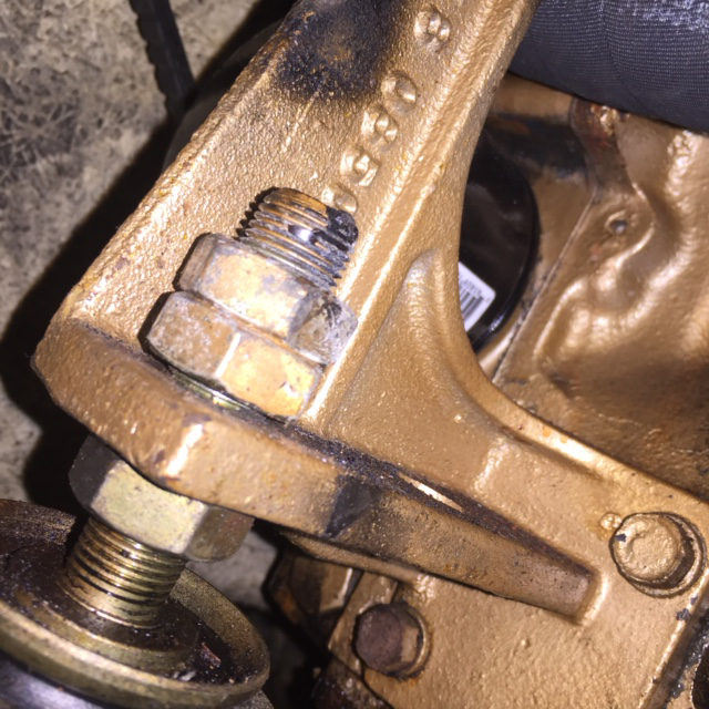

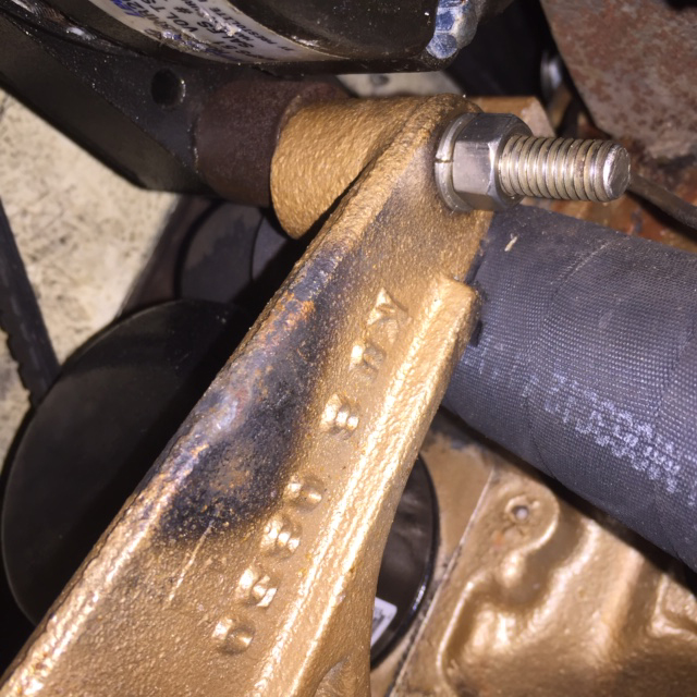

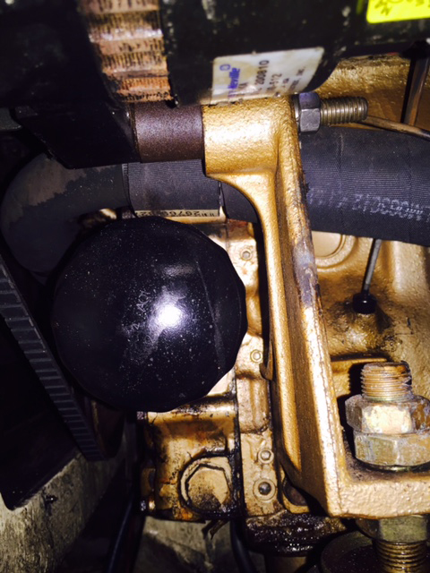

You asked for photos and I have them. This appears to be a stock mounting bracket. Please note that it has the engine model number on it KU8 0850 This is not homemade, not with that number on it and you can see it was not welded, it is part of the motor mount. This is the original engine and I have never seen a bracket like this one. Anyone have any ideas because I really need a top tension bracket. Also, I know the line of thinking is I should just change out to the new bracket but seeing how sturdy this bracket looks do you still feel that way. Also I am not sure I would not have to cut the lower bracket away to have room for the new bracket. Thoughts?

jwh, I've never seen that ever before, even on many other boating forums.
For your top bracket, you could try this:
http://c34.org/bbs/index.php/topic,7398.0.html
So you can understand my confusion, and it is a solid bracket that is not going anywhere. It looks factory which leads to the question why did they stop using them. I think I am going to take the upper arm to a machine shop. Then if I continue to have issues cut the old one and install the new one. 'Thanks for your time.
