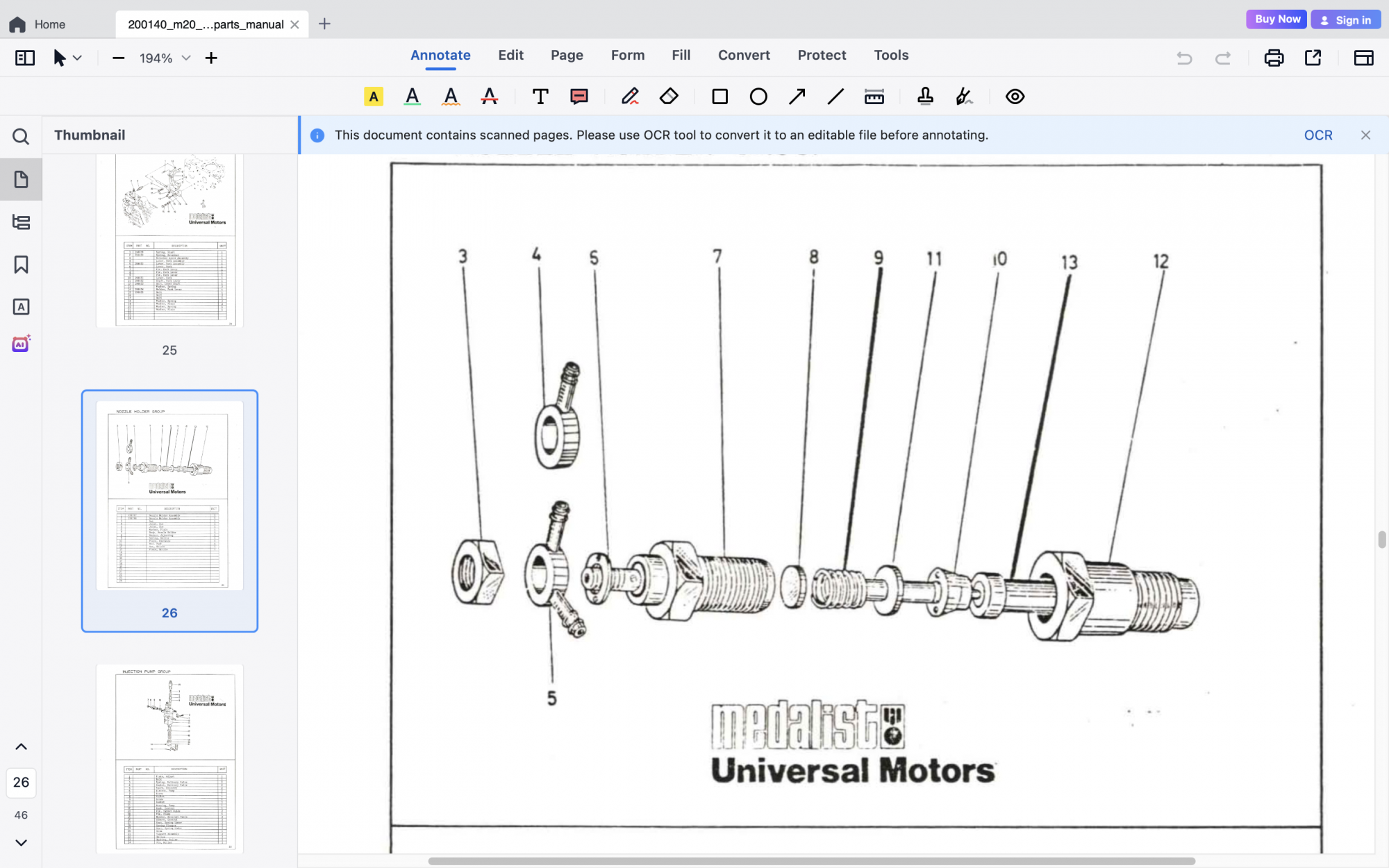

If I remember correctly (mine is a 5416, which has two cylinders), each injector needs a crush washer to go in first before screwing in the injector (make sure you get the old one out). As mine has flexible fuel lines, the two banjo fittings (one with single nipple and one with double nipple) had copper washer seal for one side. Refer to picture below, please.

If I remember correctly (mine is a 5416, which has two cylinders), each injector needs a crush washer to go in first before screwing in the injector (make sure you get the old one out). As mine has flexible fuel lines, the two banjo fittings (one with single nipple and one with double nipple) had copper washer seal for one side. Refer to picture below, please.View attachment 233206
I was out of town and just now catching up on messages. Appreciate the reply very much - the diagram answers my question. Westerbeke located a manifold and I have a mechanic who can put it in next week.
