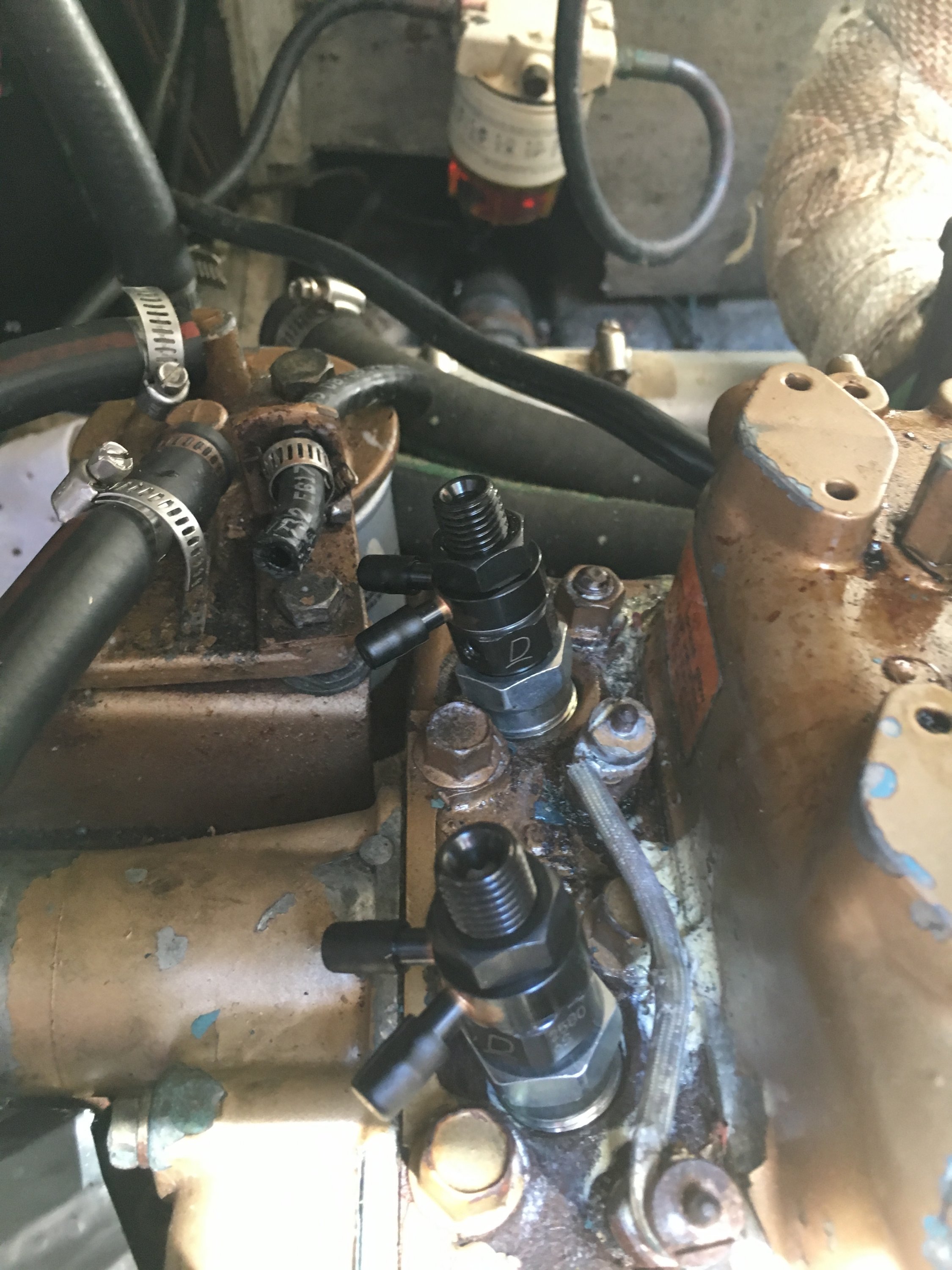

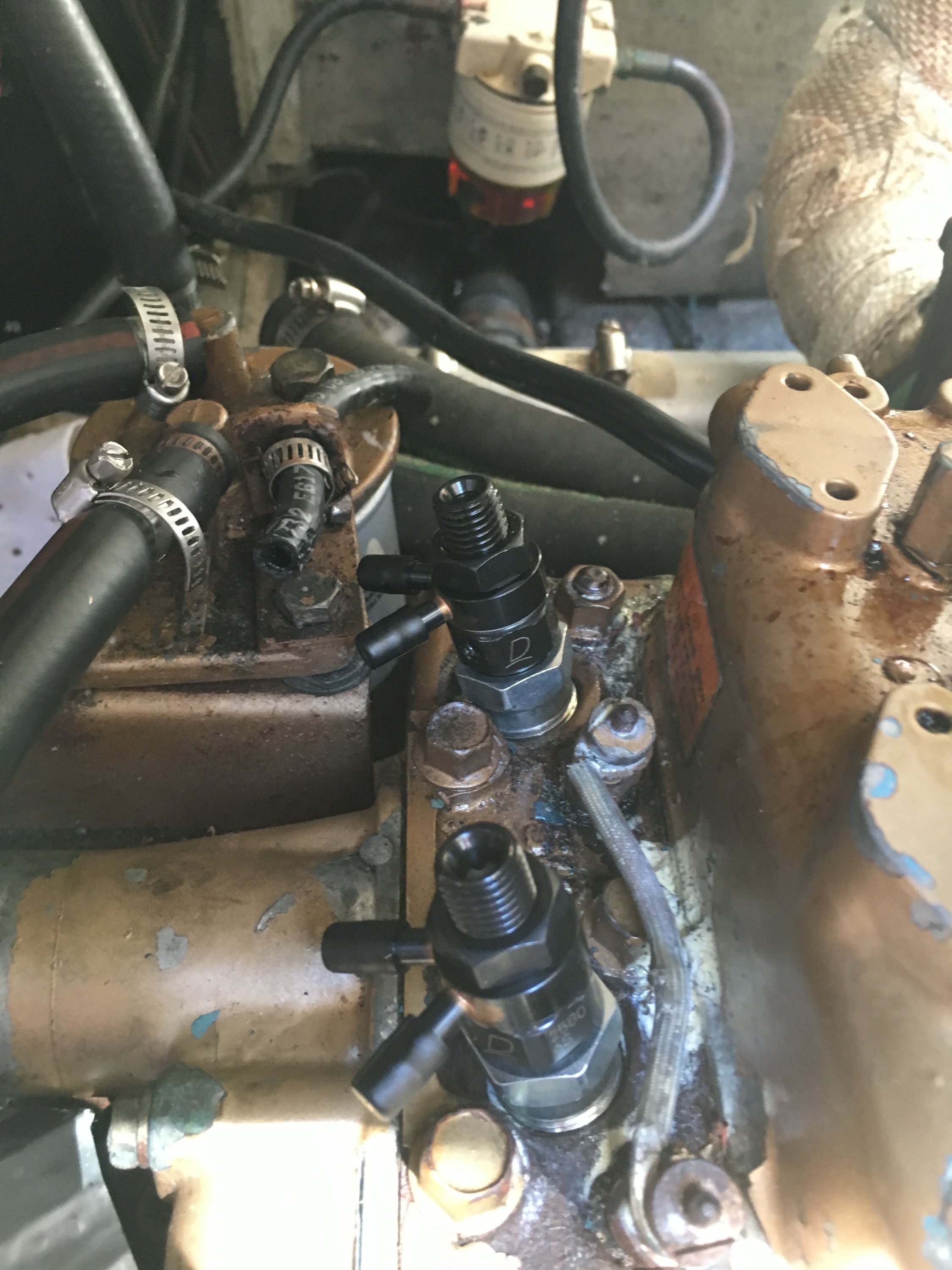

Hey all. I know you weren't sleeping on this...my new Kubota injectors are now in place and job was pretty straightforward. Quick question - I've read that I would need to bleed fuel system after this work - but manual says M-12 is self bleeding and is sans bleeding instructions. Thanks in advance. T.
Feb 8, 2014
1,300
Columbia 36 Muskegon
Don't believe it. Turn off the water intake, leave the injector pipes a little loose at the nozzles, and crank until fuel squirts out with no bubbles. Tighten the pipes back up and she should start right up. Don't forget to open the water intake again.
Feb 8, 2014
1,300
Extended cranking with the water on can flood the muffler and get water into the cylinders. If it starts right away there's no risk, but you don't know until you try it.
Unless yours has the electric lift pump. (My 5411 doesn't). If its electric just turn it on till the fuel flows out. No need to crank, no risk of flooding.
