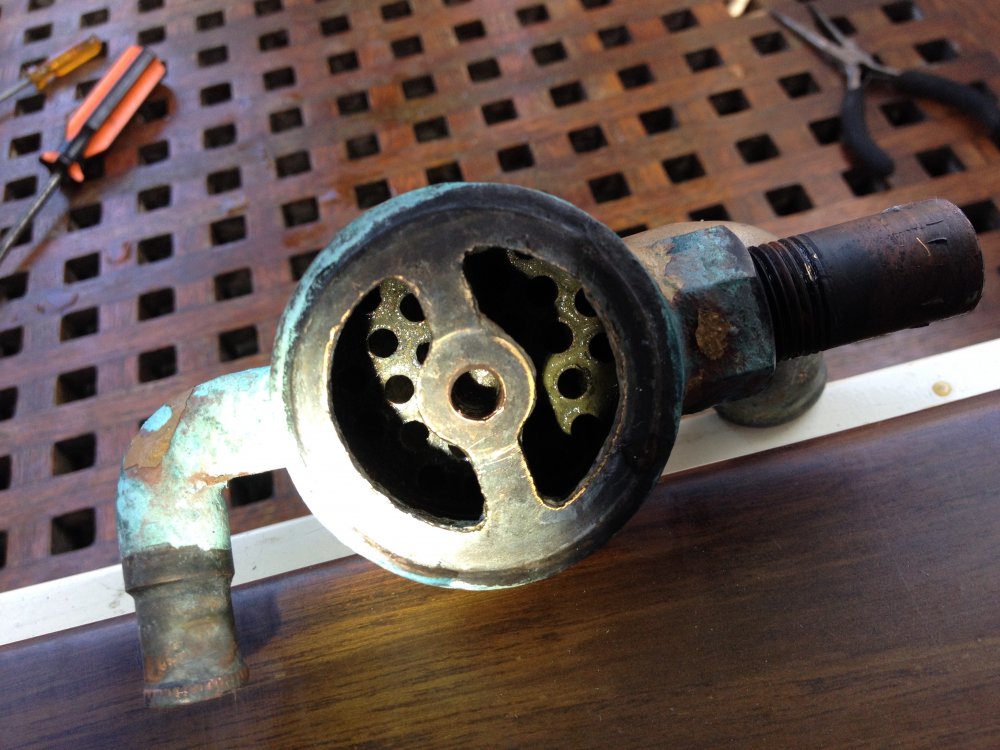

The elbow was new in July 2011.
About 350 engine hours ago.
Still looks new outside (pic taken just now), but I had opened up the side cap and hello it's stuffed with salt and junk.
I'll have it off shortly and scrape out, or replace. $180 at Toad.
2 hoses and the input pipe. Shouldn't kill me. Uh huh.

So any thoughts on why the elbow clogged in just 7 years? From the anecdotes I've seen that wouldn't be too bad for a Yanmar, but the Universal design seems to be more resilient. Much time idling?

Nope. But generally run at 2200 rpm which is on the low end of rec cruise range. I like getting .3 gph. And that's 5.5 knots.
Might have to up it, depending on how big a pain fixing it will be :)

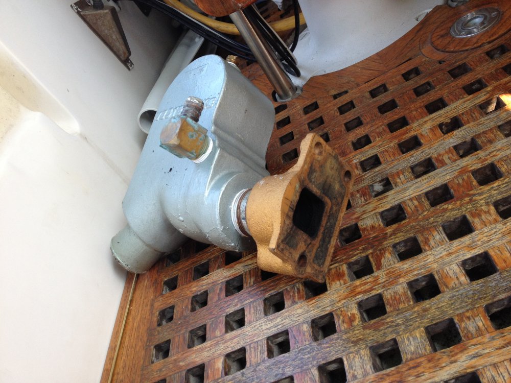

Well that wasn't it.
I was wrong.

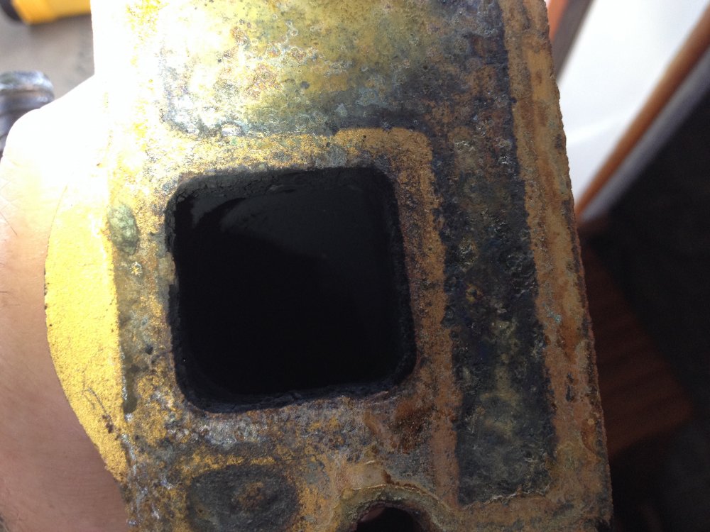

Took off elbow. Clear. Ran water through the jacket and the exhaust path. Jets. No obstruction. Turned water up, no backup. Free flow.
Pic shows thin black layer that's it.
Cleaned air filter. Was saturated with oil from breather. But would a diesel heat up like it did with clogged air? Maybe the bogging but heat? Gas yeah but diesel....
Also checked HX. Clear. Full water flow through both sides. There's nothing wrong with the cooling system or exhaust.
Took out 3 quarts of coolant to rem elbow and flange. Rated capacity.
Fresh water pump is 3 years old.
Raw side great raw flow out the back.
Spun the prop shaft on neutral. Free.
Just had bottom and prop cleaned, so am eager to test. 1 week for gasket delivery.
I busted the flange gasket so can't run it till my order comes in. BTW that gasket breaks when you remove /replace the flange. Luckily I hadn't put coolant back in yet. Just enough left in the rear of the manifold to show me the leak when I put flange/elbow back on.

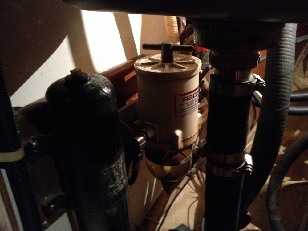

Your problem is fuel. Your engine isn't getting it but you want to think it has something to do with the cooling system.
Oct 9, 2008
1,742
Bristol 29.9 Dana Point
Racor clear. Just light Chablis in there. Filter recent. Took hose off just before secondary spin on, hose shot fuel into the coffee can when lift pump on. Secondary has always been new-clean when I changed it.
