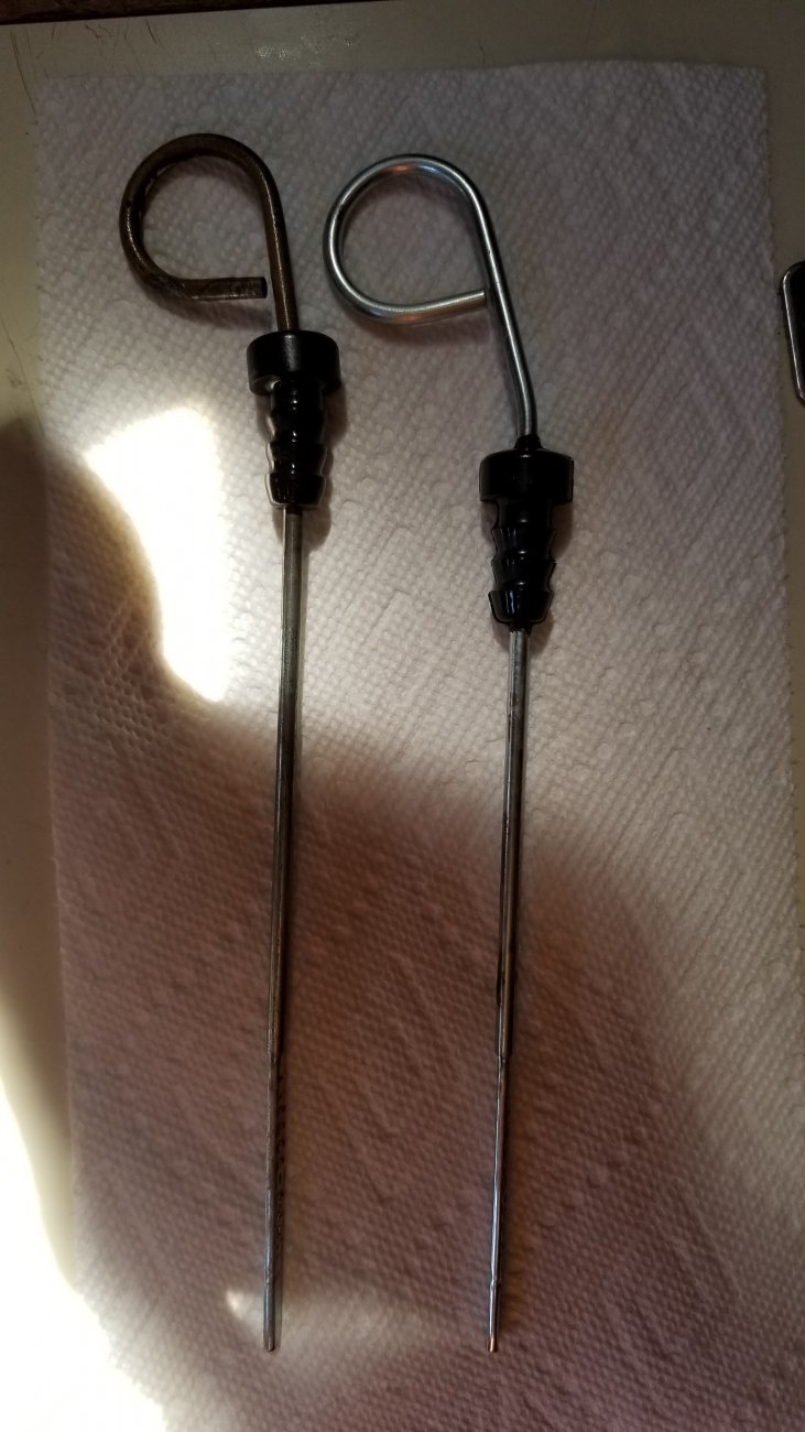

I recently ordered a new dipstick for our Universal M50. When comparing the new to the old I first thought I had been sent the wrong part, but closer inspection revealed that the rubber seal at the top of the old dipstick had moved from it's original location, giving a false oil level reading. If you own a Universal Diesel, you may want to check yours!

I recently ordered a new dipstick for our Universal M50. When comparing the new to the old I first thought I had been sent the wrong part, but closer inspection revealed that the rubber seal at the top of the old dipstick had moved from it's original location, giving a false oil level reading. If you own a Universal Diesel, you may want to check yours!View attachment 166852

Wow, nice catch.
I bought my C30 last year (Universal 5411). Oil level was a tad high, apparently about as much as your old seal moved.
I changed the oil and filter in the fall, replacing the exact specified amount of oil. After the change, the oil read the exact same "tad" high.
I have read other places to fill this engine using the dipstick and not the specifications because the specifications might be a little too much.
I wonder if your nugget is the reason for the discrepancies noted above.
